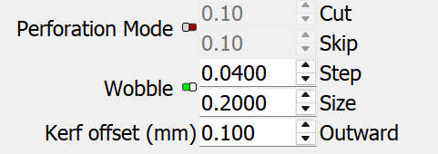

I’ve got better results when I decreased the Wobble Step to 0.04 and increased the Wobble Size to 0.2. This will create a bigger gap for the beam to get in there.
You can compensate for the larger beam thickness with a Kerf Offset.
Also, set your focus halfway into the material.
Feel free to share the settings you used and show us the results.
