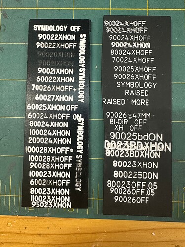

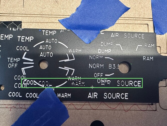

Take a look at the text in the green box. The actual string that was engraved was “ COOL COOL WARM AIR SOURCE” . Sorry about the other text but I was running out of room to test this. As you can see it is nicely engrave at the first COOL and the ends of SOURCE, but fades in the middle. Monport K40 CO2 laser engraving a 3mm sheet of white (painted back 2 layers) acrylic at 900mm/sec and 26% power (via the software) 1 pass, 1% overscan, bi-directional OFF, Crosshatch OFF. Alignment is good, belt tensions also good. No head unit play.
Why would it weaken in the middle? Thx
The response time for laser power supplies is somewhere around over 1 ms, which may be the 10% to 90% rise and fall time. The specs are very vague and perhaps aspirational for actual hardware.
A laser head moving at 900 mm/s travels across a 1 mm vertical bar in 1.1 ms, so the laser tube will not reach full power before it must shut down again. If the maximum power is 26%, the tube will lase at a very low power for most of that millisecond.
The tube’s response time depends on its temperature, the state of the gas due to lasing in the previous few milliseconds, and probably the phase of the moon. Because those thin features require beyond edge-of-the-spec response times, the results will vary across the length = duration of a single scan line.
You must reduce the scanning speed to something around 200 mm/s so the tube has time to accurately / dependably reach the programmed power level for very thin features.
Reducing the power by a corresponding factor of five-ish may not be possible, as CO₂ glass-tube lasers tend to not fire reliably below about 10%, again depending on temperature &c, and operating at the low edge-of-spec will produce marginal results.
Which means you may need three coats of paint or a different paint or something along those lines to match up with the laser’s actual performance.

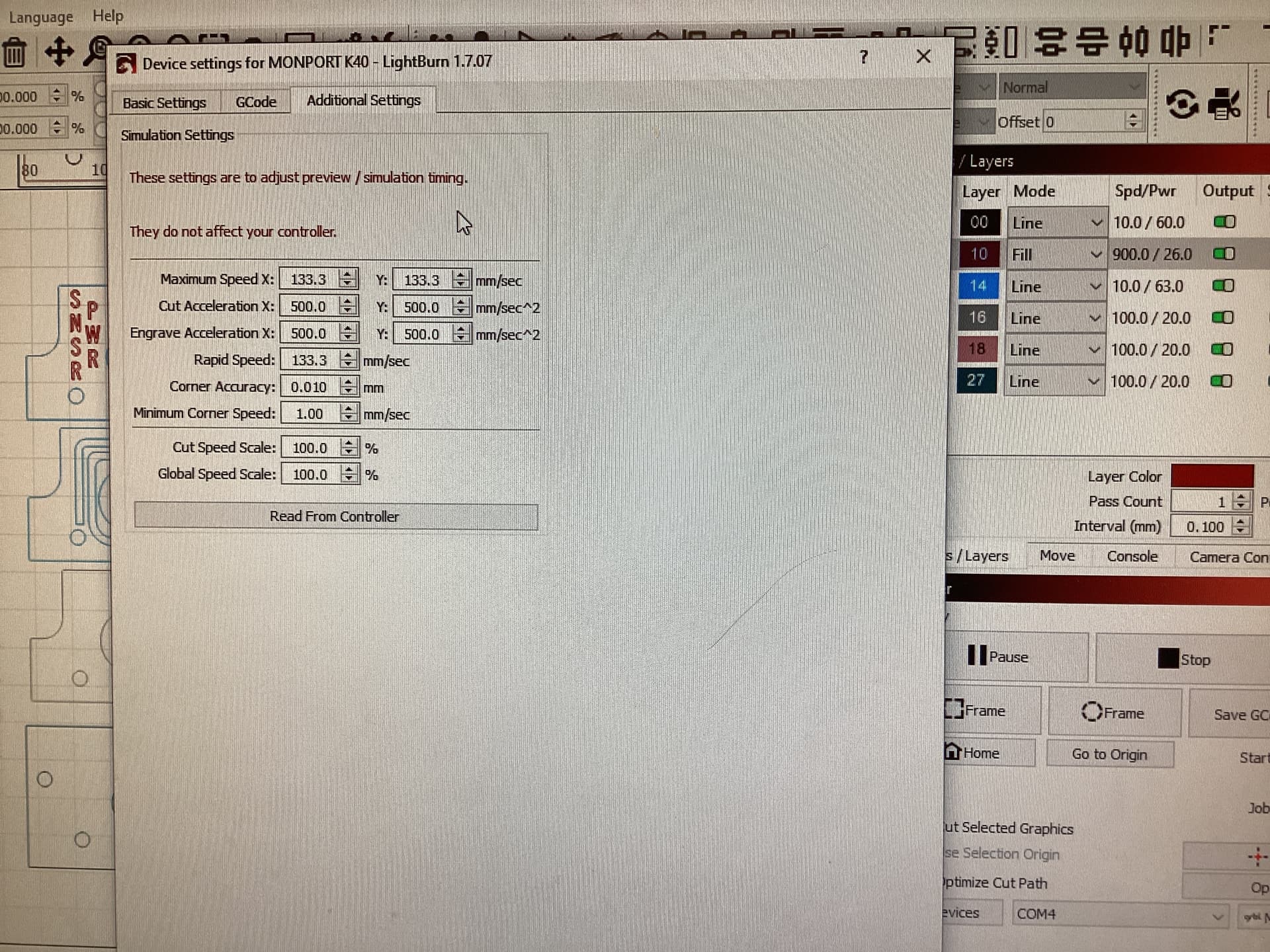

While you’re in there, what acceleration value do you have for the X and Y axes?
The text is 3.5mm tall. I’m not sure where to find the acceleration values.

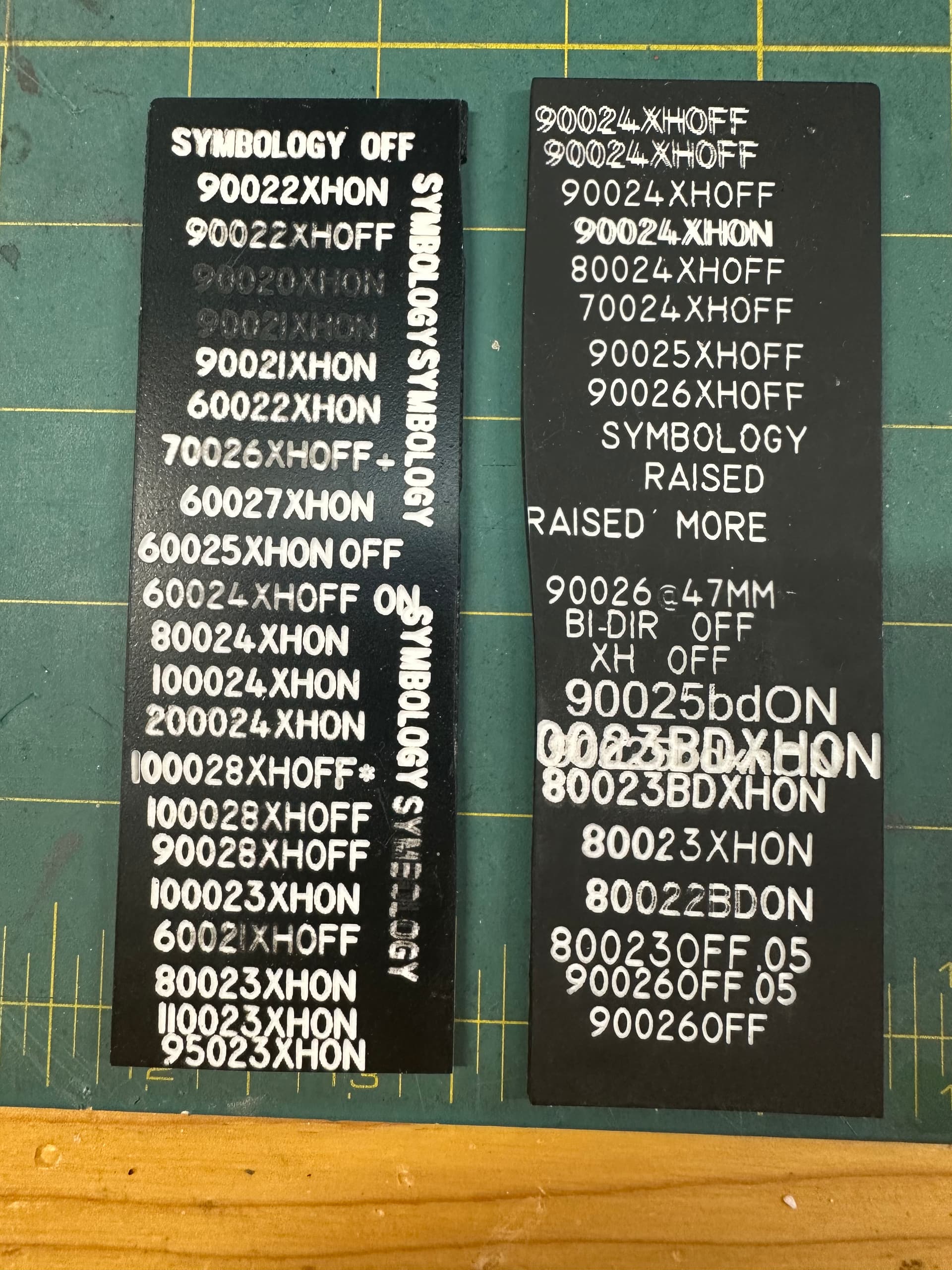

Here is a pic of the earlier speed/power/bi-D and crosshatch on or off tests. You can see that very bottom 900/26 looked best to me. Also, that one just above it - the 80022BDON seems to have this ‘weaker middle’ section a bit as well?

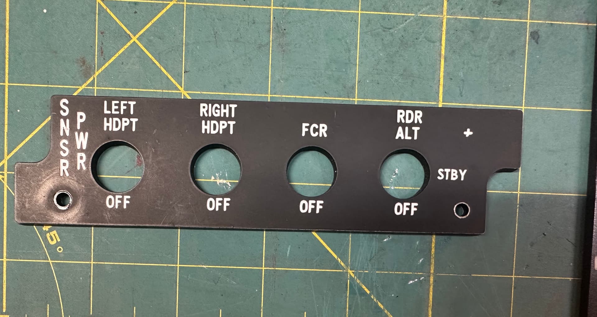

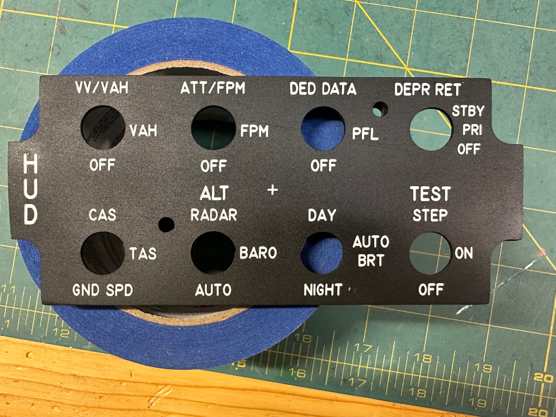

And also a pic of a panel I did awhile back. And it came out ok. Same width and approximate spacing as in the panel with the green error box…

Are these the acceleration numbers you were asking about?
They would probably work, did you click on read from controller? Sometimes it doesn’t get updated.

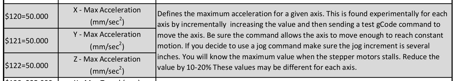

Grbl has a numeric system for it’s settings. This is old, doesn’t have $32, but most of the others are fine. Remove the .txt extension.
GRBL_Settings_Pocket_Guide_Rev_B .pdf.txt (214.4 KB)
This is from the pdf.
These seem relatively slow as printed. There is an acceleration calculator available.

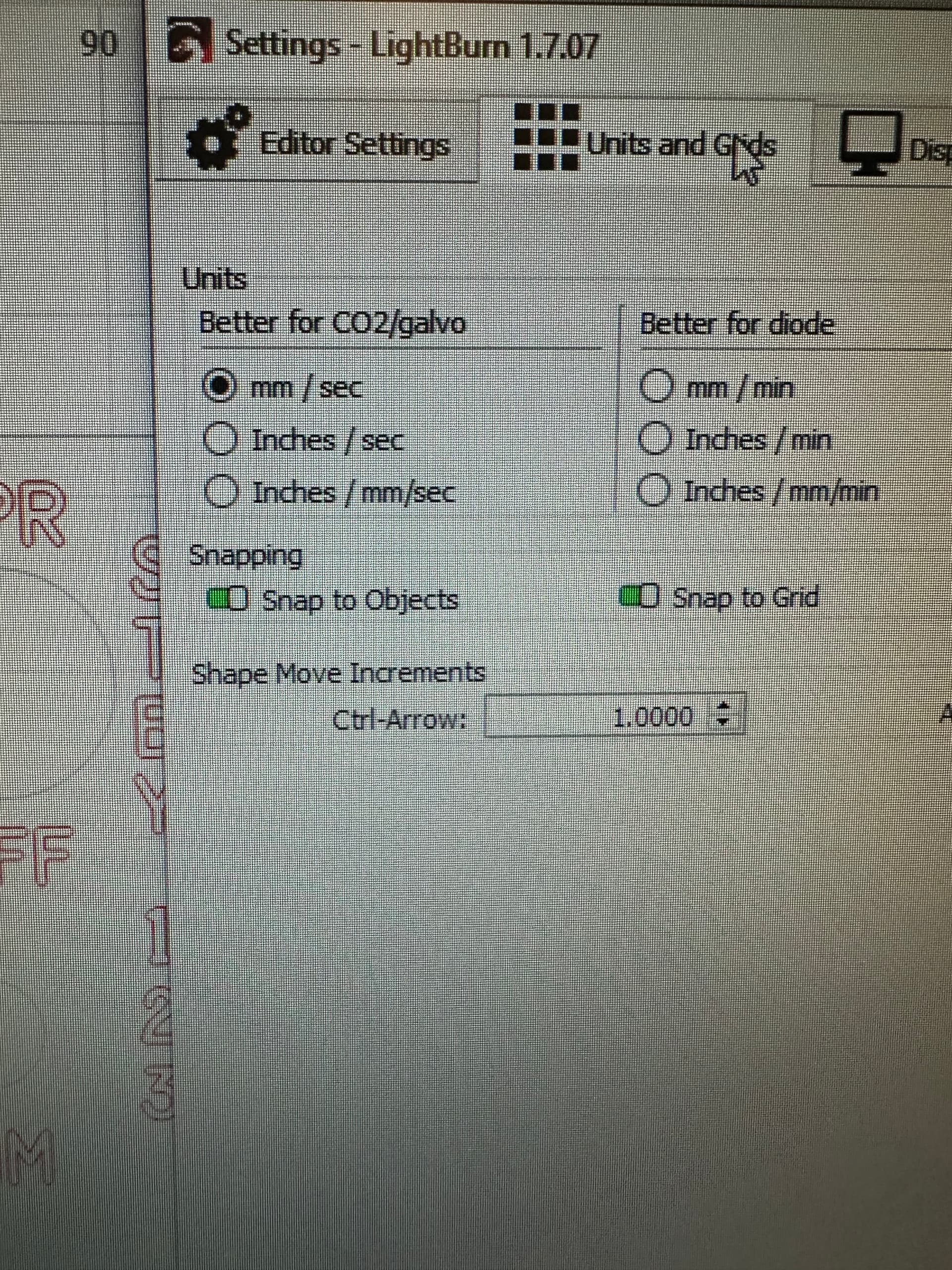

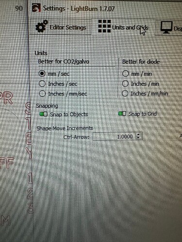

I’m still confused if you’re using mm/s or mm/m.
I clicked on Read from Controller - no change in numbers. I am in mm/sec.

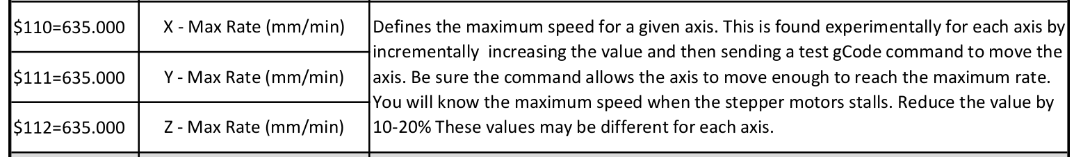

Check what values you have for
These are your maximum speeds.

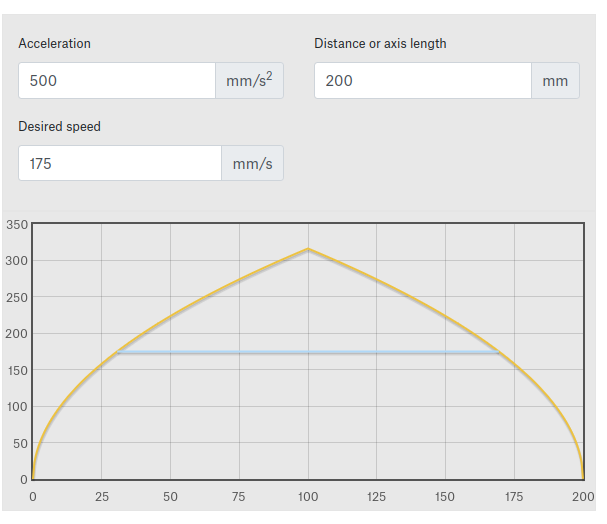

According to your information, the machine has an acceleration value of 500mm/s^2, it also implies that 500mm/s is maximum speed.
To reach 175mm/s it would take that machine about 30mm.
900mm/s is pretty fast, I doubt if these numbers are right, you would ever make it to that speed.

I was actually able to make this panel last night, but I literally had to do one word section at a time, and re-HOME and frame before each new one. Took a long time. This was at 750 and 26% and 1% overscan, x1 pass, and crosshatch and bi-directional OFF. If I try to just do the whole panel at once (which I was able to before it lost it’s mind) then I get various errors, like you saw in the original post in the green box…
And things like these distortions.

The manual and the simulation values show the laser tops out at 133 mm/s on both X and Y. You can set any layer speed you want, but the controller will not run the steppers at more than the maximum speed set in the Machine Settings.
IIRC, GRBL uses mm/min for the speeds shown in the Machine Settings, so you must convert from mm/s when comparing the numeric values.
The 500 mm/s² acceleration means it requires about 18 mm to reach 133 mm/s, which is likely much longer than 1% of the speed will produce, particularly for one-word-at-a-time scanning.
The result is it’s proceeding at a much slower pace than you think. That makes diagnosing the problems much harder, because all our assumptions are wrong.
Those are likely due to USB communication errors dropping out chunks of the commands. Using a better cable, typically one with molded-in ferrite cores, seems to improve the results. The Troubleshooting page has some suggestions:
