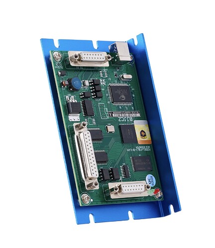

I recently built a fiber galvo setup from “scratch”. Hardware is all in place (Raycus 30W source, Cloudray RC1001-V1 scan head + PSU, lenses, frame, etc.), but I can’t get the controller board (FBLI-B-LV4) to power on.
  • The USB-B port only handles communication to the PC (EZcad), not power.

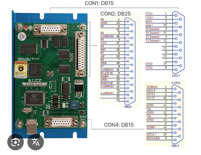

  • Vendor told me the board needs 5V fed in through the DB15 “power/IO” connector.
  • I tried splicing a USB cable (red → pin 4, black → pin 12 per the pinout) but no luck. Board still won’t light up.
  • I’m considering wiring a dedicated 5V wall charger into the DB15, but before I start cutting more wires, I wanted to see if anyone here has done this.
What’s the proper way to supply the 5V to this controller? Do people normally wire in a separate 5V PSU, or is there a standard adapter cable for the DB15?

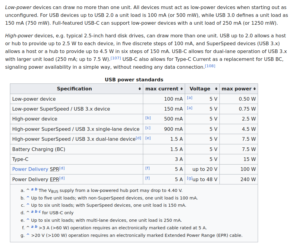

Most USB chargers or ports don’t produce enough current, so trying to get it to work with a 5V usb as a supply seems futile.

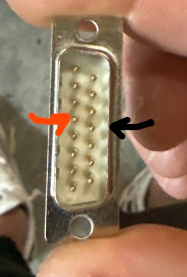

Something I’m really going to take a look at, the DB15 has 2/ 5V ins and 3 grounds, curious if they are all connected.
From what I remember about db15 pin current is limited to 1.5 - 2A… I have seen some as high as 3A.
Suspect the dual 5V pins on the connector is to prevent current/voltage loss.

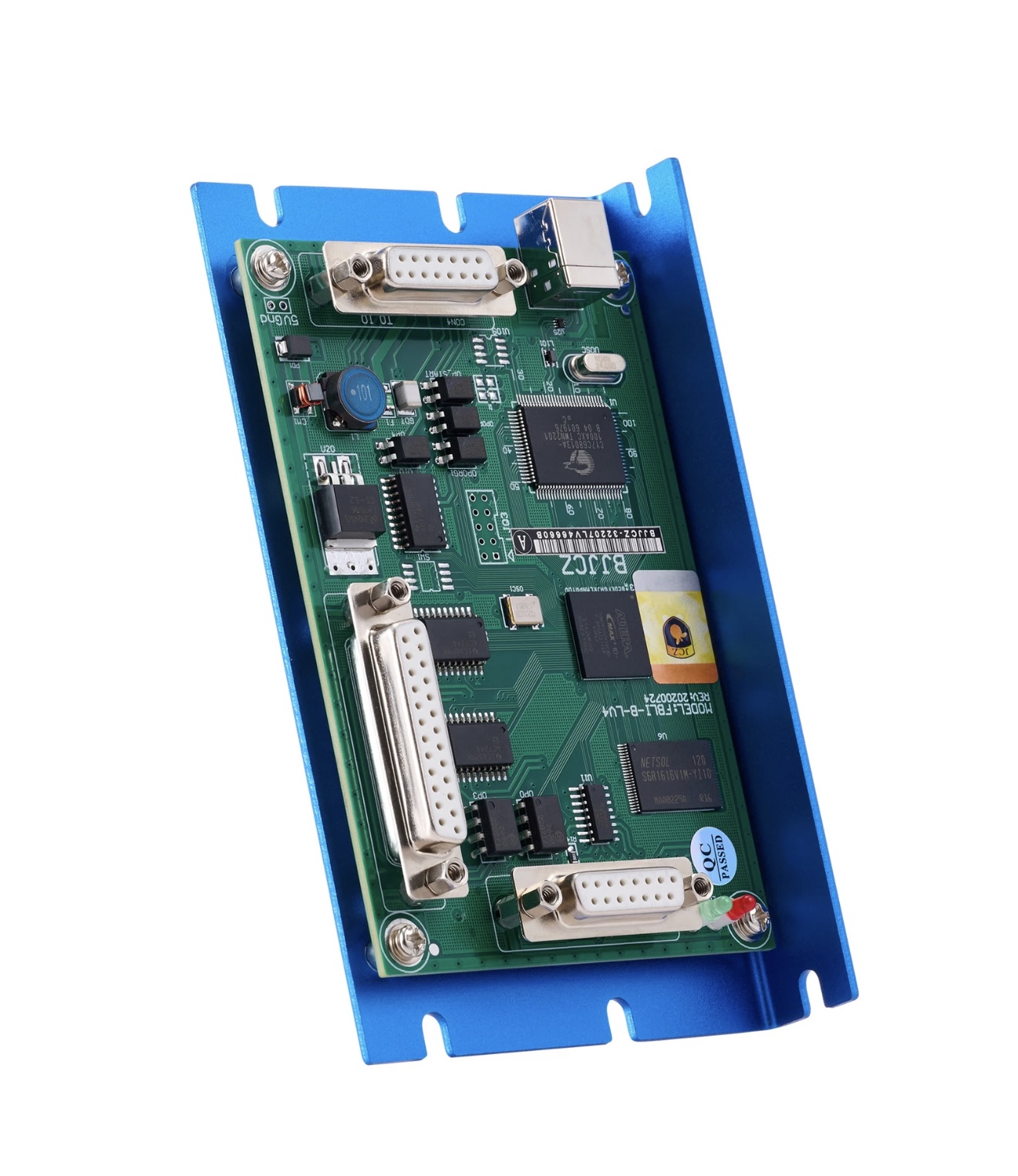

I’ve managed to get power into the board by wiring 5 V and GND directly into the through-holes. The board lights up fine, and EZCAD2 now recognizes the device, I even got the driver updated.
Here’s the issue: when I try to run the galvo, the laser doesn’t fire. Instead, the red LED on the board flashes only at the moment it should be lasing (not just constantly on). That makes me think the fire signal is reaching the board, but something downstream isn’t letting it actually emit. I assume that’s what the red LED is doing.
I’ve already ordered a dedicated 5 V PSU, but honestly, if the PC’s USB 5 V was just weak, I’d expect to see some firing, even if inconsistent, rather than nothing at all.
I may need to check the pinout of the DB25, but I find it hard to believe it’s wrong. Really starting to drive me mad!

Is it possible that you need to power both 5V in pins? Something I intend to check next time I open it up.

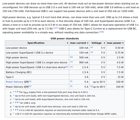

I would agree, I wouldn’t depend on a 5V supply restricted to 1.5A for a 3A feed.
If you can’t supply it with enough current to operate, it’s not going to be 5V anymore. I don’t know of any computers that will operate at all when you can’t provide them with operating current.
So, no, at 150mA or 1/20th of the required current, I wouldn’t even expect an LED to illuminate.
At least you’re optimistic. :thinking:
Most USB, especially 2.0 is restricted to pretty low power levels.

After thinking it over last night, I landed on the same idea. I’m planning to feed +5 V into pins 4 and 5, and tie the negatives from my 5 V / 3 A PSU into pins 11, 12, and 13. I am hoping this works. I appreciate you taking the time to help me.

Update for anyone who runs into the same headache:
I was able to get 5V into the board by tapping the 5V and GND pads (near the IO DB15). I tested a few ways of feeding the 5V, but the most reliable was through the DB15 connector:
  • +5V into pins 4 and 5
  • Ground into pins 11, 12, and 13
  • I also shorted pin 1 to ground just in case I needed to bypass a fault input (door, e-stop, etc.)
With that setup, I can get the laser to fire. That said, it’s still weak across all settings and not marking material yet, so there’s more debugging ahead.
