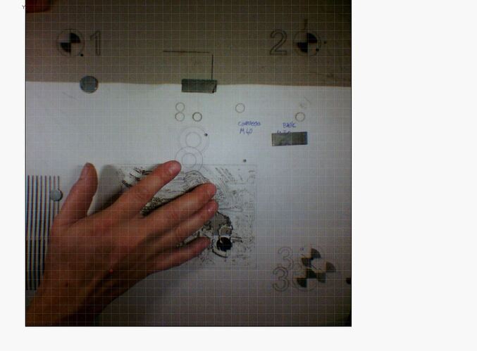

Suddenly in lightburn i see black and white
I have been using a USB video camera for months which is recognized as SMI.
I think it’s an ov 5647 that has always worked perfectly in color.
for a few weeks now I’ve only seen the preview in black and white despite the lightburn settings being in color.
using the windows tool for the webcam I see it working perfectly in color.
otherwise it is perfectly calibrated and functional but it was nice to be able to see the color work plan as it was before.
please do you have any suggestions?
I didn’t change anything, just at a certain point the color was disappeared.
today I did several tests including a new calibration and everything works except the color.
the LB cam settings in the settings menu are set to color

Thanks, it happens to me on all usb ports and the lighting is good, always been the same.
I have not tried to switch from black and white to color but in the windows utilities, on lightburn setup nothing changes, it is always in B / W
Today I will do more tests and thank you.
it doesn’t even make sense to think about changing the camera because it works in color on windows so I rule out it being faulty.
I can’t fix the black and white camera problem.
the cam works well, from windows it is in color, I am attaching a screenshot of windows.
I also attach a screenshot of lightburn where you can see the color settings and my cam which is black and white.
from windows 10 utility webcam program
from my lightburn
this glitch happened suddenly, i didn’t install anything or change my pc or other settings, just overnight i started seeing only in black and white.
obviously I tried to change usb ports and exit and re-enter lightburn changing settings but it always remains as seen in the photo.
lightburn last version 1.3.01

today I did an online test, on my win 10 all the programs that use the camera let me see it in color except Lightburn.
these are the test results, i don’t know if they can hide some clues to solve this problem.
Are you able to use Custom Camera System in Edit->Settings? Curious if that would make a difference.
changing to a custom camera system this happens: the view is distorted but it is in color.
going back to the preset camera system and saving/restart LB comes back correct in shape but not in color.
You will likely need to recalibrate lens and alignment.
thanks for the suggestion.
I set the custom camera system and redid the calibration.
seems finally fixed.
I’d like to understand why he was fine with the preset camera system for 4 months in color and then one day it suddenly went black and white.
