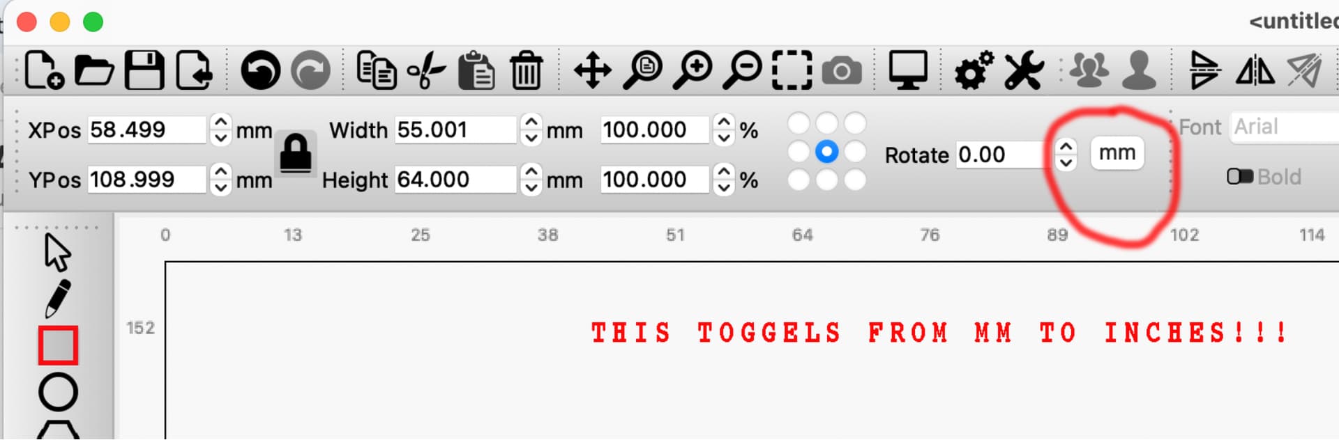

Did you try this?
The little mm button over on the right switches the displayed units between mm and inch:
LightBurn - Numeric Edits toolbar units
Close enough? :grin:
Bonus: You can specify the numeric value units if you want to nudge something over by a fraction of an inch when you’re in metric.

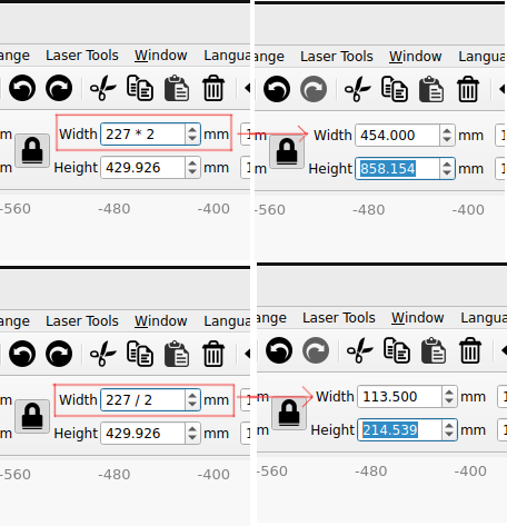

Double bonus: Equations!
If you take inches and want to convert to Milometers just multiply by 25.4, to convert the other way you divide by 25.4.

Some fields in Lightburn will allow the computations in the field – this is simply multiplying and dividing by 2.

Or even overriding the field units. In a 250mm field, you can enter 10.5" and it will respond with the equivalent 266.700mm. I often use 11.95" to set the T1 boundary for my 12"x12" Baltic plywood.
Hi, I know how to measure, but I want to change the units of measurement from mm to inches to mils etc.
Hi, Thanks! That is exactly what I was looking for!

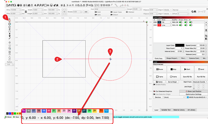

I’d just like to be able to measure from point A to point B without creating an extra “feature” todo it.
The Measure tool does that:
In addition to what @ednisley offers, you can use the ‘Draw Lines’ (Pen) tool to measure from point A to B. Click at the start (point A), then drag to point B and look at the bottom information section for the distance. :slight_smile:
