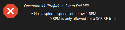

Hi George, thankyou for your report. I’m just looking at an internal nightly version, and it seems work has already be done on this (so it’s coming), instead of the preview you will now see an error similar to this:
