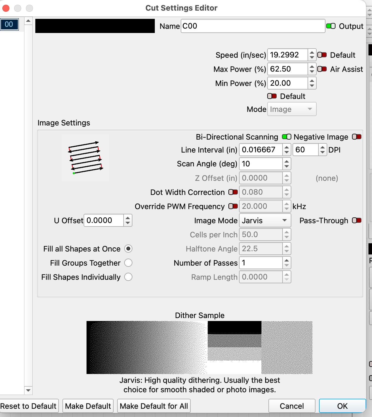

Suggestions for getter quality PNG output?
I’ve tried a half dozen combinations, but my ignorance is showing.

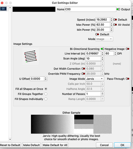

Engraving with a Bosslaser on hardwood. Here are the settings I used for the best output I’ve seen, but I’m guessing there are ways to make it feel more real.
Thanks!
(the PNG has a transparent background, but was too big to upload here. here’s a screenshot)

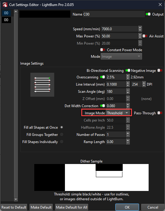

Because it looks like a two-tone linocut, the ‘Threshold’ image mode might work well, for example, try settings like this;
