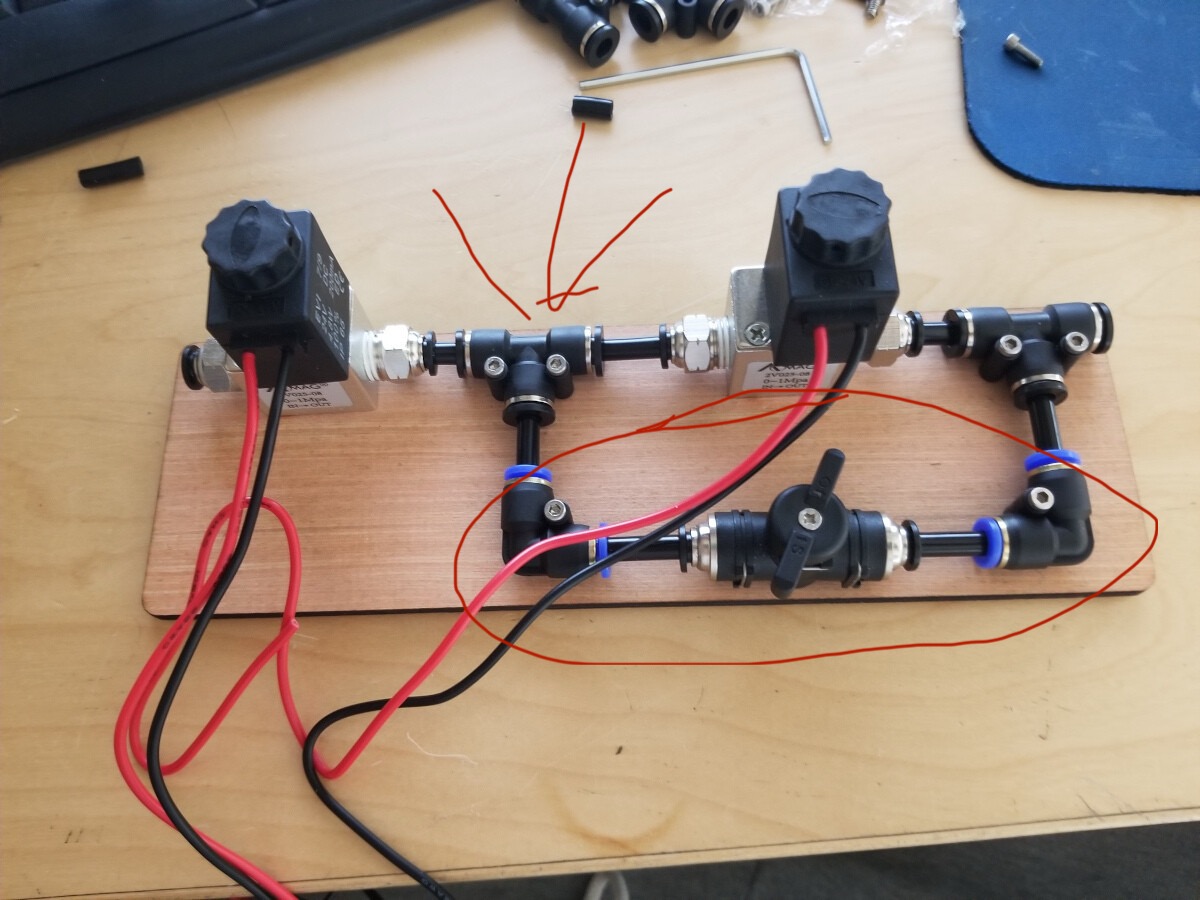

Another thing I’m curious about is air assist, I have the stock pump but I was going to upgrade to dual air assist but is getting a larger compressor worth it? I suppose I could use the stock one for my engraving assist and use the newer larger one for everything else?
I have installed the advanced air assist as many people refer to it.
I have an external compressor, so I have twin solenoids that switch the air for me.
The left, allows regulated (at about 50lbs) air into the system anytime the machine is operating, using the Status sink.
The right one is wired to Wind – the Wind terminal goes low when the Ruida is executing a layer and the layer has air assist enabled via Lightburn on that layer.
You do need a snub diode anytime you are switching a coil.
Make sense?
I’m not gonna say I completely understand but I do understand enough to get started and I’ll tag in my friend at work to help fill in the gaps haha are all Ruida controllers essentially the same?
Also is the part I circled only do that pressure can’t build up in between the solenoids? And then the valve in to regulate pressure from the relief path?
Air is let in on the left solenoid when Status is active, it is blocked by the right solenoid. The only way around the off solenoid is via the flow restriction. This allows low pressure air to reach the nozzle anytime Status is active, machine is executing code.
When I select Air assist within a Lightburn layer and the Ruida is executing that layer, the Wind terminal goes active (low), opening the right hand solenoid, that bypasses the restriction allowing full pressure air to reach the head.
The outputs are open collector, so one wire from the solenoids are wired to 24V, then the other wire to the Ruida. When that output become active, it complete the ground to the solenoids.
Make sense?
You have to use snub diodes across any coil you’re switching. I use 1N914 small signal diodes, but about any diode will work.
This is why you need them.
It does! Thank you for the help🤗
