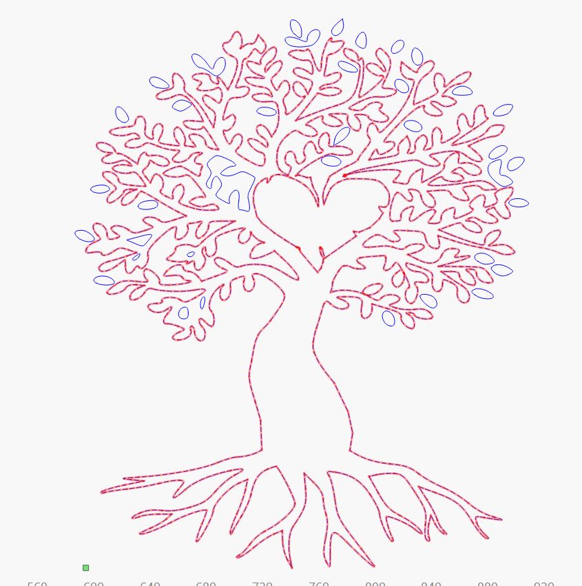

  1. Select all the tree shapes
  2. Break Apart

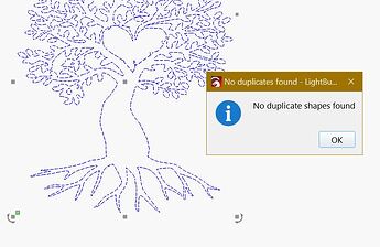

  3. Delete Duplicates
  4. Auto-Join Selected shapes
  5. Set the tree Cut/Layer to Line
  6. With the Trim-Shapes tool check if your shape is a continuous line and remove “problematic” zones

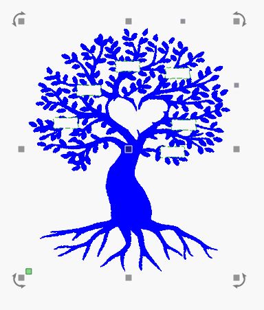

  2. Group all the tree shapes and set Layer to Fill.

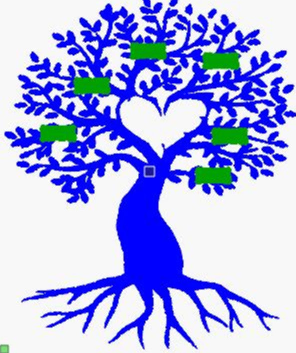

  3. Super Pro TIP: To make it easier to select the shapes later set the frame shape C00 to Fill and move the layer to the end of the Cut/Layers list. (yes! Cut shapes can be Filled Shapes)
  4. Duplicate the Frame Shape each time you place and distribute on the tree
  5. Select all the Frame Shapes duplicate them set to C11 and set fill to check if you didn´t missed one. Then hide C11.

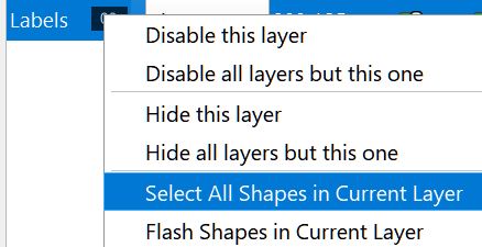

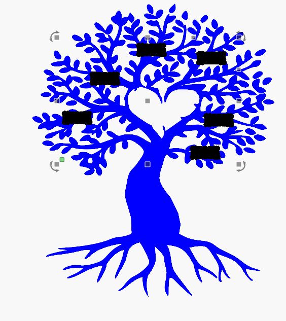

12. Do select tree Ctrl + Click first frame shape then Cut-Shapes tool to each one.
  1. Unhide and select all C11 shapes, Ctrl + Click the tree and group.
  2. Select C11 to line.
  3. Finished.
