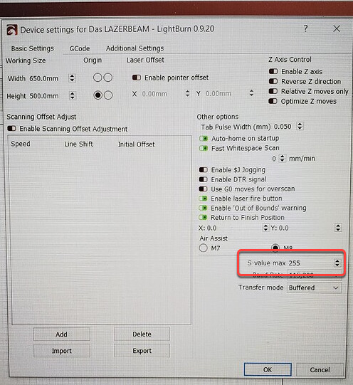

Super Slow, dont know what i did wrong
changed 30 back to 1000. stil not burning
You need to also have the ‘S-value max’ match your $30 setting.
