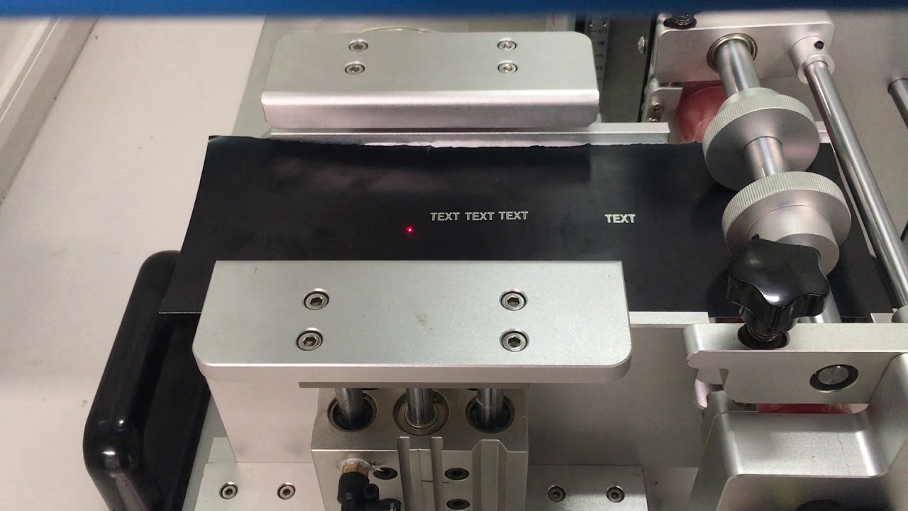

I’m using EZCAD, but want to switch to Lightburn.
My machine is from factory equipped with a automatic infeed module.
Is the Handling of IO Ports Implemented?
The process in EZCAD to mark is as follows:
Input 1= Clamp Sensor (From Lo–Hi or from Hi–Lo)
Input 2= Currently I don’t use it, but it is a sensor if material is in position
Output 1 = Solenoid Clamp up
Output 2 = Solenoid Clamp Down
Move Distance (Would be cool to use the automatic mark dimensiondetection of Lightburn for the distance to move)
Similar kind of machine/process (not mine)

Very interesting setup indeed! Unfortunately, this is not currently supported by LightBurn.
LightBurn provides a site for users to vote for new features. You can search to see if this has been requested, and vote it up, or add it so others can vote their support as well. This helps us to prioritize which features to direct development time toward.
