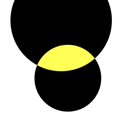

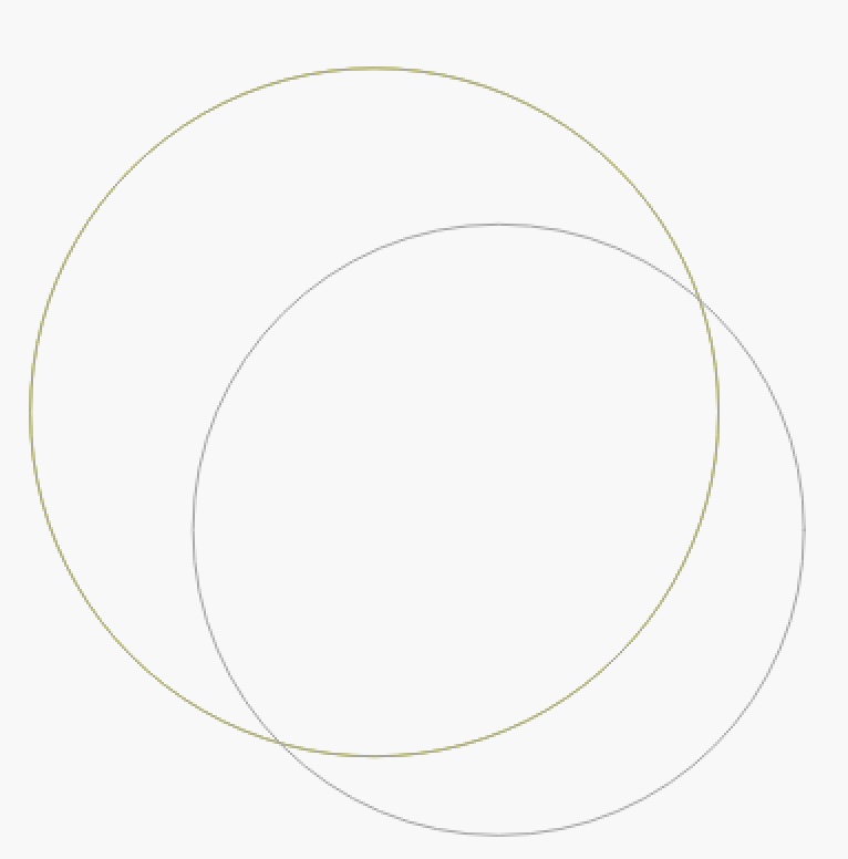

Thanks for the reply, I’ll send what it looks like in an SVG viewer vs a similar location in LightBurn:
the intersection is completely missing when imported into LightBurn.

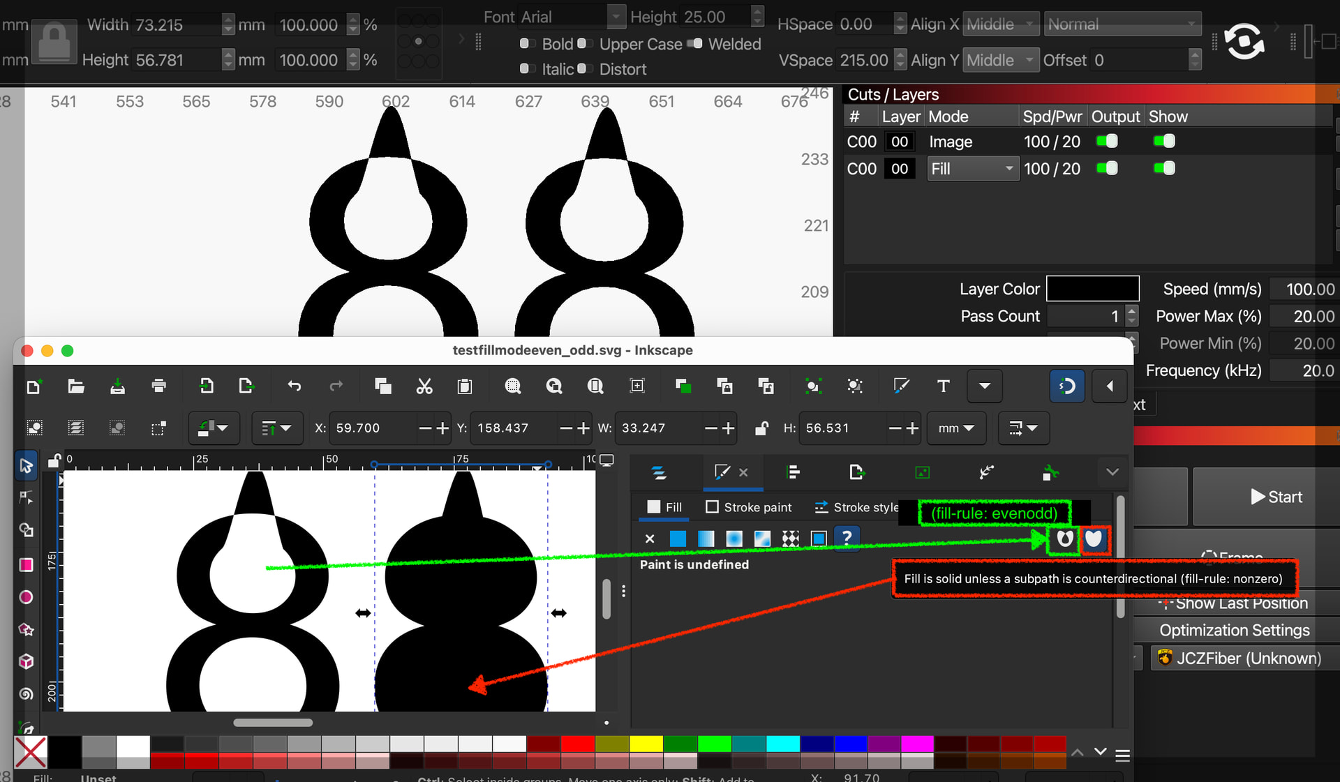

LightBurn uses the “even odd” fill rule, so holes or unfilled areas are determined based purely on the position of the paths (not the direction) and whether any are nested within other paths, intersect with other paths, or even self-intersect;
Even if I explicitly set the winding so the inside paths of this compound figure eight shape to match the same clockwise direction as the outside paths as you can see from this inscape render using the “non zero” fill rule, the paths will still import to LightBurn using the even odd method (path direction ignored for the fill).
