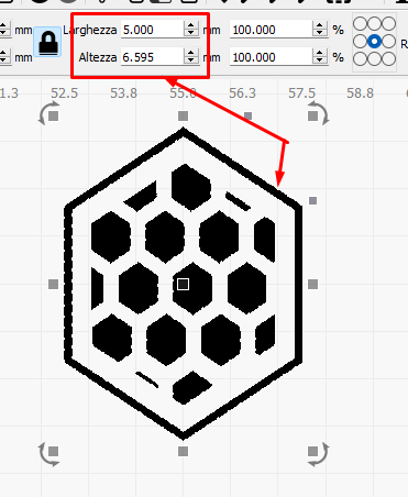

Hi guys, I’m new to the laser world. Let me start by saying that I only work on steel, and I make half a millimeter deep engravings, and they are often miniatures, the files I use are SVG, but I notice that in very small spaces sometimes the details vanish. I would like to increase the precision and have more accurate details.
My laser is a 100w jpt mopa fiber. Which setting needs to be adjusted to get more details? .

hi thank you so much for your help always :). I’ll send you the .lbrn2 file directly, so maybe I can understand better with the measurements you asked for, writing them would be a little difficult :). Obviously I would like to keep all the details, but I tried to engrave but with little success, many details are lost
esagoni.lbrn2 (46,3 KB)
That’s TINY!
Can you post - if you can - a image of the engrave results?
Thank you for your answer . I put the settings and engraving (steel) under the images, as you can see there are points that should have empty space, but it doesn’t remain, I thought I could still improve the quality in the miniature engravings, unfortunately the things I have to envy are in very large spaces very small . Thanks again for your concern

What is the diameter of your beam? Your image only has about 0.005" spacing.
I don’t know what the diameter of my spoke is. Could you send some photos of what the beam setting is? so I can give you a confirmation? Thank you
Today I did some tests, and the best setting is the one I show below in the photos. I also send photos of the engraving. If you think it’s still possible to improve, write it and I’ll do more tests. Thanks to everyone and have a good day
