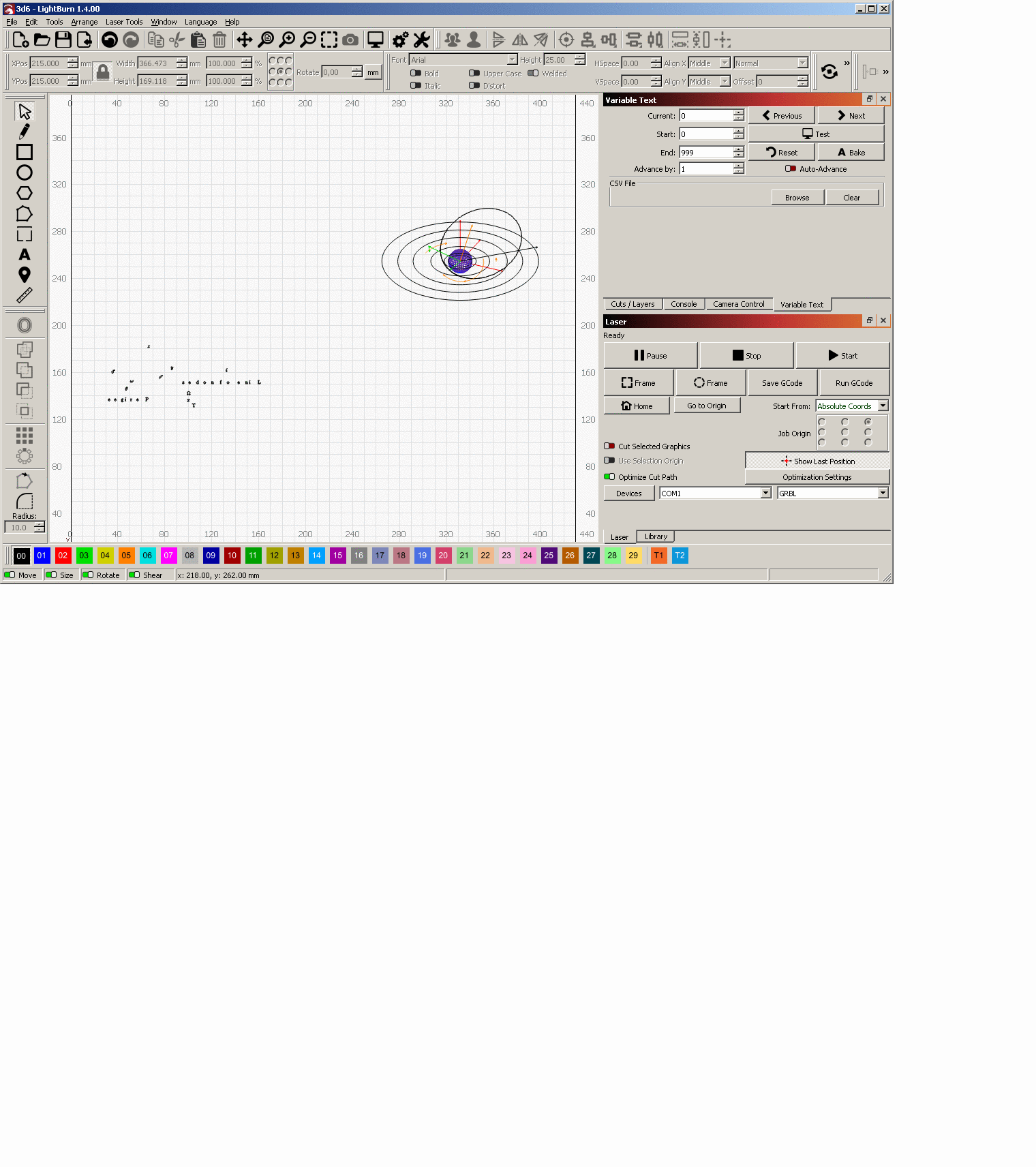

SVG import deffect
The SVG file is imported wrongly. The text is located on another place that should be.
3d6.svg.txt (545.3 KB)

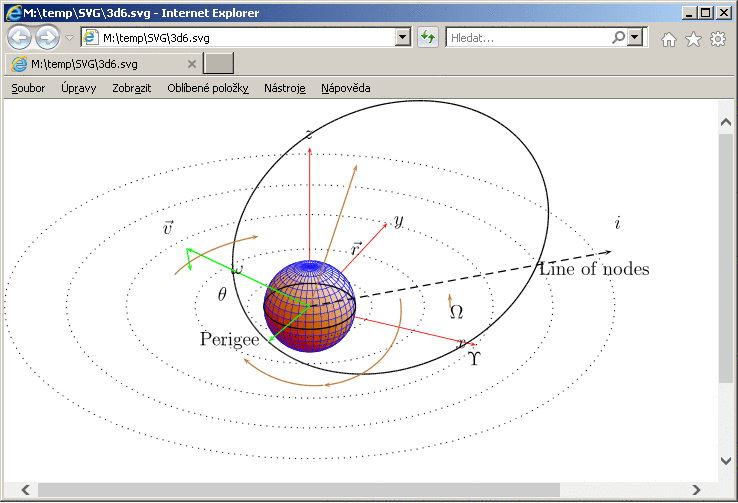

Please note that retired Internet Explorer displays this file without any problem. SVG is a major format type of LightBurn and it should be implemented without problems:

I do not know. I has been developped Graphics Magick and I have some test files.
There is a comment found in a file:
<!-- This file was generated by dvisvgm 1.8.1 --> Looks like SVG drawing tool: https://dvisvgm.de/

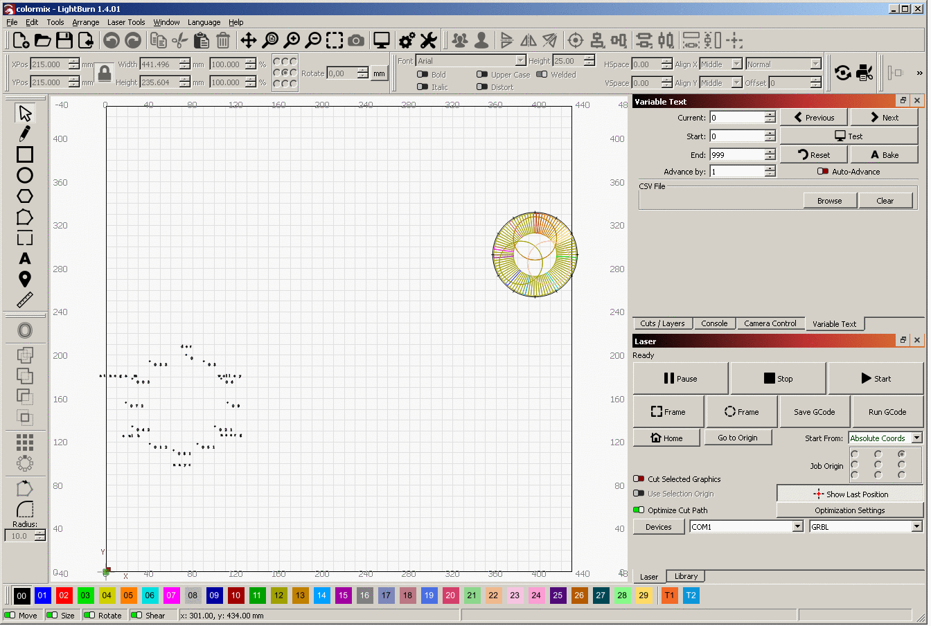

The SVG import problem seems to be quite common, see another image attached:
colormix.svg
PS: Please allow to upload SVG to this forum.
Thank you for this additional example from the same generator.
Color Wheel svg file: <!-- This file was generated by dvisvgm 1.8.1 -->
