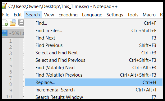

If you are OK with editing your SVG file, this will move all of the polygon (vector) text to the tool layer T1.
Open the SVG in Notepad++
Search>Replace
In the Find what box, enter:
g class=“stroked-text”
The above line should start with a “<” and end with a “>”
In the Replace with box, enter:
g style=“stroke:#f36926;stroke-width:0.05mm;fill:none”
Select the Replace All button
Save to a new filename.SVG
Open the new filename.SVG and all of the polygon(vector) text will be on tool layer T1
