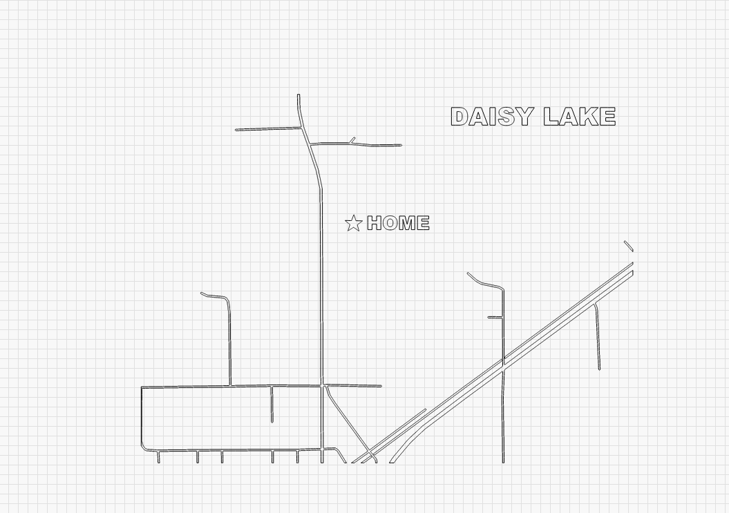

Having issues importing SVG files I created in Inkscape by tracing a PNG to Bitmap. I need it to import completely filled in, lines and text. They are solid and filled in when saved on Inkscape as SVG, but when I import the SVG file into Lightburn, it creates an outline/trace around the shapes and they don’t get filled in properly. The problem affects the Text as well. See photos for reference. Any help would be appreciated!!
EDIT: I figured it out! I had the “Cut” setting selected, and needed to have the “Fill + Line” setting selected
consider to change your window setting to coarse filled to see if you are getting the desired result. Also ensure that the layer settings for this import are set to fill rather than line.
You probably want just Fill. Fill+Line fills the shape and then does an outline around it as well.
