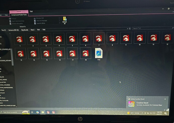

SVG Thumbnails not showing
When i get svg thumbnails it only shows me the lightburn logo
In order to see the svg i gave to open it in LB and save it then it shows as a lbn file
How do i fix this

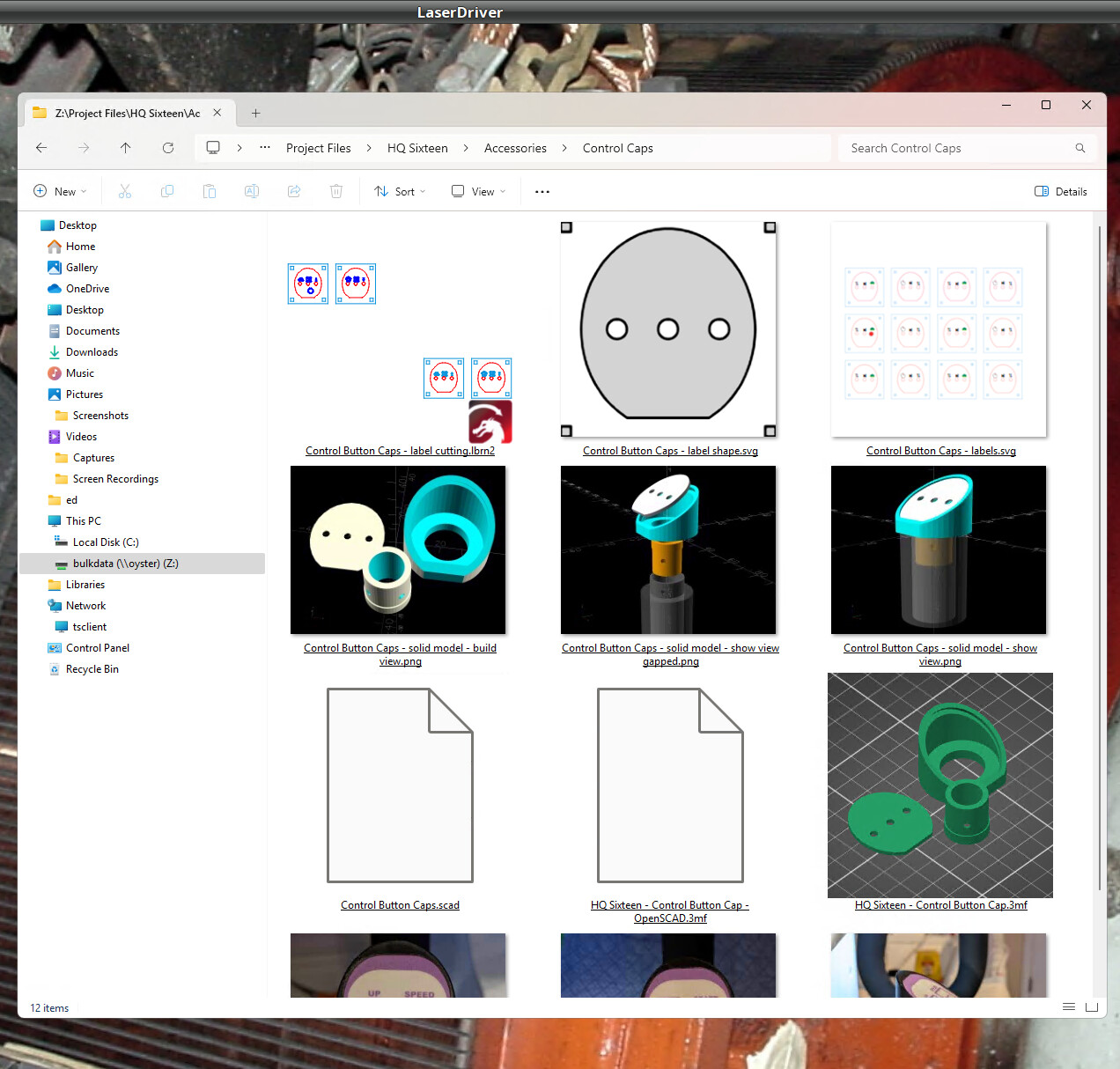

The File Explorer add-ons in PowerToys enables thumbnails for SVGs and even STL files.
This works for me regardless of the default app for SVGs
