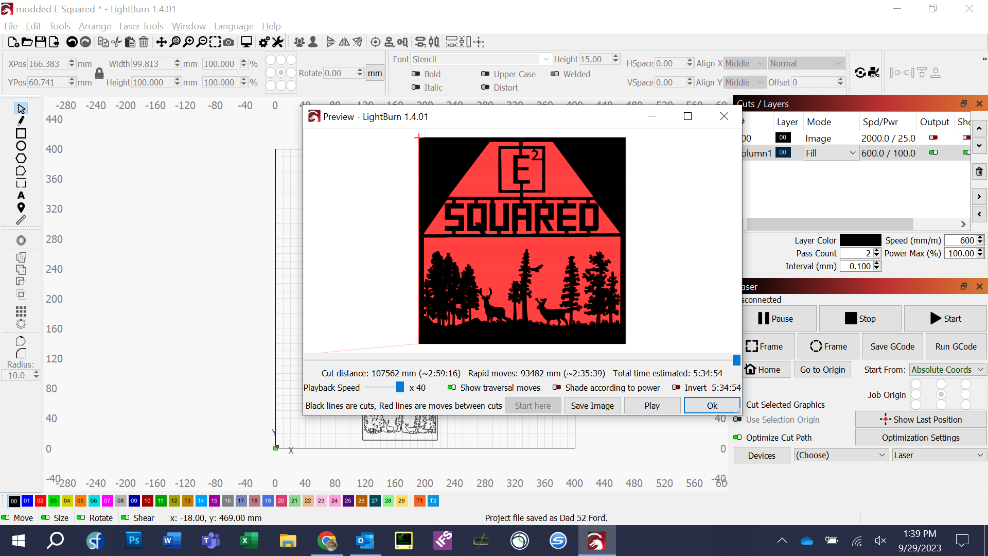

Switch what is being cut from what is the moves between cuts
I have a file that i converted to SVG it is cutting what I want it to move through and moving through what I want it to cut. Is there a way to reverse these selections?

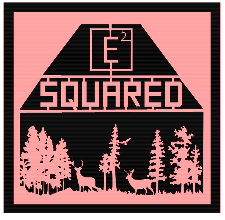

modded E Squared.lbrn2 (494.9 KB)

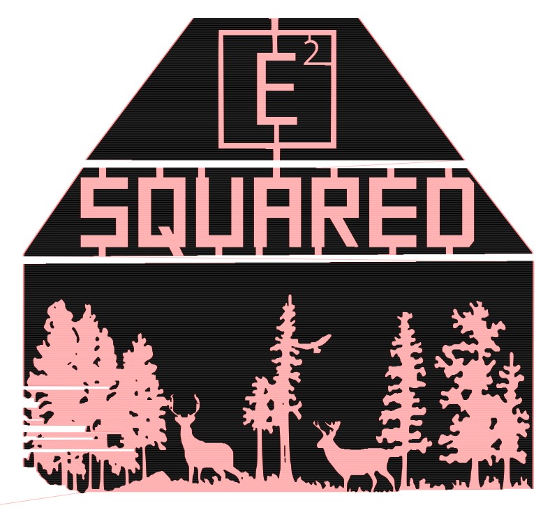

Be sure to either delete the bitmap or set the output to off. Also, you have a square that isn’t needed, as best as I can determine. The attached file moves the square off to the side for easy deletion.
I converted the bitmap to a trace, set the bitmap layer output (and show) to off and just moved the square. If the result is not what you require, please advise.
What I’m trying to do to this is cut the red sections and move through the black the exact opposite of how it is setup. How do I switch that?

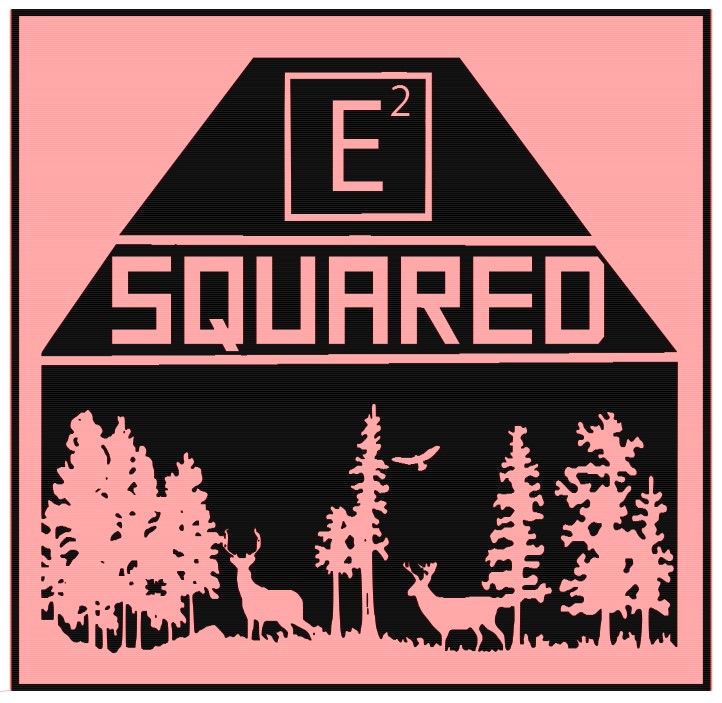

Place the modded file back over the other one. Black over the image.
Ungroup and delete the square “frame”.
-or-
If you want to have a frame, add another square to give the frame some ‘thickness’…
I made a few little adjustments. just suggestions, The original appears to have been intended to be a cut line since all the elements were connected by tabs. They muddy the image and you don’t need them for an engrave. Of course, if they’re part of the aesthetic, that’s perfectly fine, too.
if you want to try it, call that a learning module in the boolean and node edit tools. Between the two examples, you’ll be off to a good start. :slight_smile:
That’s what I was looking for. Thanks.
