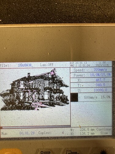

I’m very familiar with LB but I can’t figure this one out. First issue is when I click preview it’s no longer an instant popup. It takes 5 min, literally, to load and just see what changes I made affected what. My settings also don’t apply or stay. If my cut times were 100mm/s or 500mm/s the cut time in preview are both the same.
So I sent the file to my controller to see if my settings are retained and it shows 500mm/s but is cutting at 300? Attached pic. I’ve downloaded everything but I haven’t switched my activation key. I’m at a loss.

It’s very likely that the max speed configured for your machine is 300 mm/s. So speeds will be capped to 300 mm/s irrespective of the requested speed.

I will get that info this evening if I can. I’ve had my machine for over 2 years and have never had this issue before switching laptops. That is the only change. So before looking I wouldn’t know why my machine settings are all the sudden different when nothing has changed other than the computer.
Do this to prevent that:
All those fiddly settings you worked out before really do matter! :grin:
