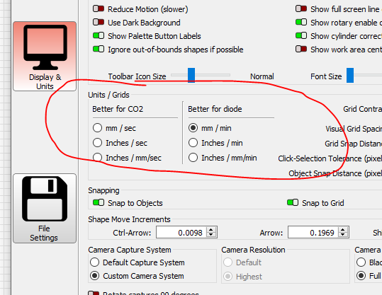

Hi, when I switch between using my diode and my CO2, I always have to go in and change over my units. I notice this (obviously when looking at the Speed/pwr for the layer) but more so when I go to frame my image over the item I’m engraving. On the CO2 it’s deathly slow framing, but the value for “Speed” is correct. Then I remember that I need to check my units. Lightburn recognizes I’m on one or the other for sure because when I look at my Lightburn settings, it’s properly under “Better for CO2” but it has hopped to Inches/mm/sec. When I change it to mm/sec and go to my move window and re-enter the correct value, everything is back to normal.
Is this the same for everyone? You have to manually go in and change each time you switch from one to the other? Would think you should be able to save this somewhere so that when you select your device in the drop down, it automatically loads this if it doesn’t do it automatically. But I do not see a save or export settings button on the Lightburn settings window.
No. Unit settings should be retained automatically on a per device basis.
Review your prefs files. There is a Units entry under the Settings portion of each device. I believe a value of 0 is set for mm/s and 1 is mm/min but I haven’t validated that definitively.

I thought I was clear on this. LightBurn does remember and is retained per device. I have devices configured with different units and they dynamically shift as I change devices.
Can you confirm how you are changing the units? Is this within LightBurn->Preferences (for Mac)?
I just checked this on Mac and it seems to be working normally. Note that you may need to explicitly set the units one time per device.

I set through Lightburn General settings. Yes for Mac.

More this than the other options. In the same instance, switch to a device, if the units are incorrect, set the units appropriately. When switching devices the units should follow.
No reinstall is necessary or advised.
Is this how you’ve been doing it? And are you saying even with that, units are not retained?
If so, again, check your prefs file to see that the units are being stored properly per device as I indicated in my first reply. If you’re not sure how to do this then export the prefs file or the individual devices and upload files here. I can confirm if the units are being stored as expected.

I honestly can’t believe this was it. I must have just never set the two during the same instance. I closed down LB and opened again and it seems to have retained the settings.
