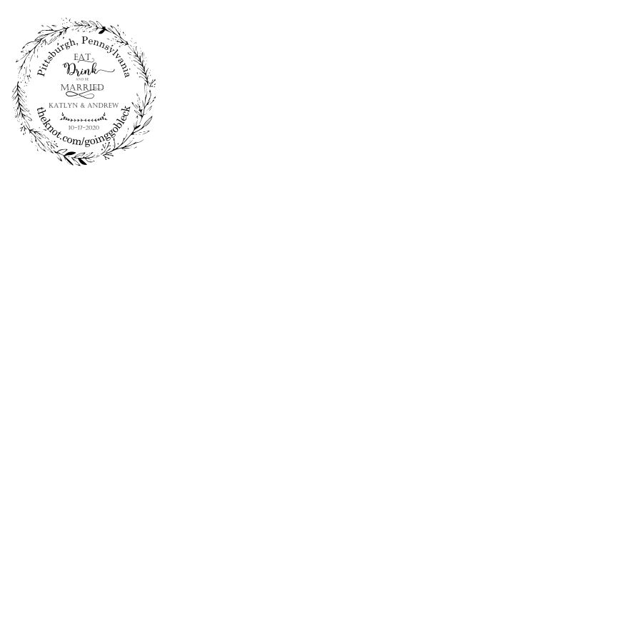

Total newbie to everything laser! I need to engrave wood discs for my daughter’s “Save the Date” magnets for her wedding, just recently purchased Universal Engraver 15000mw blue CNC laser machine and T2Laser Software, but need to know what the correct settings should be to accomplish this…or at least how to come close.
Also, would like to engrave many of the wooden discs in one engraving setting. They are 3-inch discs and I have a 40x40 laser setup. If anyone has suggestions how to set up a file and how to accurately arrange/place the discs on my platform so that they are all centered and engrave properly, that would be wonderful!
And, I need settings for T2Laser Software to engrave/burn them. I may have bitten off more than I can chew by telling my daughter that I would just buy an engraver and do them myself! Ugh!
I need the instructions for quote, “Dummies,” unquote! I have attached below a jpeg of what I am looking to engrave on the wood.

I’m not familiar with Universal Engraver, but assuming it’s GRBL, a threshold image mode (no dithering), 2500mm/minute, 80% power, and about 300 DPI would be my suggestion for a starting point. Try that and see how readable it is - 3" isn’t very large, and the details on that are pretty fine, so if there is a preview available, I’d check it there first to see if the details are sufficient.
Expect to run a couple as tests before you get it dialed in, and make sure it’s focused properly too if you haven’t done that yet.
Your question about setting up your workspace can be answered with cardboard. When I require accurate registration, I use the laser to cut an opening to match the work piece. It’s necessary to secure the cardboard to the bed or all the effort is for naught.
Use cardboard that is just a bit thinner than your wood, to allow you to lift them out and place the next run, or cut thumb holes on the sides of the openings for the same purpose.
The cut file you create for the cardboard cut is then used as a guide for the engraving to be performed.
