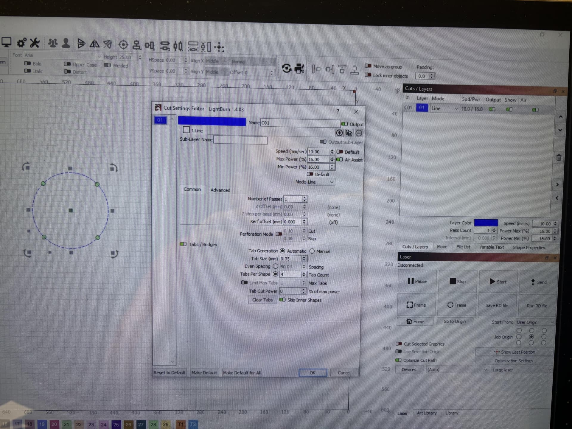

When I set something to line, tabs automatically are in place. I have to turn them off manually. I push the button to make it the default setting but it does not change anything. I have restarted the software and rebooted my computer.
Can you post a screen shot, so we can see what’s happening?
All I did is select a circle and drew it. When I checked the settings the tabs are automatically on.

Also check the Load default layer settings on new or restart option in Edit → Settings → File Settings:
You probably want it On to load whatever the defaults are for that layer.

I read your post closer and found that that button was not on. I selected it and it fixes the problem. Thanks!
