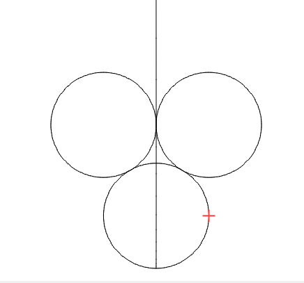

Draw a frame line, right click to lock object
Select circle and line. Align left/right edge to get tangent.
Select next circle and frame line, the align to get tangent.

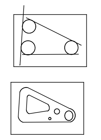

It is not a CUT operation, it is for design work. The attached image illustrates the initial and final design where a Snap to Tangent is almost mandatory. We are working off customer-supplied blueprints here with a +.001"/-.002" tolerance, so “close enuff” will not be acceptable.
Make sense?

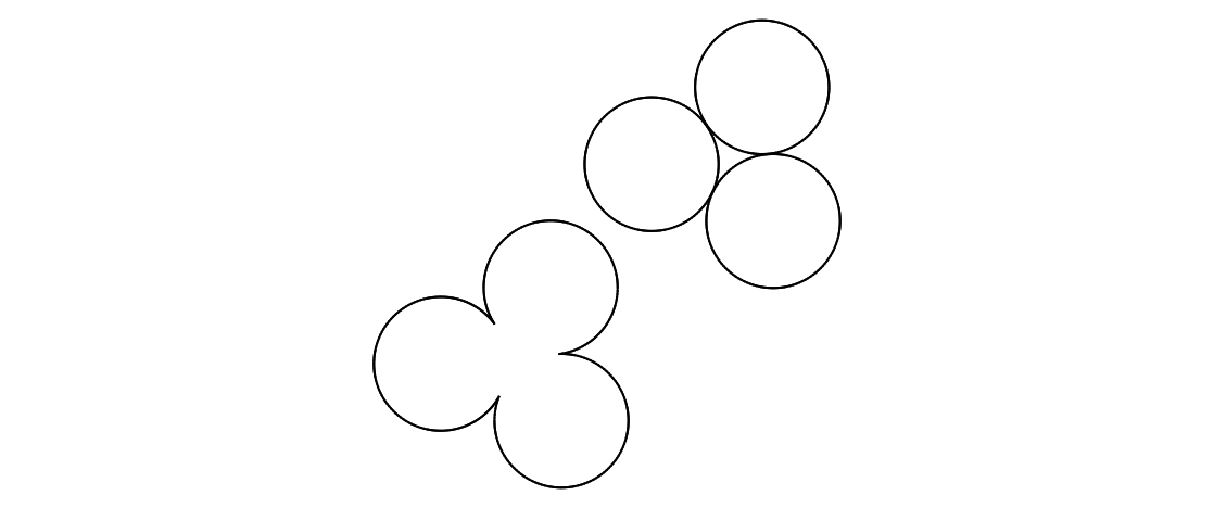

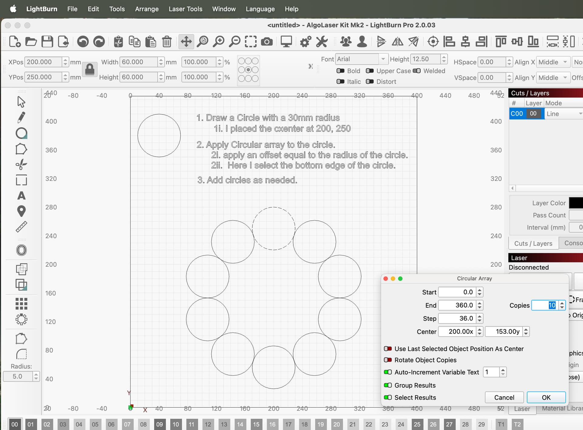

Do you mean several intersecting circles at exactly one point?
Two circles can only be tangent to each other at 1 point.
A third circle can not be tangent to the other two at the same point.
Circles can all intersect at the same point and generate some interesting visual effects.

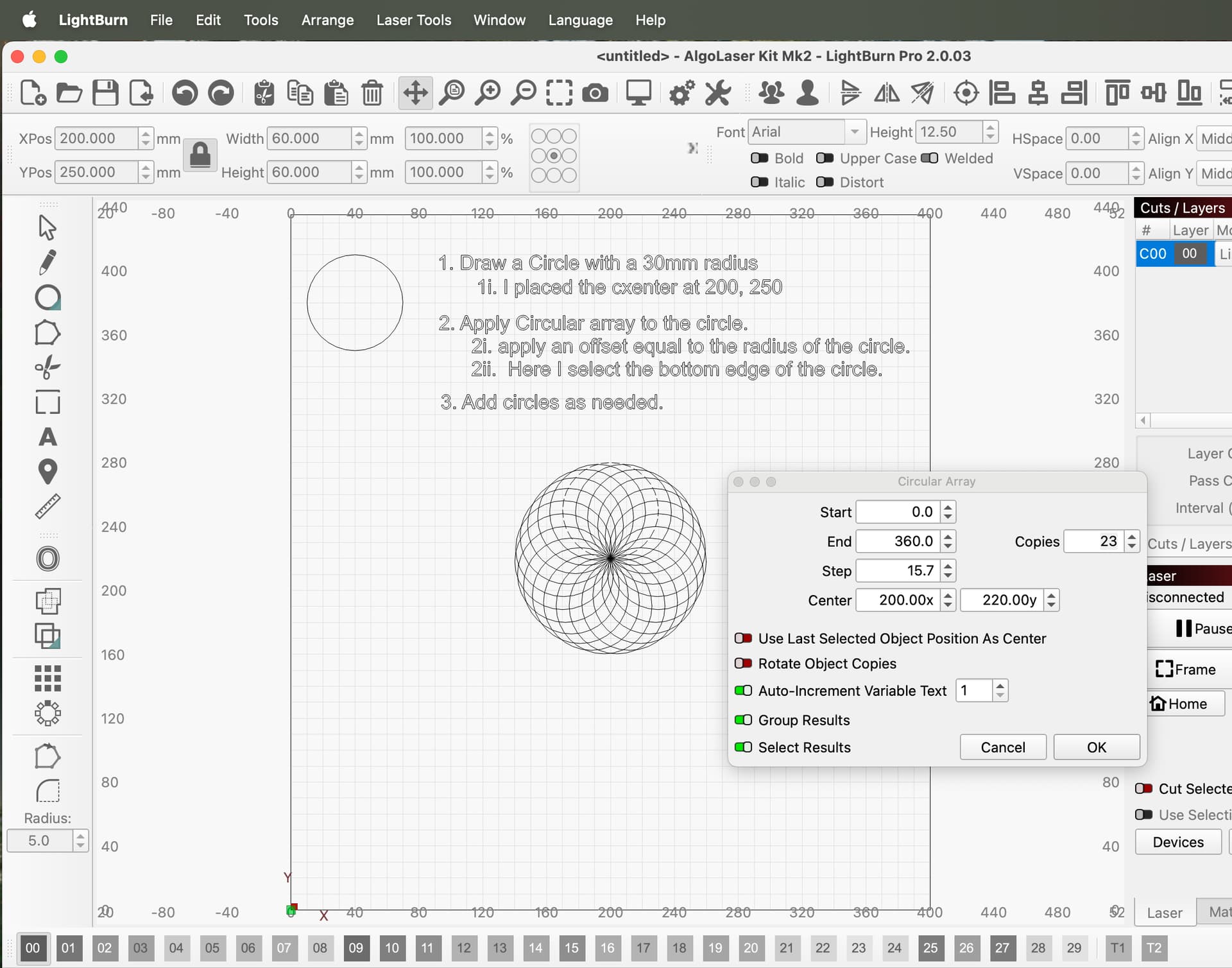

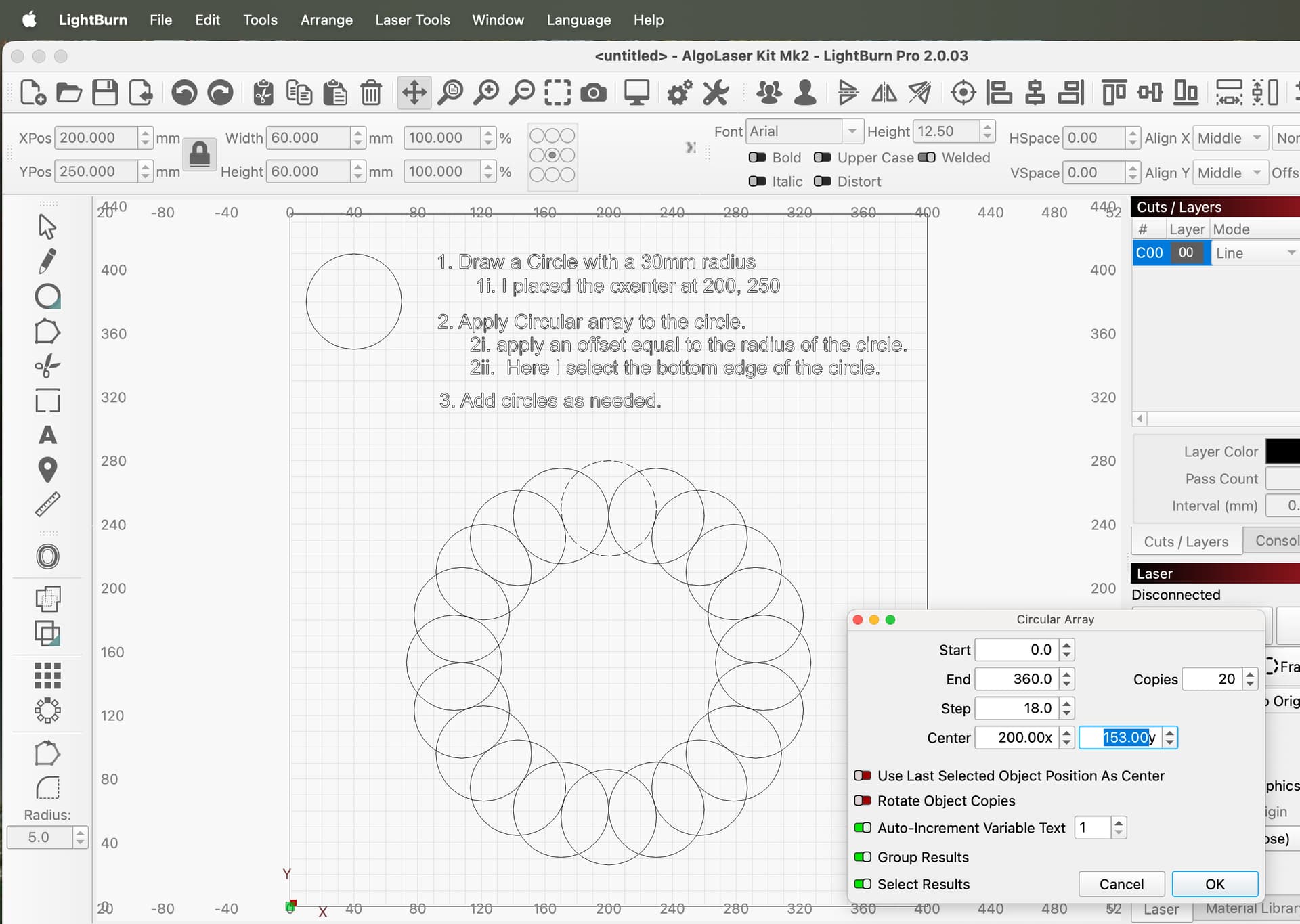

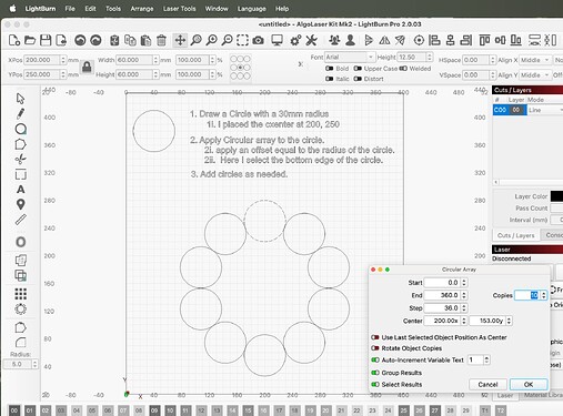

This can be done with the Circular Array tool.
or interlinked?
Or tangent to its neighbor at one point?
