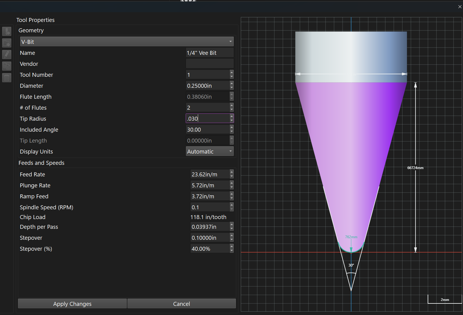

Just a quick sanity check, did I enter these right? I couldn’t get the cut depth set right if I entered the advertised radius and angle.
It looks like you are entering it as a V-Bit, under Geometry change it to Ball.
If you do that you just get a small radius at the very tip of the bit. In this case these bits are angled for the entire cutting surface.
Thank you but if you look at the actual bit geometry of the bits I am entering vs what the ball nose profile creates, you can see that the Ball nose bit profile creates a uniform diameter other then the rounded nose. The tapered ball nose by contrast have a rounded nose but do not have a uniform diameter it goes up on an angle, like a v-bit but at a much smaller angle.
I am sure they need to be entered as a v-bit based on some other threads but I wanted to see if I had entered these specific bits properly.
Ahhh I see what you are saying, The bits are calculated correctly in the tool-path, what you are seeing in the tool editor is just a stylised image showing the area highlighted related to the editable fields.
It uses a calculated length and is over 30mm long in the software but the bit only had 12 or 15 mm of cutting flutes.
So far I have not used a TBN going that deep, so haven’t noticed that, I would expect the manually entered flute length to override the calculated length, so you might have found a bug that needs reporting.
I found you can mess with the V-bit Included Angle to get the correct cutting flutes length. Not a ball end, but was a wierd Chinese bit.
Is that tool image in the Manage Tool Library window a new RC-4 addition? I do not see it in the Production Release v0.8.00 window.
No, that’s been there a while, though there was an issue with the code that validates the properties (like flute length) so it wasn’t always showing up. That’s been fixed.

just updated to 0.8.01 and was wondering when the additions of the tapered ball nose bits would be implemented. I am able to continue to use Estlcam no problem, while waiting. just anxious to go in 100% with Millmage.
the bit I am wanting to use first is a 1/16”x1/4”x3”x3.6* tapered ball nose. if y’all have a temp setting that will get me by, that would be helpful as I convert my gcode files to millmage.
That already works, and has for a while.
Create a V bit with the correct angle and diameter, then specify the “radius” value of the ball-tip. There was a bug in the code that handled validating the length of the flutes, so you might get weirdness from that, but you can define the bits already, and the next RC should have the fix for that part.
