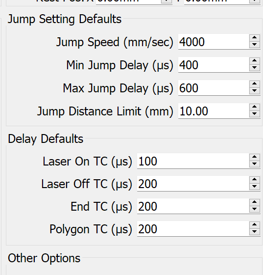

TC Parameters don't seem to do anything in my Galvo laser?
Hi, I’m trying to follow this article on adjusting for Scanning Offset in the device parameters. Now I don’t see such an option on my galvo laser device settings:
for reference: it’s a chinese galvo laser with a BSL card, with a JPT MOPA M7 60W laser source.

Ok, I’ve just finished running a few tests, iterating through all the timing and jumping options.
Here’s where I started:
Jump Speed: 4000mm/s
Min Jump Delay: 250 us
Max Jump Delay: 500 us
Jump Distance Limit: 10 mm
And where I am now:
Jump Speed: 500mm/s
Min Jump Delay: 100 us
Max Jump Delay: 200 us
What I found is that the delay settings (Laser ON TC, Laser OFF TC, End TC, Polygon TC) have zero effect in my results…I’ve tried ranges from 0 to 5000 and I got zero perceivable differences between them (I looked under a 30x magnifier).
It’s as if these parameters are not implemented for this galvo laser option?
Anyway, the image quality has dramatically improved by just reducing the jump speed, at the penalty of longer run times…but I’m still getting a slight offset between the lines as you can see on my last image…any ideas?

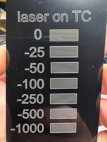

Since LightBurn does not have the “Mark Contour” setting, in order to see where your scanning lines start (Laser On TC) and end (Laser Off TC), you need to also engrave the bounding box of your fill layer by using another layer of the same shape but in Sublayer Line mode:
So, you get example engravings like this:
Also, make sure to disable "Bi-Directional Fill and “Cross-Hatch” to have the scanning lines engrave from left to right only.
The desired value will be more in the range of -1000 and +1000.
Also, make sure, you are using a reasonably high speed, so you can see the differences. They are using 1000mm/s in the video.

The Laser On TC can be negative!
A Laser On TC of -1000us means: the laser fires, waits for 1000us, then starts moving the galvo mirrors.
The effect is barely visible, but you can see the burn-in at the start of the line:
As with the other timing values, you are looking for a value where the lines meet at a nice right angle. - For the Laser On TC, look at the beginning of the fill-lines. - For the Laser Off TC, look at the end of them.
Here is a testcard I ran on a 20W Galvo with a “RAYCUS” Fiber Type:
There is a burn-in at the beginning already at -250us. - No need to go lower than this.
My goal is in the positive range. I’d say around +150us:
