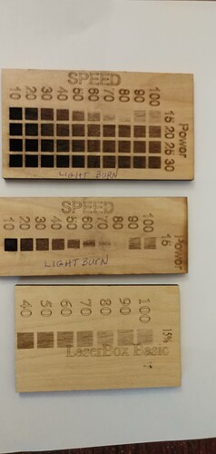

I’m new to the laser engraving so I might be doing something wrong. I’m currently evaluating lightburn for purchase and was running a test pattern and noticed that at 50 to 80 speed with 15% laser power that the test burns are not complete. Below are pics and screen shots of my software/firmware versions. If I run a similar test in Laserbox Basic, the pattern doesn’t show the same defects.
I’m at a lost of what to try next. I reloaded the D1 config file in lightburn, and re-flashed firmware on the D1.So any speed from 50 to 80 has this issue with 15% power. I don’t know if it would effect printing an image say at 80 and the image has a lighter area in it. Would the image present itself with the same issue?

What was the orientation of the burn?
At first blush this feels like a firmware bug to me. Can you try using Constant Power Mode. Does that change the behavior?
All the burns were vertical. I did try constant power mode on another test and the results were the same.

Can you see the laser light on the whole time that it’s expected? Or does the laser turn on late and turn off late, matching the unburned areas?
If I increase the overscanning a ridiculous amount the burn does get a bit wider but isn’t the 10 or 12mm wide as it should be.
As I mentioned before, the problem seems to show up with 15% power and mm/sec from 50 to 80.
I’ve tried, constant power, bi and unbi directional burning, cross hatch. Also, Reinstalling firmware, D1 config file (in lightburn).
If you look at the test, it shows an increasing slant to the unburned area from 50 to 80.

I’m trying to determine if it’s an issue related to power level or timing. Is the laser actually on when it’s supposed to be? Or is the laser not on during the missing areas?

Were you able to confirm whether or not the laser is on during the missed spots?

Can tell if the laser is off since the burn is only 5mm. I will make it much bigger which I think I would be able to tell.
LB also has a test under Menu Laser. Tried that one and got the same results.
I suspect the issues will appear only at the edges but would be an interesting test.
Yes the laser does turn off near the edge but only on items that are filled.
I lined each fill so to know how much was missing.
Top two were with lightburn and the second two using laserbox basic.

Here is a closer look at the previous test. You can see in the laserbox basic 80/15 test, there is a ever so slight missing fill near the end. Seems evident here with the larger print ,that both exhibit the same fault only more noticeable in LB.
