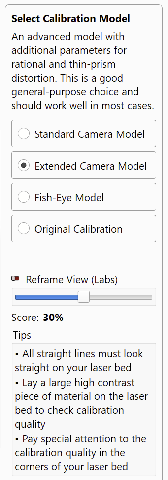

The “Extended Camera Model” has consistently produced the best results for me. Even with a score of 30%

I got a better understanding of the Score % value now:
The score is based on the average error between the detected calibration points and where the camera model predicts they should be. It isn’t a direct indicator of calibration quality.
A calibration that only covers the center of the image often scores higher because the center has very little distortion. Once you include the edges, the model has to account for the real-world imperfections, so the score naturally drops, even though the calibration itself is more accurate.
From the notes in the wizard:
The Extended Camera Model is an advanced model with additional parameters
for rational and thin-prism distortion. This is a
good general-purpose choice and should work
It seems counterintuitive, but the Extended Model often produces better results with highly distorted camera lenses than the “Fisheye Model,” which was specifically designed for that purpose.

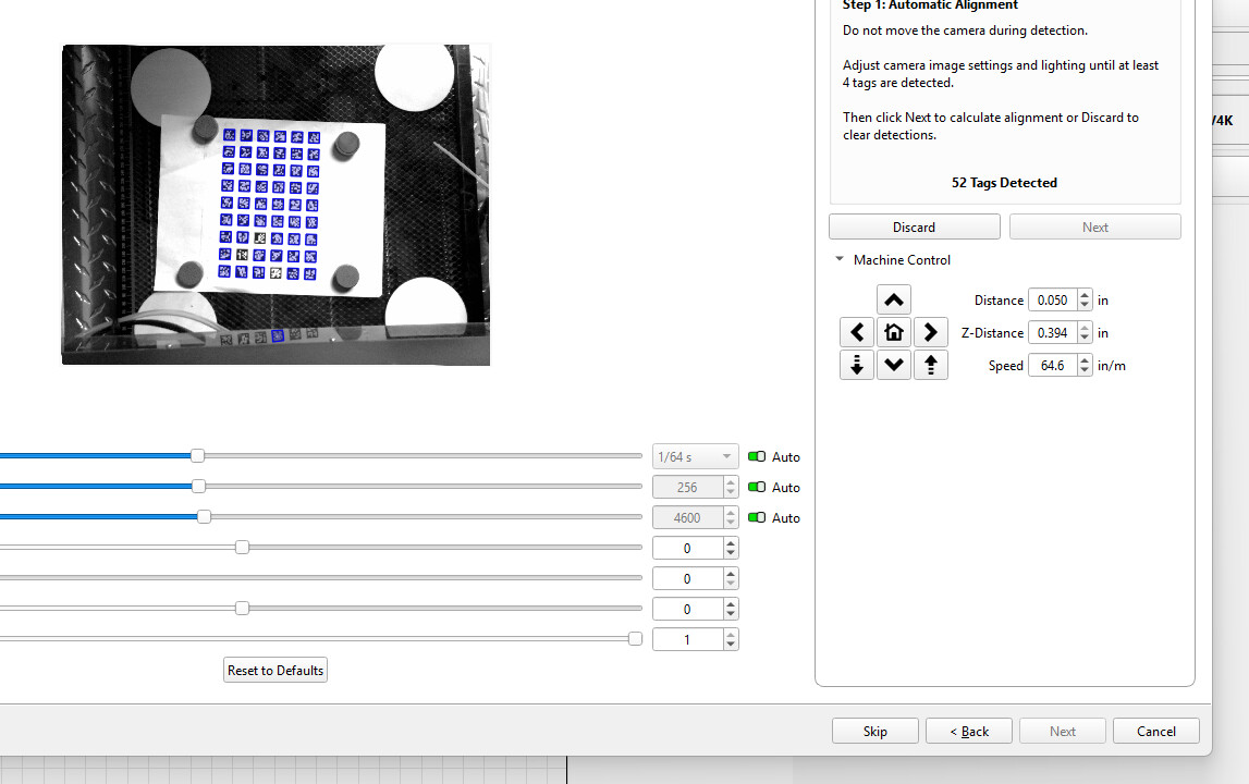

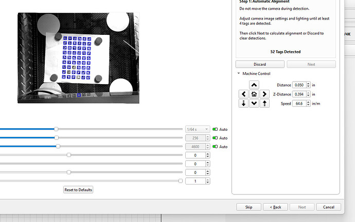

Back to the original problem of setting up a camera. I reached the point of auto alinement with 52 of 54 tags detected. The instructions says to click on NEXT if at least 4 tags are discovered.
PROBLEM: The NEXT button never activates, just stays greyed out, so I can’t move on!! What is going on? LB 2.1.03
In the previous step of the Alignment wizard, It asked you to engrave the eight target markers.
It appears that this was skipped.
Your image shows the AprilTags calibration card. This is only used when calibrating the lens.
In Bernd’s first post he shows the process with the target markers.
In the Camera Alignment process that you are showing, the laser needs to engrave the eight target markers. LightBurn then detects them with the camera. This tells LightBurn where your camera is positioned relative to your machine’s work area.

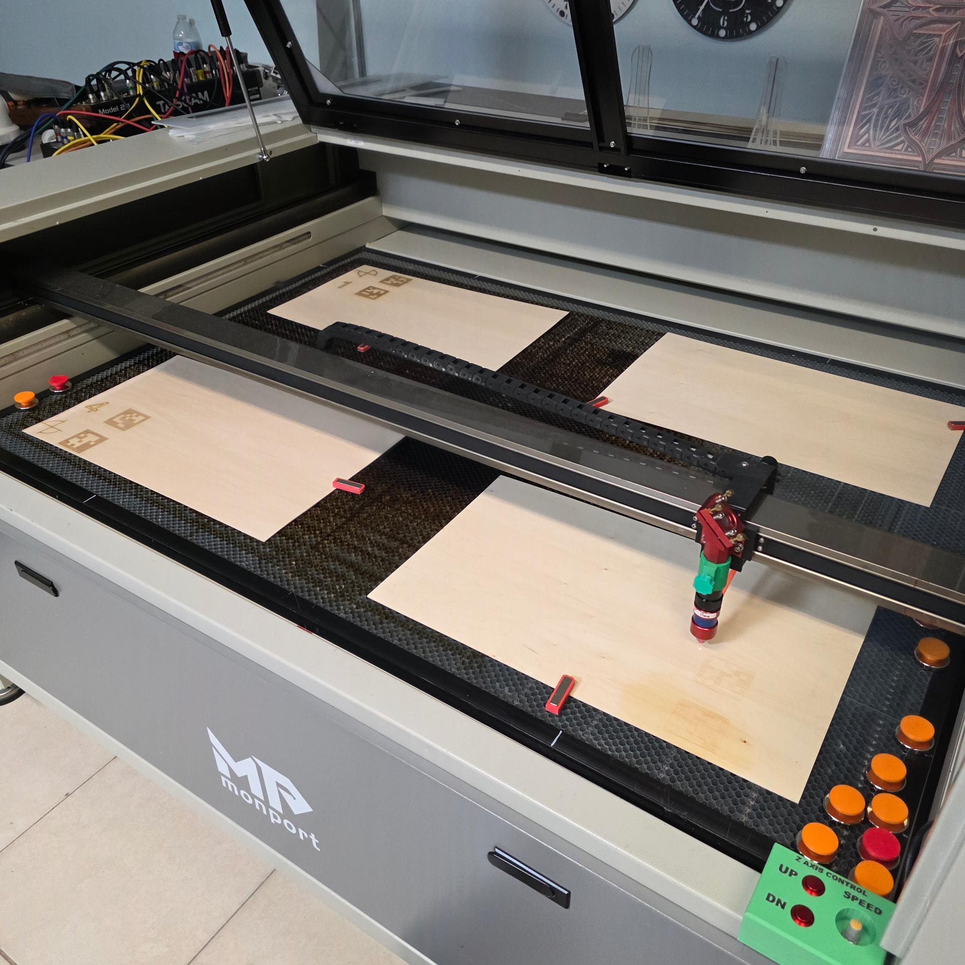

Here is the calibration on my laser..
My biggest concern, from day one with calibration on this larger bed is the ability to get good engravings on all 4 corners..
as we all know the right front corner is the weak power quadrant, and it impacts being able to hone in on the cross hair center with the camera…
I understand on most machines this is not an issue since the beds are smaller.
but with LB being the Premier tool for most, I had asked before that the user be able to select each quad for LINE/ENGRAVE individually and then have access to speed and power to get the best targets on all four quads…
not sure how to handle this other than run the process twice and put extra sheets over 1 and 4 (left side) and then only the 2 and 3 targets will get cut/engraved a second time… yuk…
Comments please (HOPING THE LB FOLKS SEE THIS )

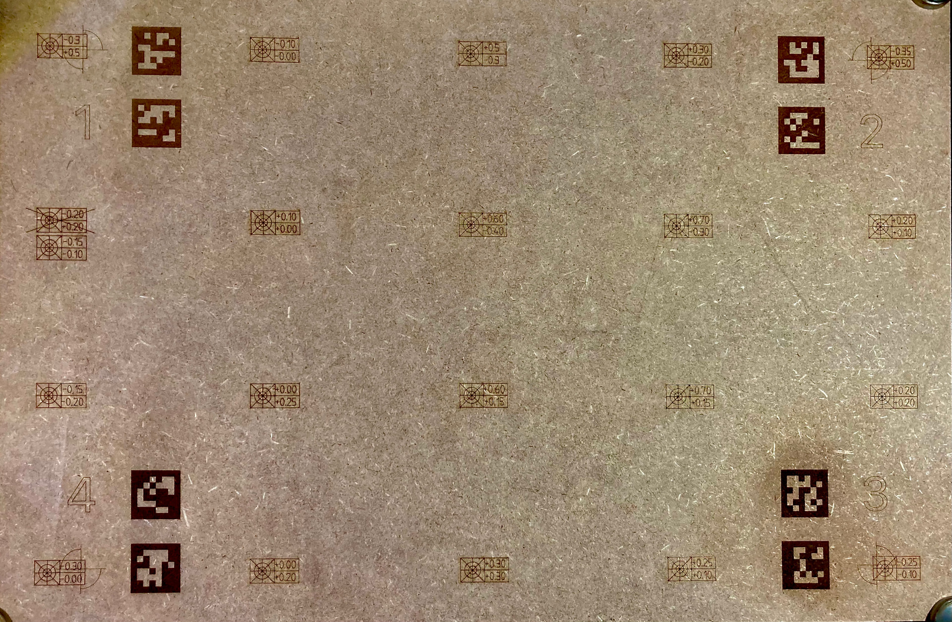

I will try to calibrate the camera so that it covers the entire work bed as best as possible. Then I will run a deviation test, with representative measurements.
It’s an older test that shows my deviation at different positions of my 600x400mm workbed.
Measurements are done in this way, that I engrave my target mark, afterwards adjust the deviation of X and Y and engrave the found deviations into the box. Then I set the compensation to 0 again to start the next field.
With larger work areas, you have to be extra careful about unevenness of the work surface. The large plates can easily bend a couple of mm above the diagonal, with the result that the camera alignment no longer fits the entire area. This is not theory but proven practice.
The problem with a certain area that is more inaccurate than the rest, can also be caused by the camera mounting. In my case I had to change the mounting angle of my camera in the X direction by about 1mm, which gave me a better average value. I generally spent a lot of time finding the best possible positioning, even though the software can/should compensate for it. My philosophy is, anything that can be optimized mechanically does not need to be compensated for with software.
Once you have found the deviations for the entire bed, you can fine-tune separate areas, the middle for example, instead of finding an average value which is coarser because it has to compensate/cover the entire area.
For very precise work I do a quick check in the segment I want to work on and fine-tune the X and Y deviations.

Tomorrow I plan on spending time on the camera setup, 3D print some proper camera holders etc. today I fixed all three hindges and the lid now opens and closes evenly with little effort,
the 110lb gas struts put so much side pressure that opening and closing would twist the hinge, now that that issue with the 80lb struts is remedied… I can move forward…
Will take pics and post more ‘progress’ I hope
Bernd… your bed picture below how big is the bed size

Yes, that plate is exactly 600x400mm, MDF and I think I engraved calibration marks in 2 passes because it wasn’t dark enough. I will look into the parameters and report back later.
The thin lines/text are engraved with 100mm/s 15% max and 8.5 min power.
