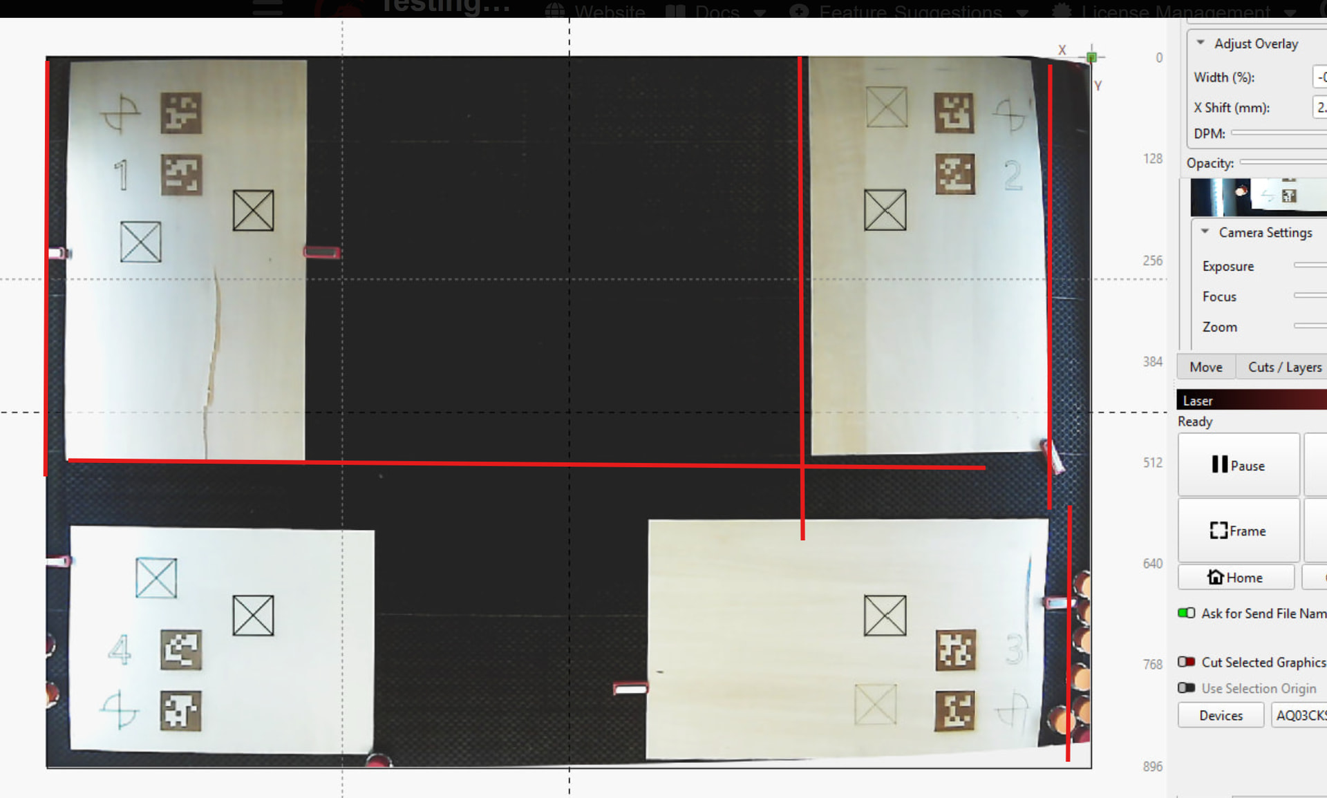

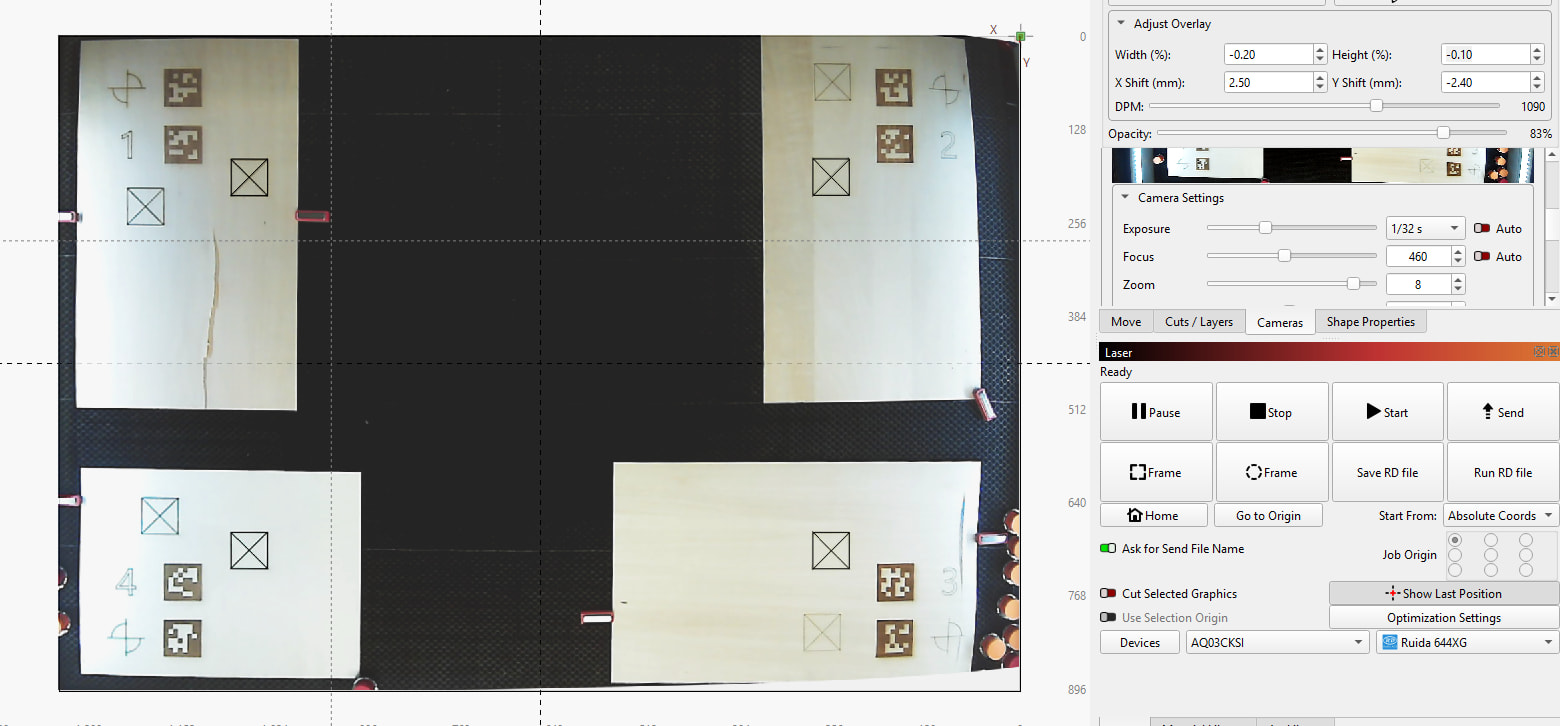

Testing the camera setup in version 2.1.03
Well got the full bed set up with the 100Deg camera…
Managed to use the LB PREVIEW mode to move the laser to the QUAD needed and
burn the patterns a few times to get them dark…
But after all that and setting up the offsets…it worked ok
EXCEPT ! the dang camera has auto-that seems to have a mind of it’s own completely throws
the sizing off each time the gantry moves under the camera view…
Cripes so close…
I need a manual focus camera that has a 90Deg FOV 16mp seems to be ok…
The 100Deg camera I am using is just a bit to far focused and the 76Deg is too close…
so I believe a 90Deg will be fine…
And yes I turned off the AUTO-FOCUS no-joy… the camera still wants to do its thing…
I’ll look for a 90D if it exists…with no auto-focus…
What a shame was able to get all the April Tags to light up and the alignment across a 1100mm was about 1mm..
I can live with that, if the auto-focus would play nice…but LB updating throws me a curve ball and the camera
looks like sailors eyes after a three day shore leave…
More to come I guess…
The X- and Y Shift under “Adjust Overlay” should not be needed if everything is correct.
Which exact camera are you using?

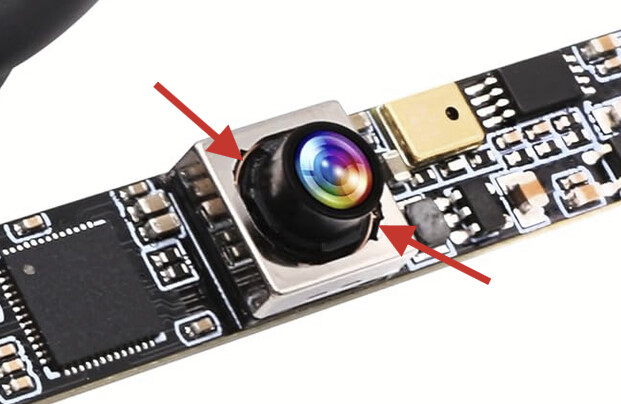

It’s known that Auto focus cameras can be problematic. The main problem is that with the lens correction, we can correct.. ..the lens. The problem with autofocus is that the lens and its distortion are constantly changing.
I haven’t seen a camera yet where you can turn the autofocus on and off.
Just thinking out loud—theoretically, we could use a drop of superglue to permanently lock the autofocus mechanism in place so the focus doesn’t keep shifting.

If it can’t be used for anything else: Once it’s focused at the correct distance, I’d still consider fixing the focus lens in place by applying a small drop of superglue here

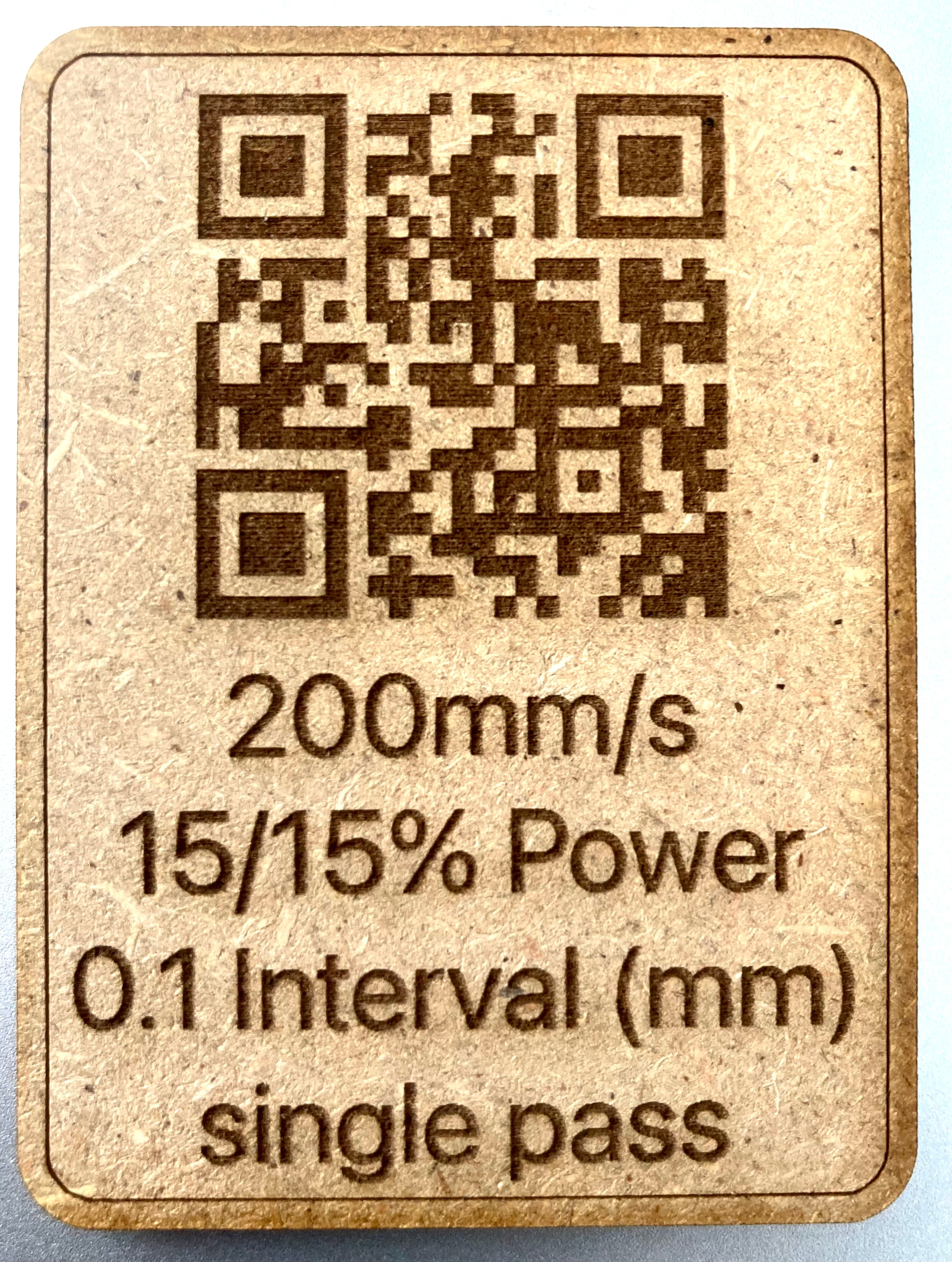

It depends a lot on the type of MDF, this one is “very dry” on the surface, where other types can be “a little greasy”. The last of the two cannot (I) get engraved that dark.
But here are the settings from the darker one.

If the alignment is accurate around the tags, but not anywhere else, it is almost certainly a lens calibration error. I would repeat the lens calibration, holding the target up close to the lens. Try get a lot of captures, covering all areas of the camera frame.
You can see in the image bellow that lines are not perfectly straight, this is also a clear signal that the lens calibration is off.

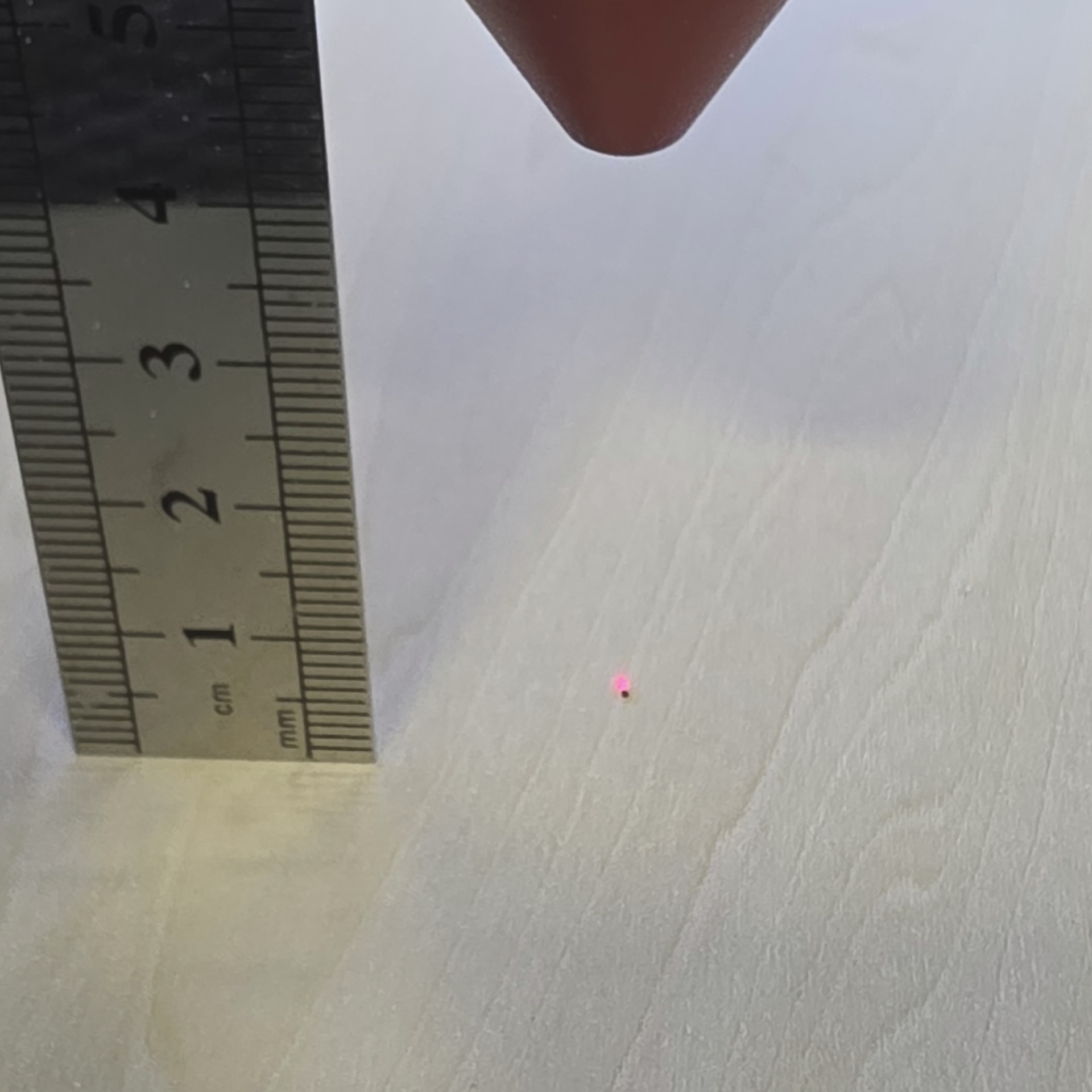

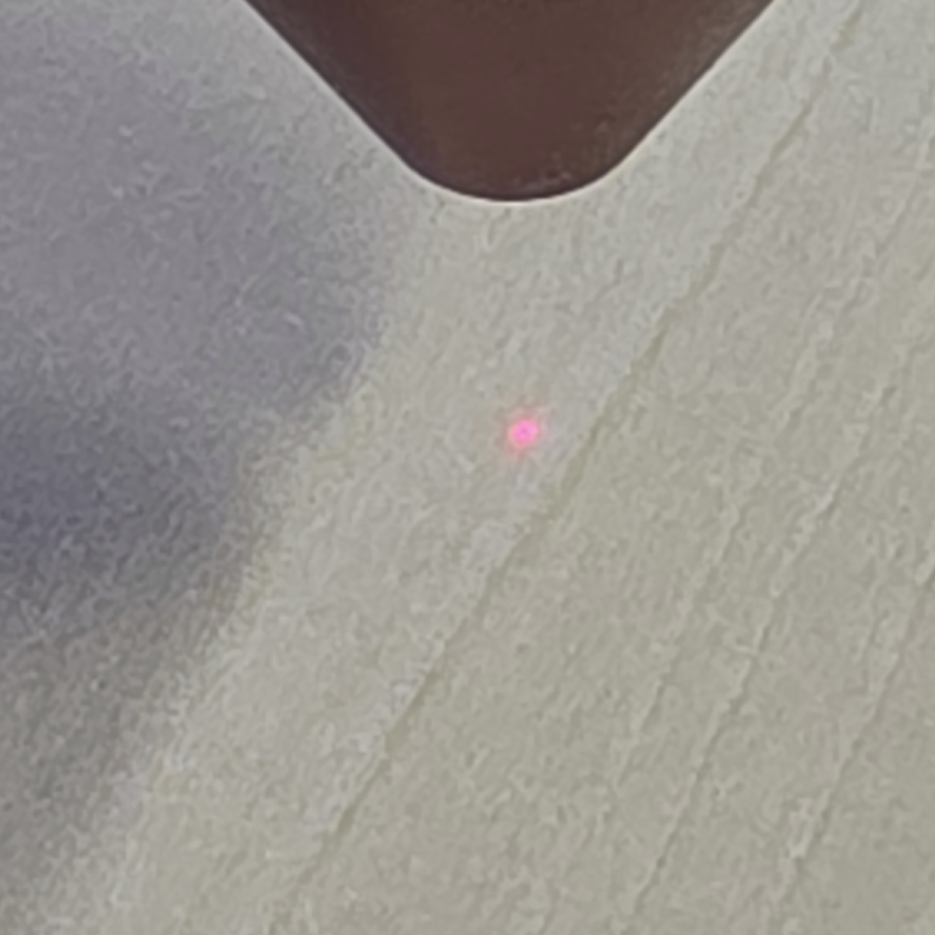

Did a few tests …**

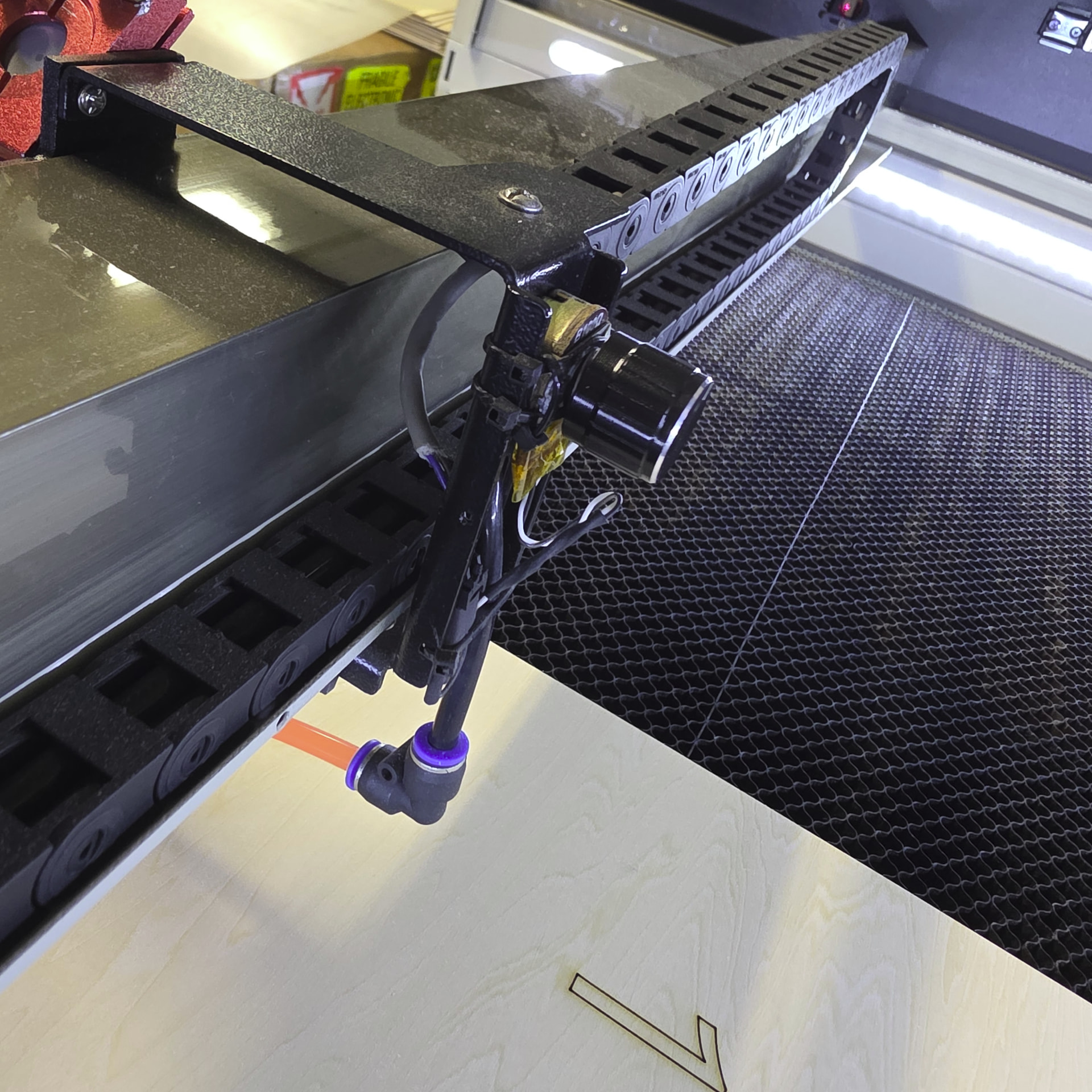

Back side of gantry with installed intensity POT for the LED Pointer
ADJUSTED TO FULL BRIGHTNESS
ADJUSTED TO MINIMUM BRIGHTNESS

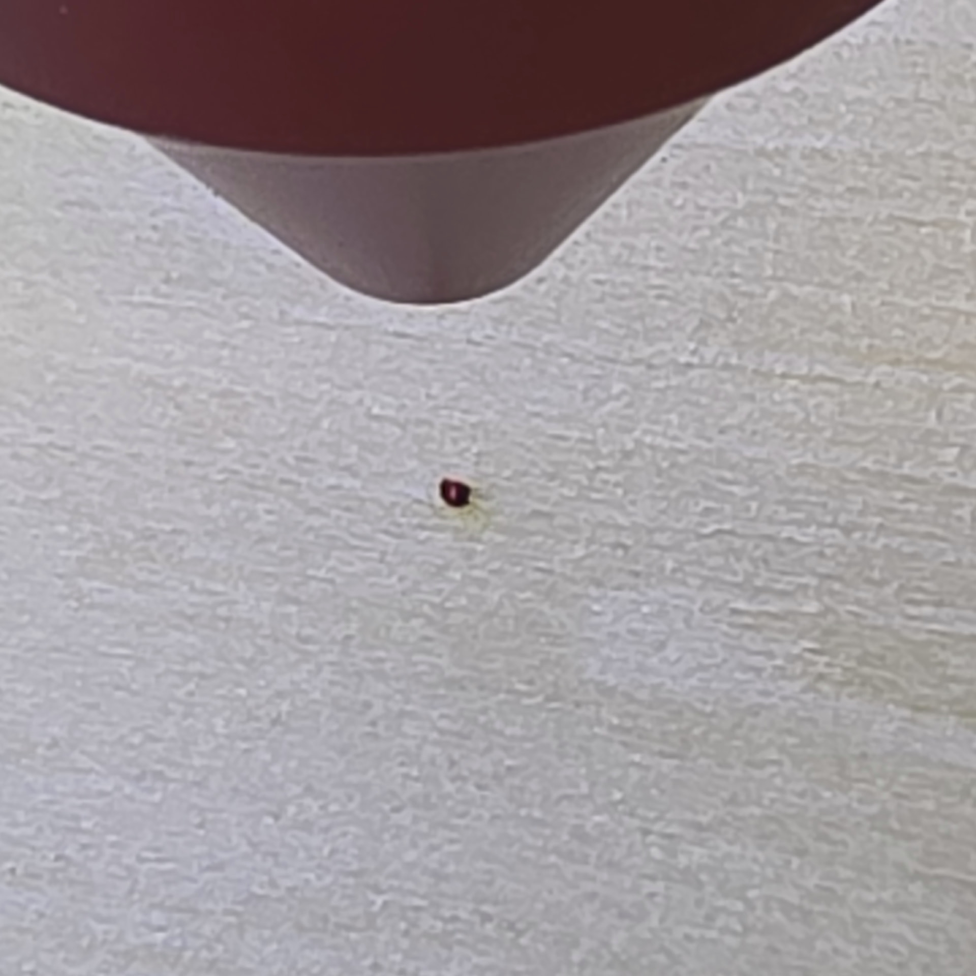

PULSE DOT 10ms 15%pwr
(TAKEN AT THE RIGHT FRONT OF THE BED )

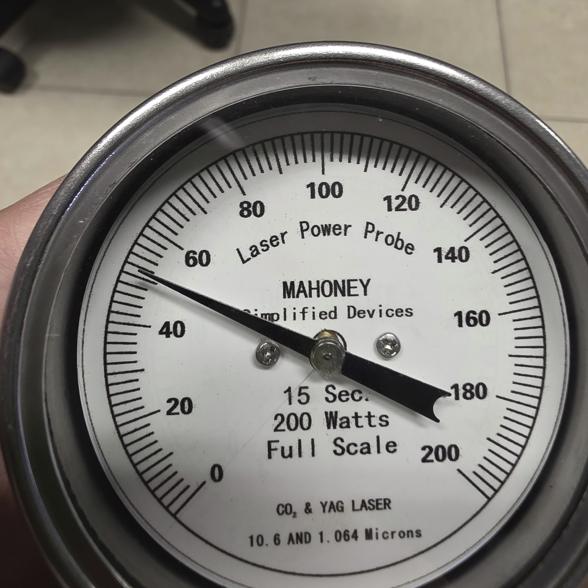

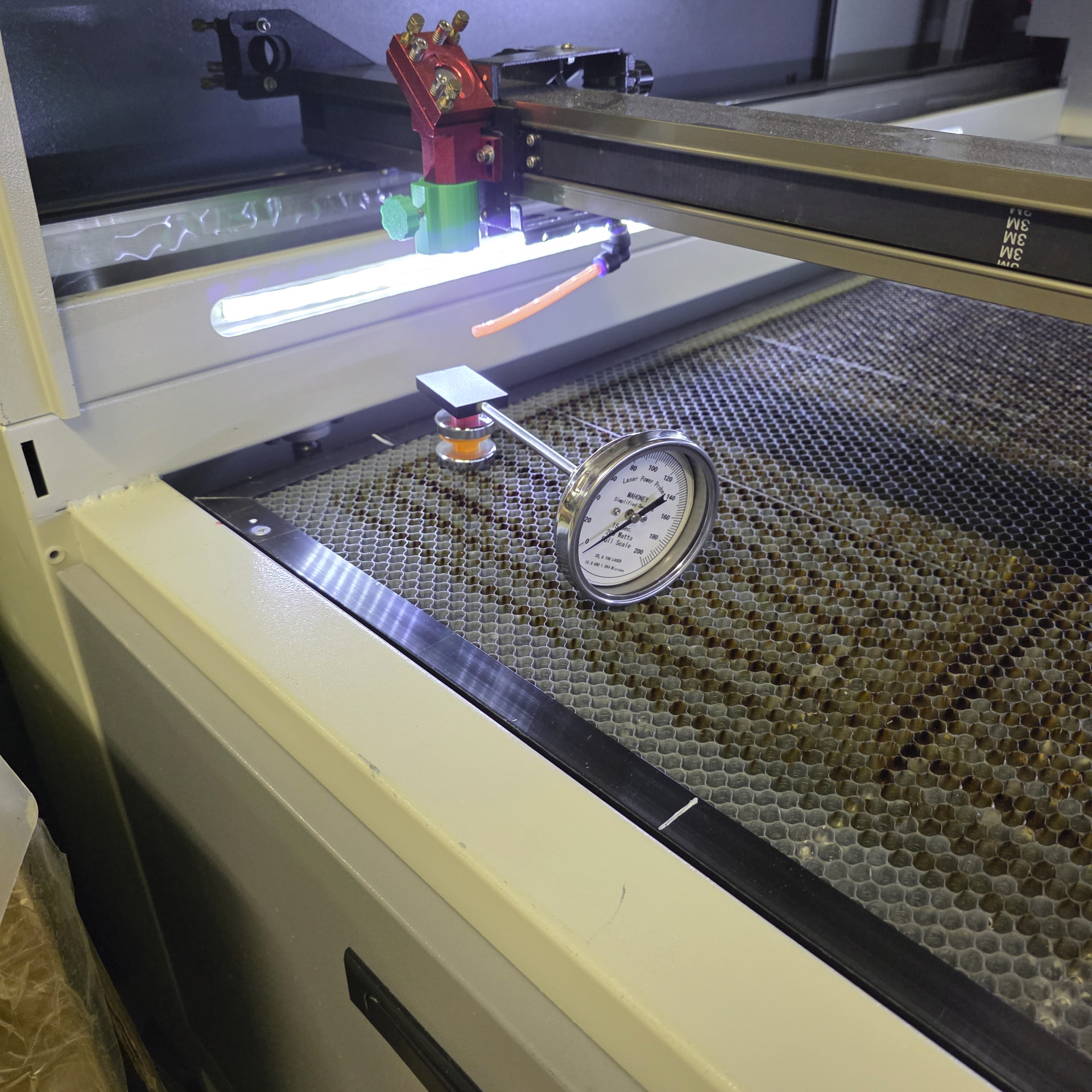

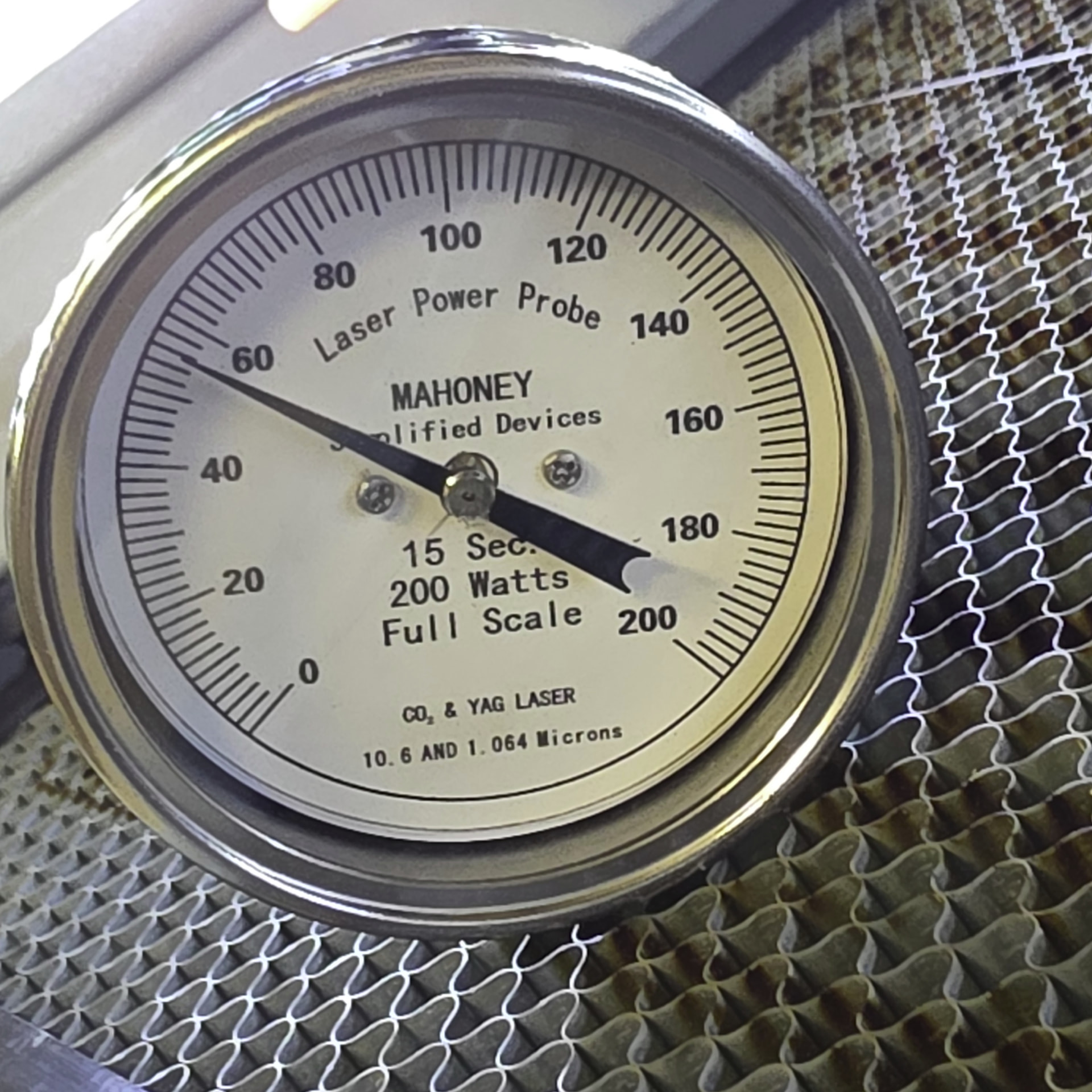

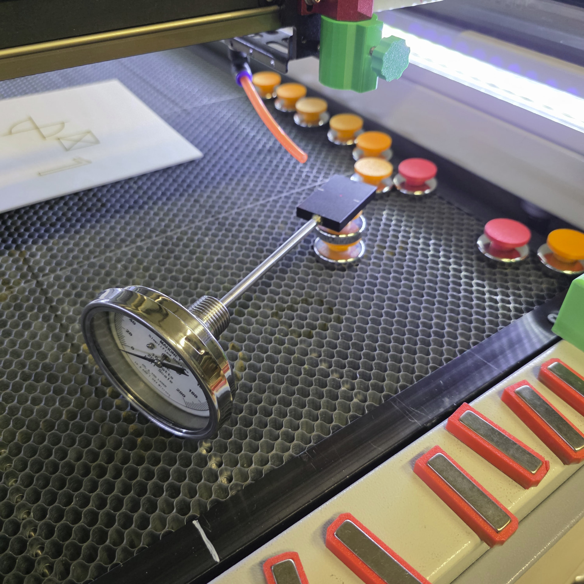

Did a couple power tests also…
RIGHT FRONT 50% POWER
52W
LEFT FRONT OF BED
56W

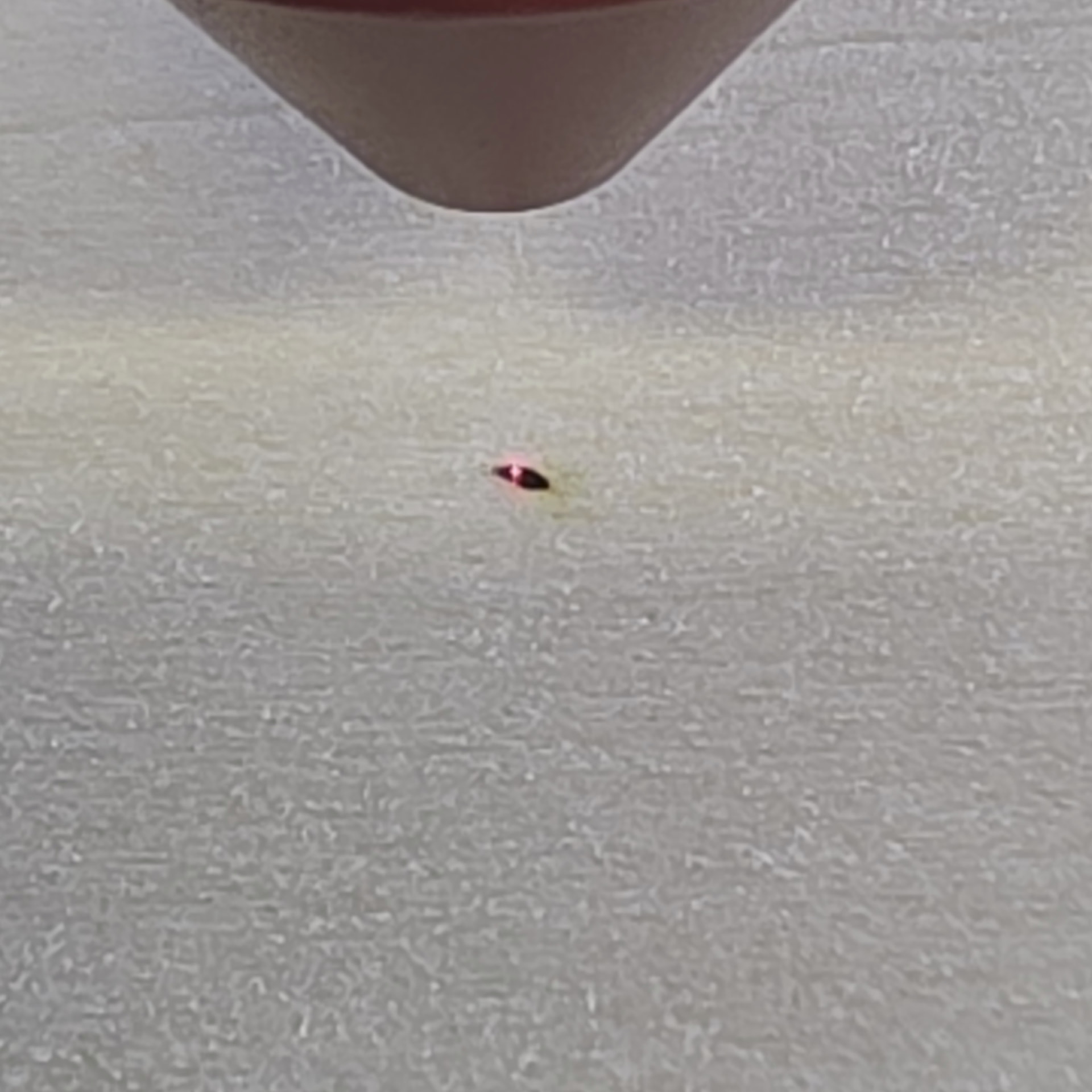

At 10ms 15% power this is a pulsed dot… 3" lens 11mm height FP
Bed Lowered to 45cm dot still pretty good so vertical seems ok…

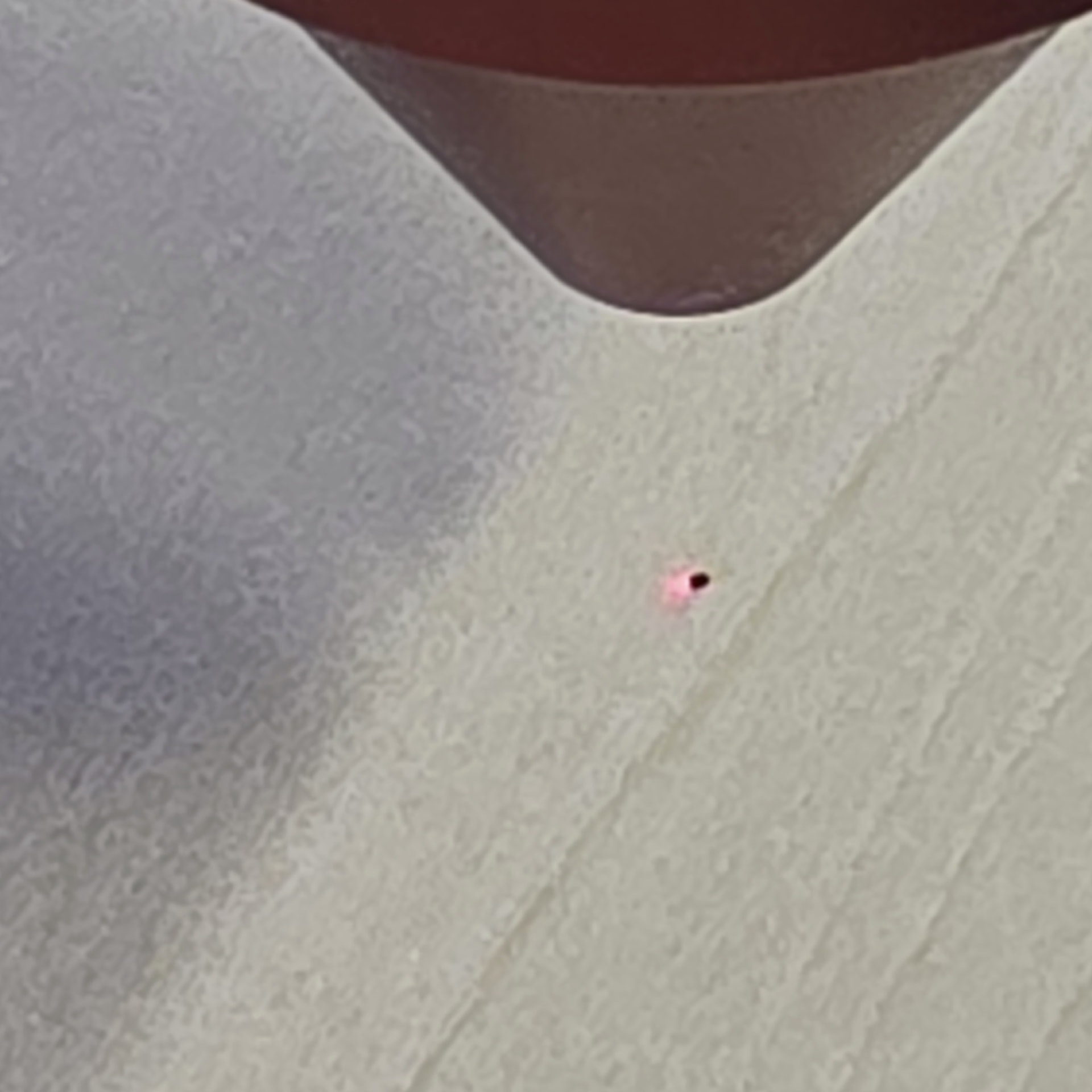

Another thing I noticed… for all the lens experts to chime in on !
At 10ms 50% power this is a pulsed dot… 3" lens 11mm height FP
it seems to be elongated…
that’s all folks
Seems we have gone through similar journeys. That elongation you are seeing is likely the beam hitting the side of the cone on the way out, so there might be more tuning to do.
You are seeing it at 50% because the reflected light is getting enough power to make a burn finally.
