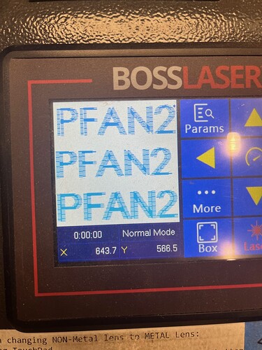

I’ve got a problem I’ve been unable to troubleshoot and hoping ya’ll can help. It is primarily occurring when I’m etching small text (about 1/8" tall). As you can see from the photo, it appears that when the file is sent to my machine, it seems to add a duplicate image, but offsets it very slightly to one side. It etches the letters this way too and the result looks sloppy and not at all like the font I see on my computer screen.
I’m pretty sure there is something simple I am overlooking but can’t seem to isolate it.
I have tried different Speed, Power and Interval settings with no improvement. What am I missing???

My assumption is you’re scanning these, although strange it should show up in the machines preview screen.
I’d initially turn bi-directional scan off and see if that changes it on the machines display.

Thanks Jack - turning off Bi-Directional tightened it up considerably. I increased my speed to 300 and power to 20 to compensate for time and things are looking pretty good now. I guess I just needed someone who’s head wasn’t buried in frustration to see the problem. Much appreciated!!

You machine should work in bi-directional mode, but I usually don’t see it on the machines console.
When you turn off bi-directional scan, it doubles the job time.

After looking at that documentation, I can assert that is exactly what my problem was. Never played with that setting - looks like I’ve got a new side project to dive into! haha
