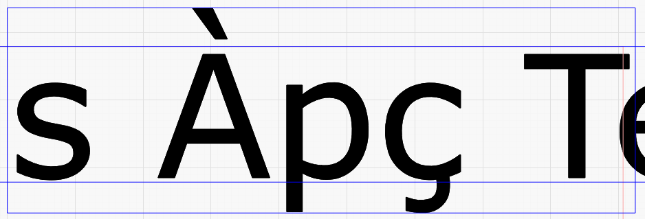

There are several problems when we talk about text height.
Is is the height of a uppercase letter like E? The height between the highest point of a character and the lowest one? The height between two lines?
I did a little test:
The text is Verdana 25, according to the settings. The blue box, of height between highest point (h) and lowest (rounded letters like s or e) is of height 20. The height of the LB letters is 18.2.
But the red box enclosing two lines exactly is 50, ie. twice the defined height…
But as I write this, I realize I forgot about the descenders, and if we go farther, the accents for some languages:
In this screenshot, the blue box has a height of 30.2. Larger than the set size. That’s 24.4 if we forget À and ç…
And that’s just for one font, it might vary with another.
So if you want an exact size, I fear you have to do as you already do: adjust the size setting until you get the right value for your use case, with the help of some enclosing box as shown.
