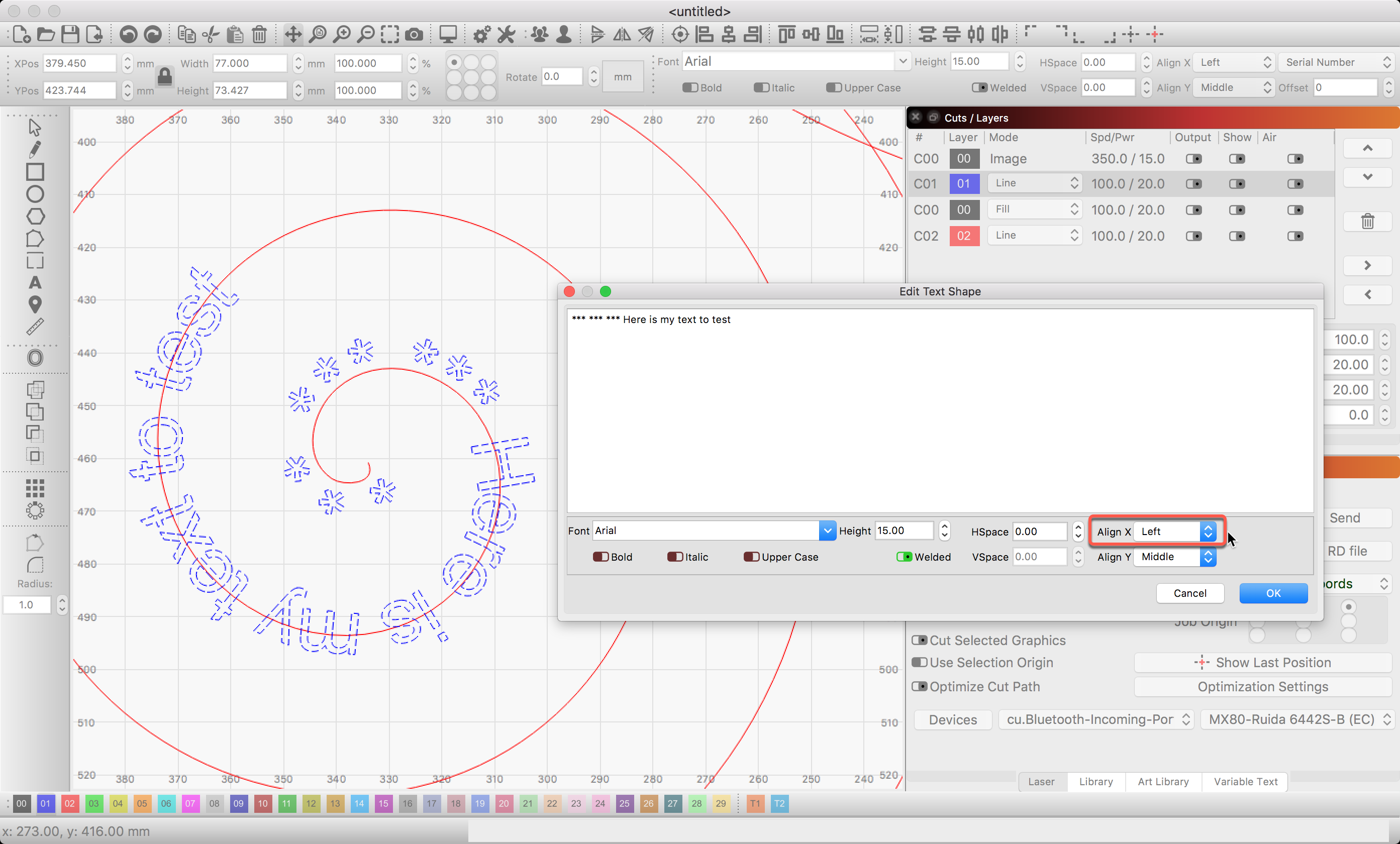

Hello! I’m having a brain fart here or something. Can someone tell me how I can get the text to start from the CENTER and go out to the outer end. Seems no matter what I try it always starts the text on the outer part and circles it inward.
I want “Ever mind…” starting from the center and working its way outward.

Huh. I thought that changing the start point on the spiral would do it, but I just tried and it didn’t.
But mine came out with the text starting from the center. I can’t make it start the other way…
Oh man! Your setup is working like I need! ha ha ha! There has to be a way to make this work.

Check your Alignment settings for the text, as discussed here:
Thanks Rick, but it still does the same thing. Text is set for left. I have the arrow/start point selected. But it shows the wrong way. I even tried putting the arrow/start point on the other side. Same thing.
Let me try this again…
I was able to successfully change the start point on the spiral (move blue arrow at the other end) but the text always attached the same way.
Well, I have some homework for the weekend now. All kidding aside, I am seeing similar, and need to investigate further. :slight_smile:

FWIW, the spiral was copy & pasted out of Inkscape. I don’t know how to make one in Lightburn… (is there a tool for that?)

Continuing to investigate text on path and start point issue, but for now, you might have to re-draw the spiral, starting from the center out.
