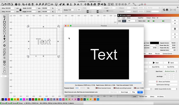

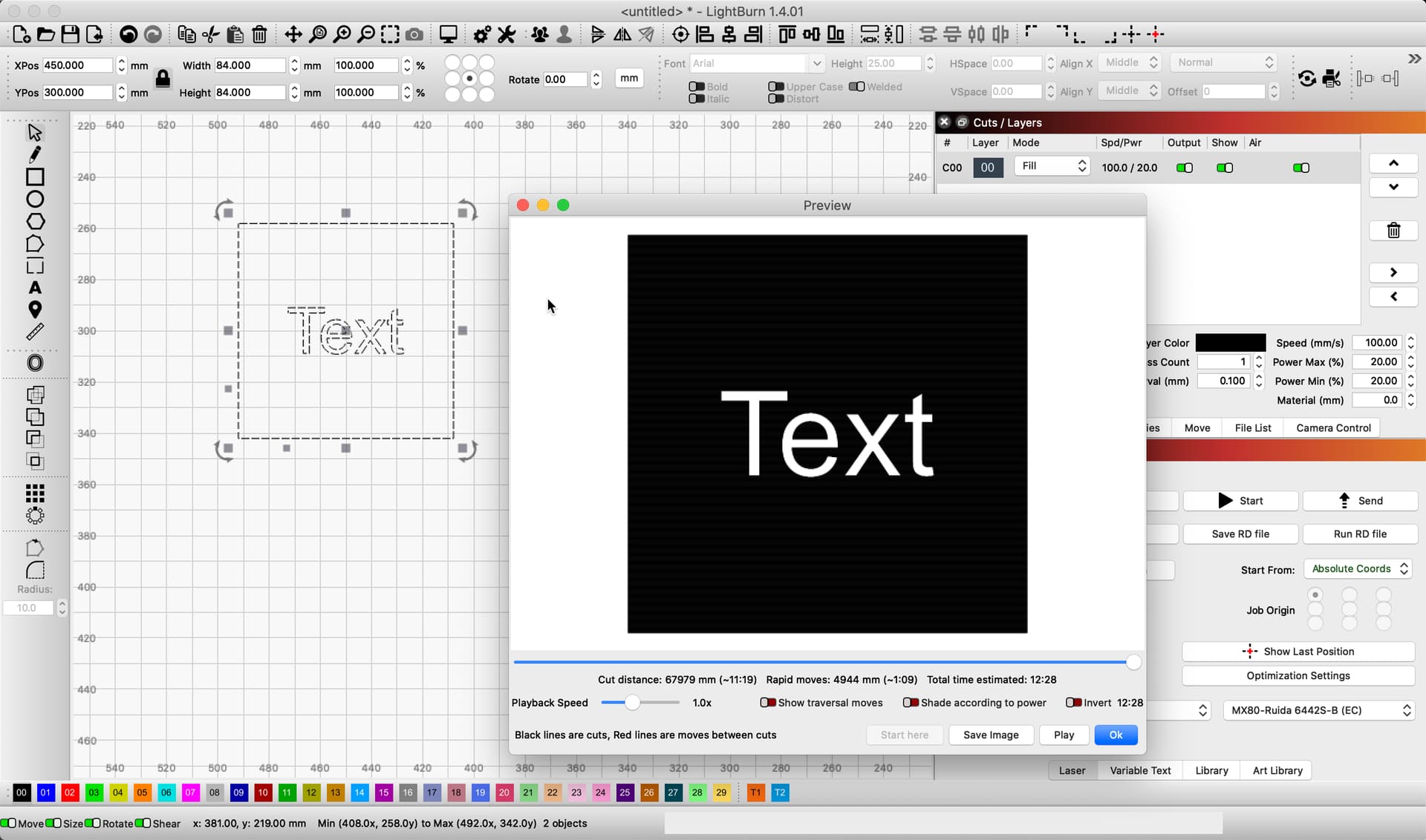

Text print black in preview
text with fill over another fill seem to be white in gui (which is fine ) but in preview it is black = burning, thry have same color fill

It seems only happens to traced images…
Disable “Flood Fill” in Cut Settings->Advanced for that layer and make sure “Fill all shapes at once” or “Fill groups together” with the objects grouped is selected.
thank you - it helped a lot to disable flood fill :slight_smile:
