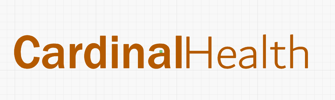

Text set to fill yet it engraves as a line
Using and Omtech laser and LightBurn. I have typed two words to etch on a pen. One word engraves as a line and the other as fill. Both set to fill. Preview shows fill, yet the end result … one line one fill! Help!

Thnk you for your reply. Here are the screen shots.
Lightburn2
Lightburn3

It seems like to me this may not be about the fill working. I suspect fill is working fine. If you look at the “Health” you can actually see some gaps in the “fill” as well. I suspect because the lettering is thinner that it’s just not as obvious.
My hunch is that this is either a scanning offset or something else mechanical.
Can you try burning this to some cardboard or something else that’s very uniform? That should reveal some more about what’s going on.
One other test, can you create a 20x20 mm square, then set your line interval to something like 1 mm and burn that also? This will reveal any potential scanning offset.

Wood is not the ideal material for this test but you can see the issue.
For the lettering note the ghosted edge of the letters.
For the square test, did you increase line interval to 1mm or more? They lines look unusually close. If not, can you rerun the test with a higher line interval?
Based on these results, this is likely one of two things:
  1. backlash in your system. I assume this is on the X axis. Try manually moving the laser head back and forth along the X with the controller turned on. If you feel any lateral movement not associated with stepper movement then that could be causing this. You can test for backlash by creating an outline circle. If the ends of the circle do not close then that’s likely backlash
  2. If you have no backlash then you may need to create some scanning offset adjustments in Edit->Device Settings. You can read up on how this is done here:
    Scanning Offset Adjustment - LightBurn Software Documentation
