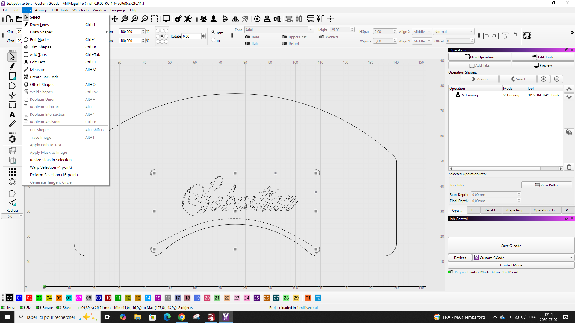

The `apply path to text` function does not work in version 0.9 pro but works in core.

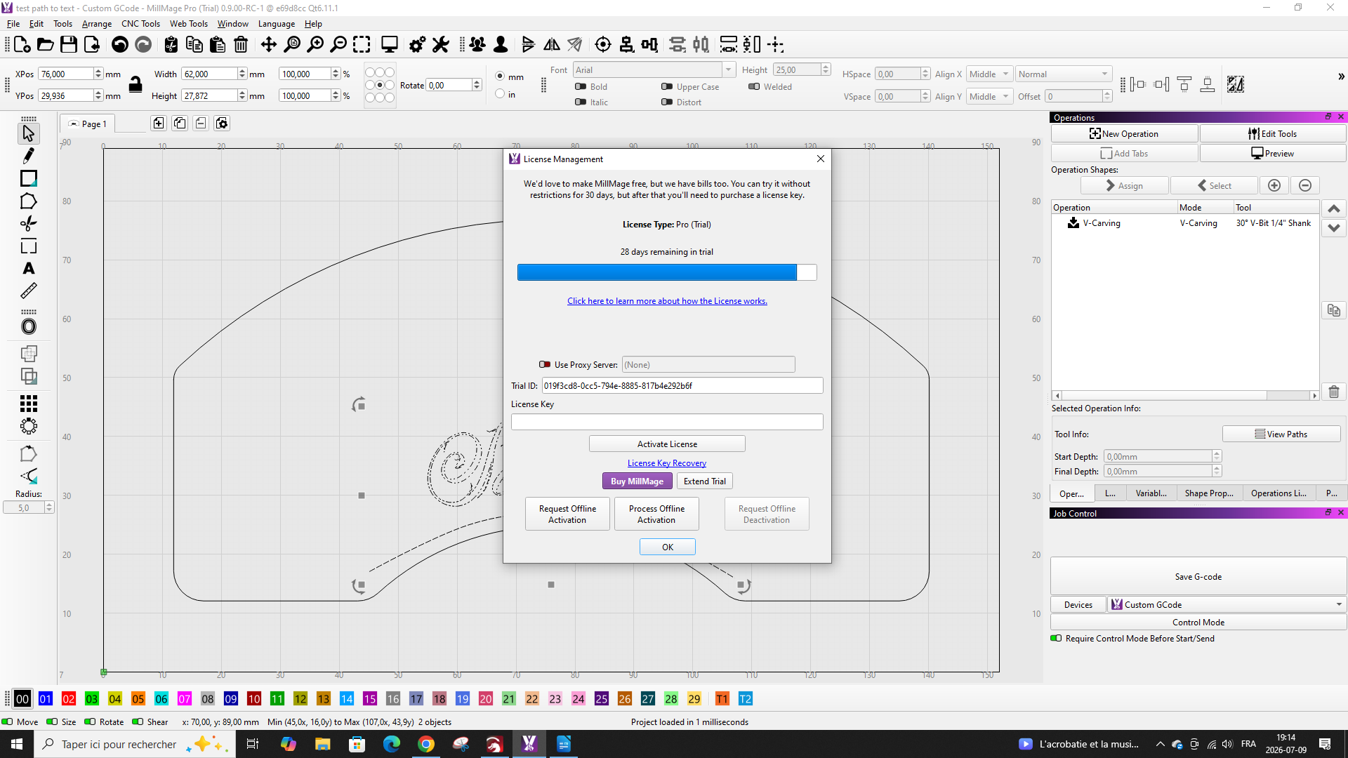

I tried the function in Lightburn and Millmage Core and it works, but not in the pro trial version.

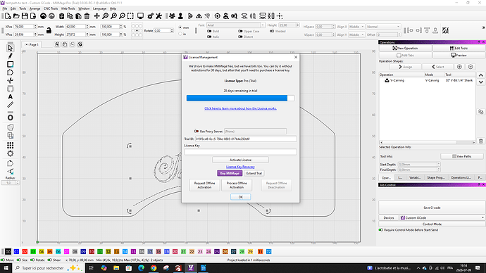

Welcome. I am not seeing the same. Would you please screenshot the ‘License Management’ page in the current MillMage you are running along with a screenshot of the entire MillMage window and post them here. :slight_smile:

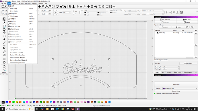

Thank you. I note the text is a group. Apply Text to Path works with a single text object and a single path. Please explain your workflow to produce the text name as a group.

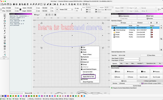

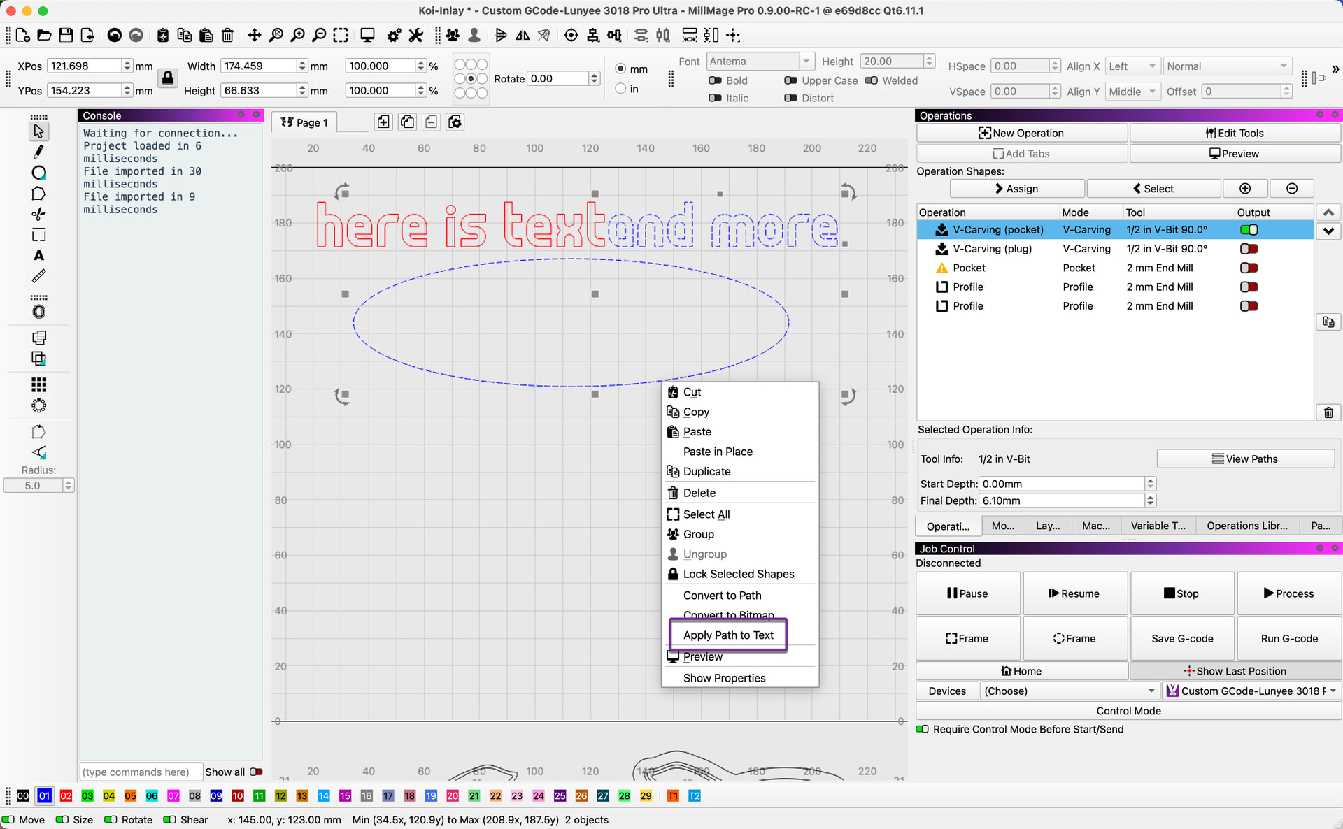

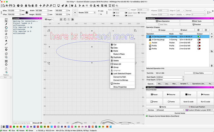

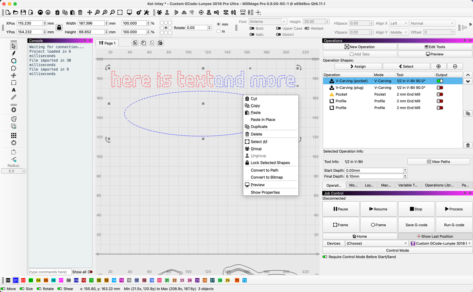

Here I show a path and two individual text objects, one red and another blue. If I select all, there is no option to Apply Text to Path. If, on the other hand, I select only one text object and the path shape, you should see the Apply Text to Path option is available.
Thank you! My mistake was converting the text to a path before making it follow the curve. Sorry about that.
