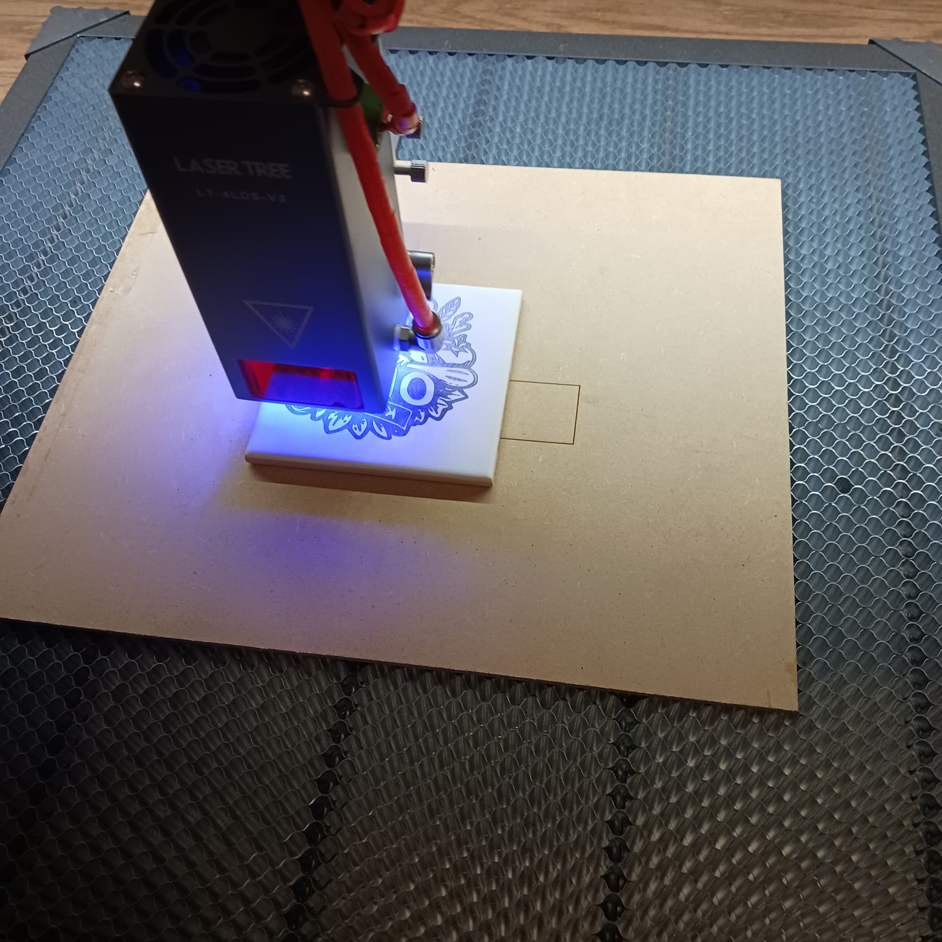

Hello to all, I’m glad to be back after a short leave. The Cherokee Beast made it’s first burn ever last night. I’m happy with the results but it has a couple of problems that I have not figured out how to fix yet. The first problem is that my fire button won’t fire. Yes I made sure that I had the fire button turned on. Because the fire button won’t fire, I had to set travel speed at one mm/m so I could try to focus the the thing. When I tell it to frame, it will frame. When I tell it to start, it starts and works great. The second problem is that it is burning all words are in mirror form. Looking at the screen everything is correct. Wording is not backwards and when I run preview, again everything looks correct. So for right now I am stumped. Any ideas to help would be great. Randy
Check your origin position setting. Front left, back, left, back right, front by right.
I am pretty sure you cannot addjust the focus when the laser is firing. Even at 0.1% on a 10w diode, it is much too bright to see the actual spot. Focus is usually set by a guage, swing down arm, ot by auto-focus.
Does the laser fire when Framing?
Hello Mike, yes all 4 of my lasers has a gauge of some sort, my Cherokee Beast is a 20w. with drop down gauge. Yes I can focus my laser running at 1mm/m. at that slow speed it’s no problem to focus on the move. Keep constant power turned on.
Yes it does fire when framing. it just won’t fire when you click fire! In device settings my “enable laser fire button “ is turned on, my “laser on when framing” is turned on. So I’m stumped here.
What is the % setting in the box next to the Fire button?
I keep my auto home turned off at all times so there is no xy home position. I always use “set origin” and “set finish position” so my settings change with every different project I do. My total working area is Y 850.9 mm and X 711.2 mm. My origin has never had anything to do firing.
set at 2.0 — frame works fine, laser fires

Sorry Mike, What I’m saying is when you turn “Show All” on and then right click you should see the code for the firing button. When I right click nothing happens at all, no window opens up to screen shoot or snip a picture. That’s ok I figured out that my controller is bad. When I hooked up two different Ortur lasers, they both did the same thing as the beast, nothing worked right. I saw the problem after I hooked up the first Ortur and had the same results as the beast. To make sure I hooked up a second Ortur and same results. Then I uninstalled LB and did reinstall, still same problem. That tells me the MKS controller board is bad. So right now I am swapping out my controller board. That should fix it. I’ll give U.D. later. ------
Hello everyone! I’m back with two kinds of good news!!! First of all I learned that I was burning up my own Makerbase Controllers! The first controller started dying out on me, kept going slower and slower and the power to the laser was falling off also. I was running 2208 drivers that started overing heating because I had no air moving across them. So I killed all power waited about 10 minutes, then I swapped out to 2209s, higher amp rating.
As soon as I powered back up, the board smoked! What the heck? Now after a couple of weeks searching, I learned that anytime you need to unplug a driver, you must unplug all the motors before plugging in or unplugging any drivers !!! My problems are cured now. #2 I found a cool little clear acrylic box made for MB controllers and it has a fan that mounts inside the box with about 1/8th in. gap between the bottom of the fan and top of the drivers heat sinks. The fan is to operate from 5 to 12 V. Running on 12V. the fan makes a bad storm seen like a gentle breeze blowing! It took some doing, but I got the controller box mounted in the console. Looks good and works really good. Hot Dang !!!
