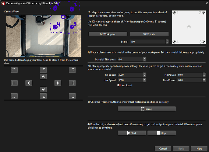

When I press the set button the laser shows that the software its trying to engrave about of bounds. In this image shows that the center of the engraving is set to the corner of the laser engraver so is does matter if i ser the scale to 20% it still out of bounds this printer when it reaches the corner it stops the operation how can i fix this. The laser engraver i have is a wizmaker 2.5w
Did you frame before trying to align?
Is your laser Working Area 135×145 mm?
Try to Scale down or click Fit Workspace..
Thanks i just figure it out it happens that i had the settings for the other 15w laser and the area was wrong
