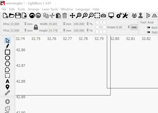

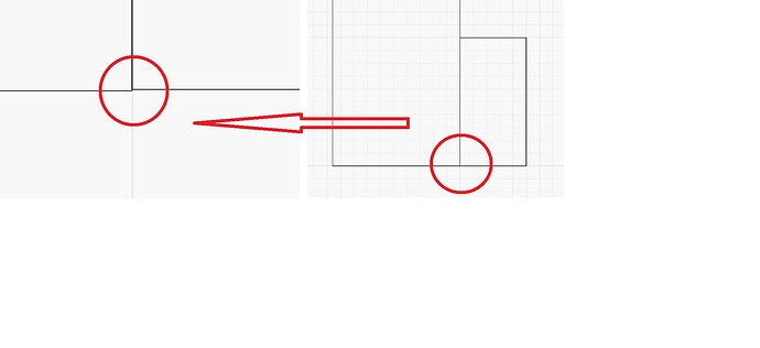

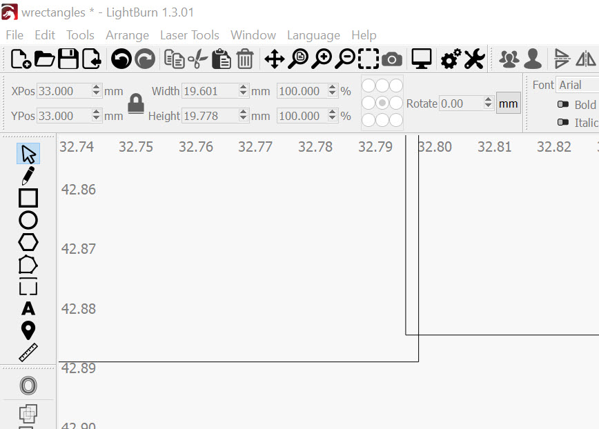

Hi I just noticed that when I made a second wrectangle next to another (corners touching) that the lines (corners) are not allinged on top of each other. I zoomed in (max) and it is not “one corner” (but for a while even the vertical line did not line up).
As shown on the picture:
I also noticed some little errors - like when I zoomed out and then back in, the objects moved further away from each other (like really a bug - I could see it even without max zoom).
But something like that happened maybe 2-3x …so it is not like I can record it or say it happens always :confused:
Also, when I draw NEW two rectangles - they seem totally perfect. It confuses me :confused:
Here are the bad boys -
wrectangles.lbrn2 (3.7 KB)
Do you also see it?

Yes, they are misaligned on both axes.
I believe you want ‘Snap to Object’
