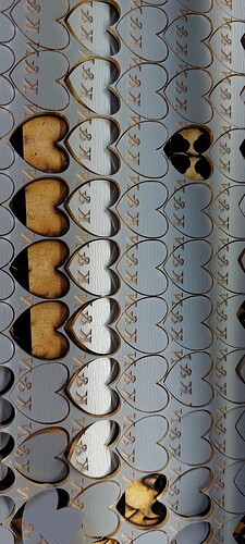

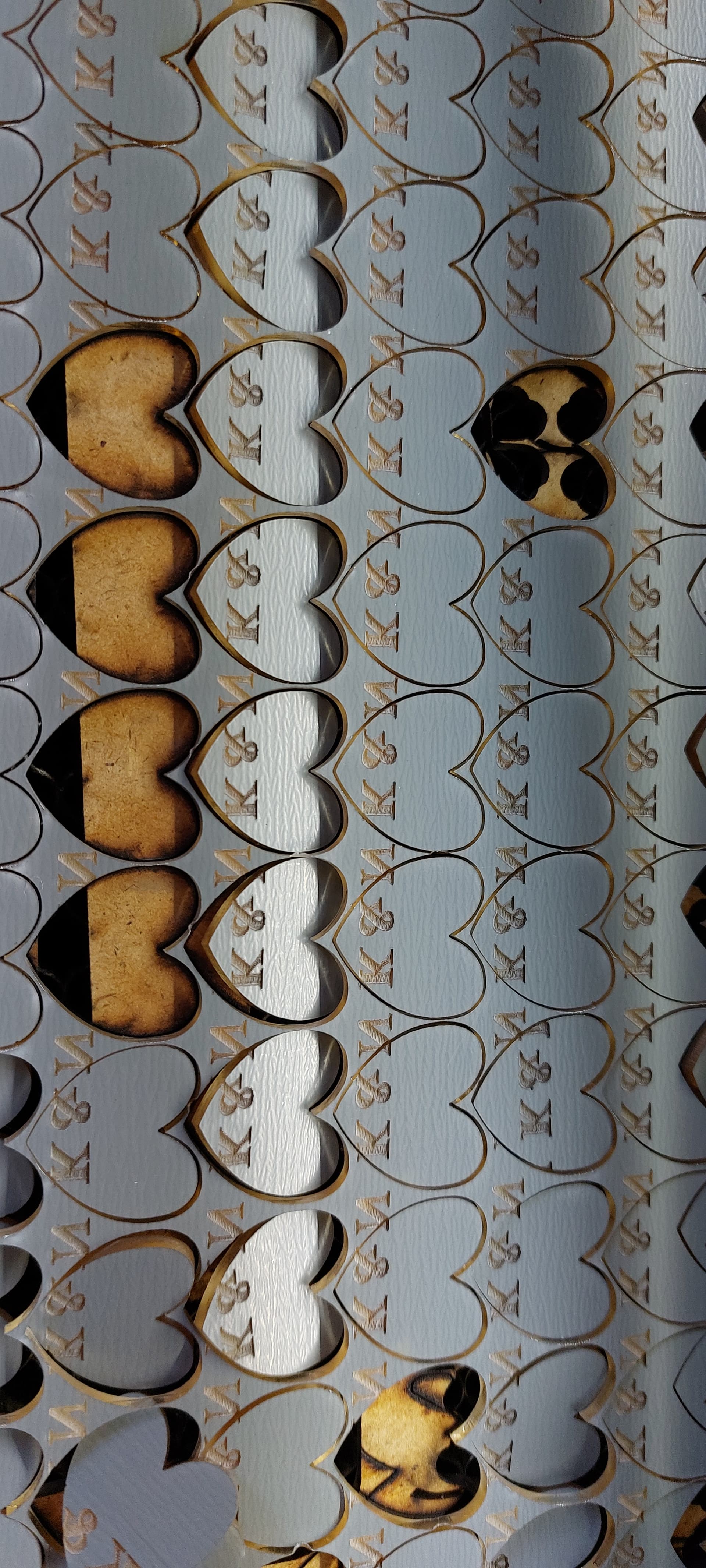

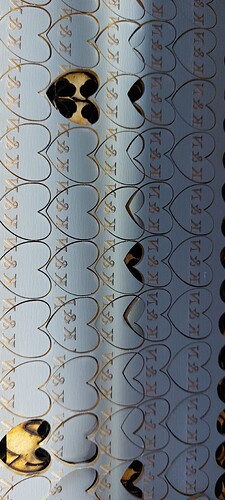

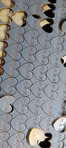

I have problem with laser making a mess since few weeks ago.

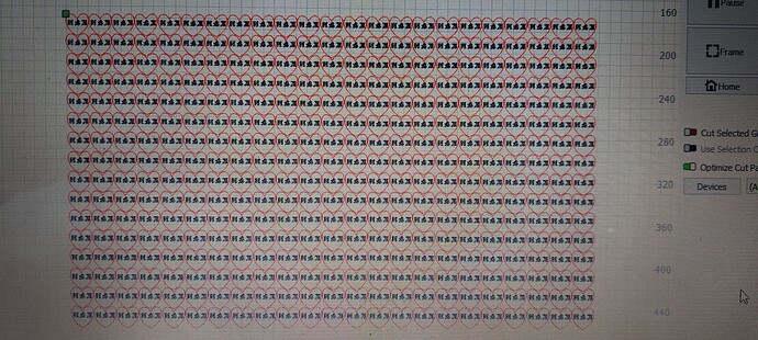

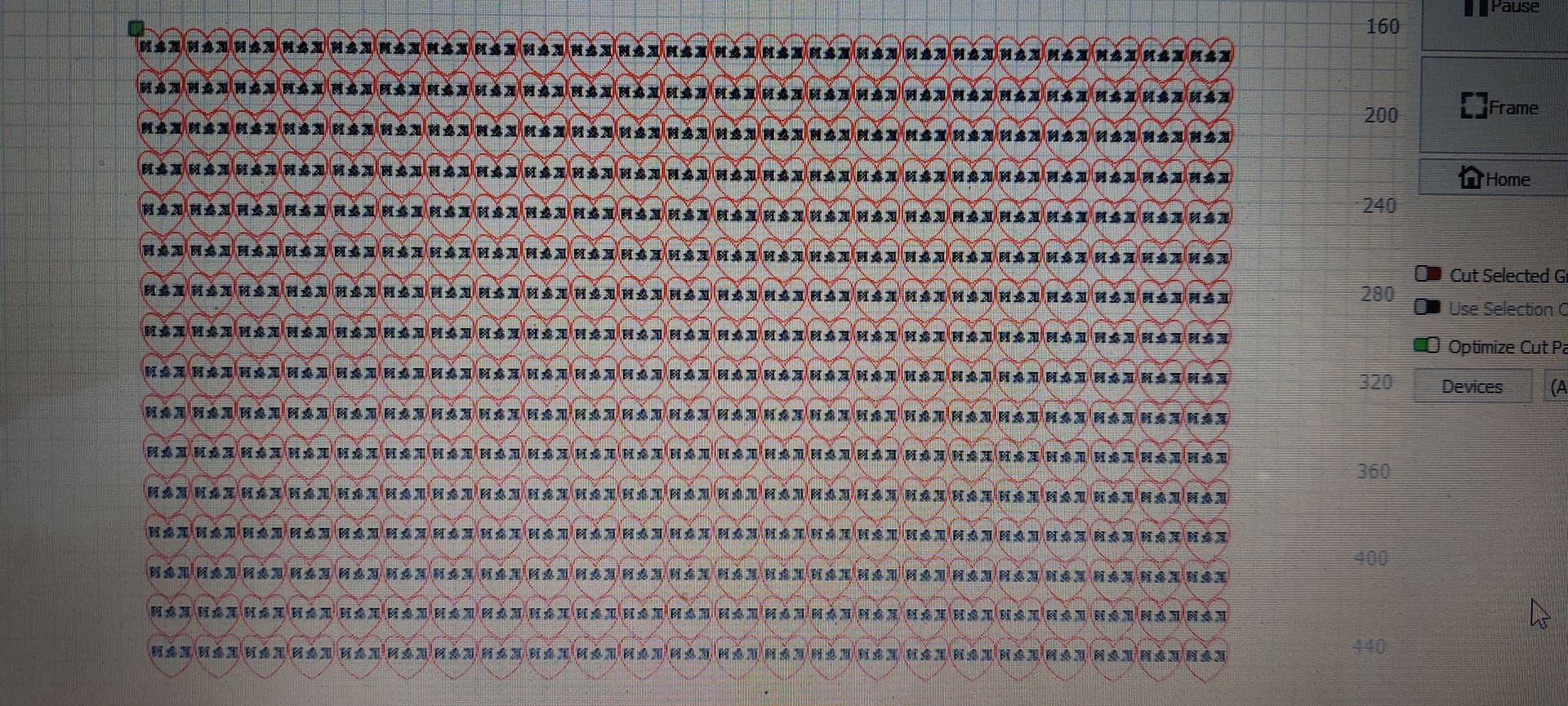

I am using Lightburn latest version 1.7.08
Ruida controller 445S.
It was working well until few weeks ago when started doing this for some reson.

The machine appears to have mechanical problems in the Y axis, most likely a loose setscrew in a motor coupling, probably hidden in the jackshaft across the front or back of the machine.
This test pattern helps identify mechanical problems:
GrundTest.lbrn2
Scale it to fit the platform and run it as fast as it will go in Line mode with optimizations turned off and power set to mark a sheet of cardboard. Any differences from the design will be informative; a photo will let us look over your shoulder.
