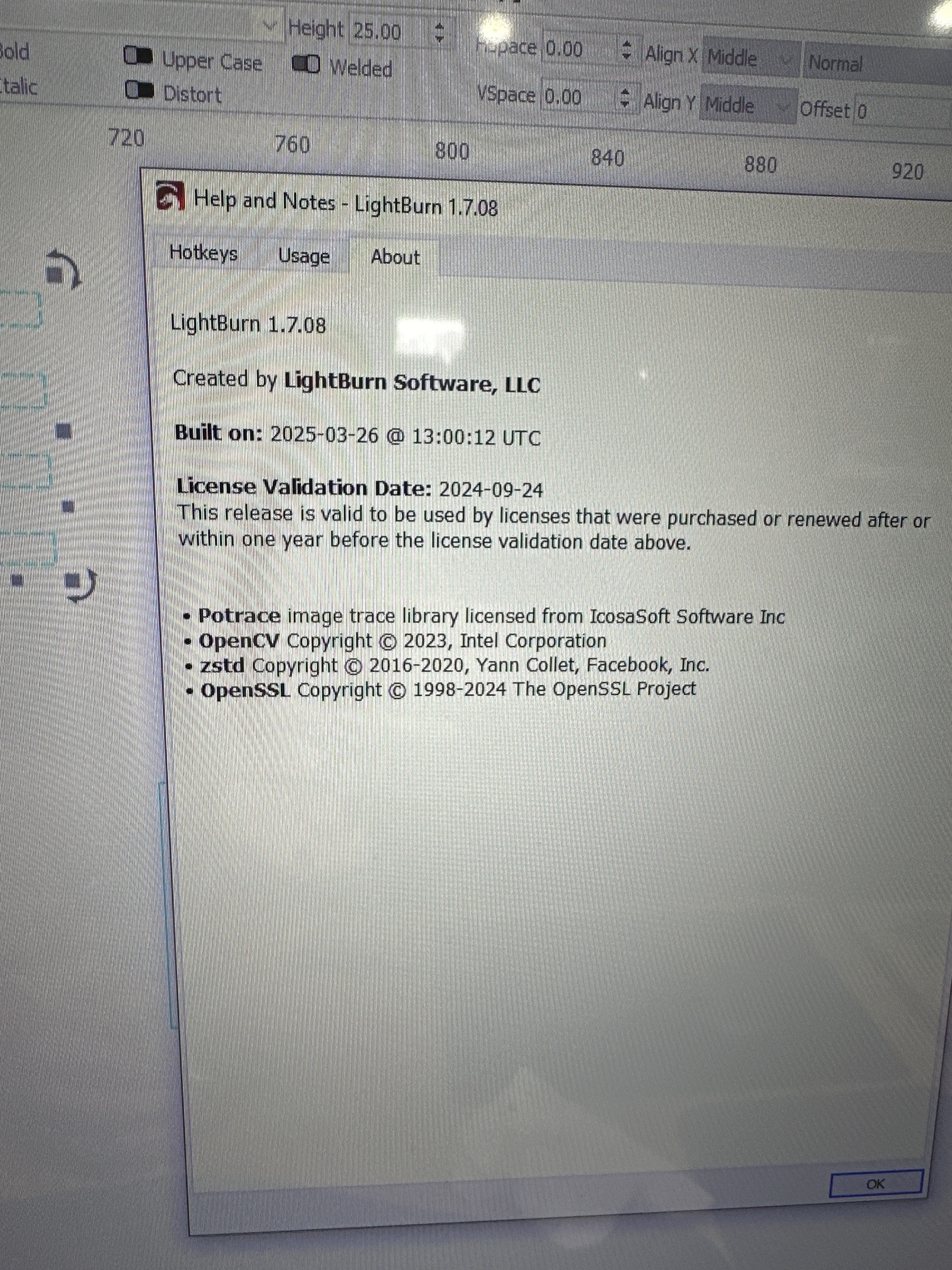

Please confirm the version and OS you are using when you experience this. When you can, please provide a sample file showing this behavior and we can use that for testing further. Thanks for reporting. :slight_smile:
Blockquote
Windows - all versions - but this is my current.
