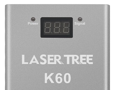

"The power of the Laser Tree K1 Max 60W feels insufficient; it's not reaching 60W."
“Good day, I have a Lasertree K1 Max 60W. Although I have set it to 60 watts, it only ever shows 24 to 28 watts. What am I doing wrong?”

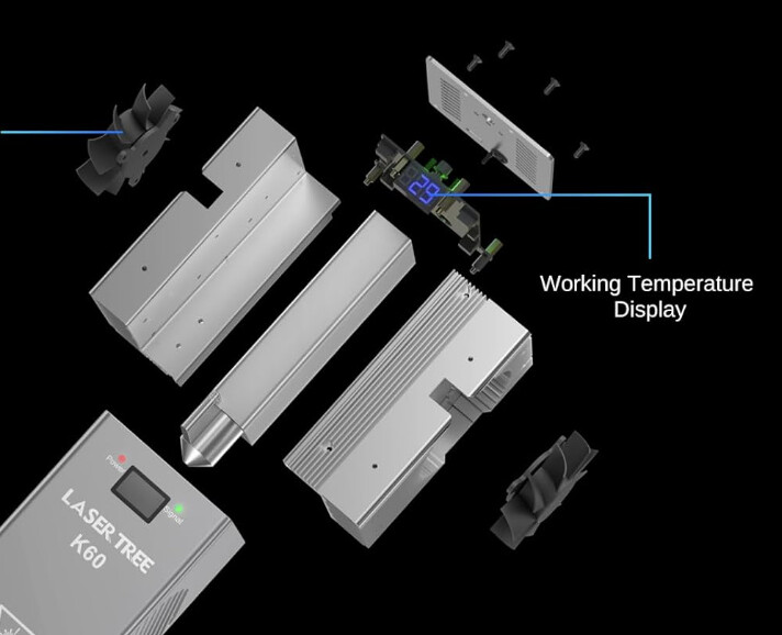

See: https://lasertree.com/products/lasertree-k60-60w-40w-20w-power-switchable-laser-module - I think you are looking at a temperature (celcius) reading, not a wattage reading:

They aren’t very clear about what’s displayed. Some of the documentation states it could be displaying signal, whatever that is or power. – I don’t know what it’s really displaying or how to change it..
Celsius argument sounds good, do you have one of these?

Ja, danke das war mein Problem.
Ja, danke das war mein Problem. Es ist dank euerer Hilfe gelöst.
