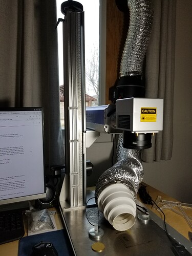

I ordered mine for a 300x300mm coverage area (requiring an F420mm lens) but it also requires a tall column. This is necessary if you’re going to put something like a rotary with a large object on it… My column is 800mm (80cm).
In this photo, it’s got an F254mm lens mounted.
