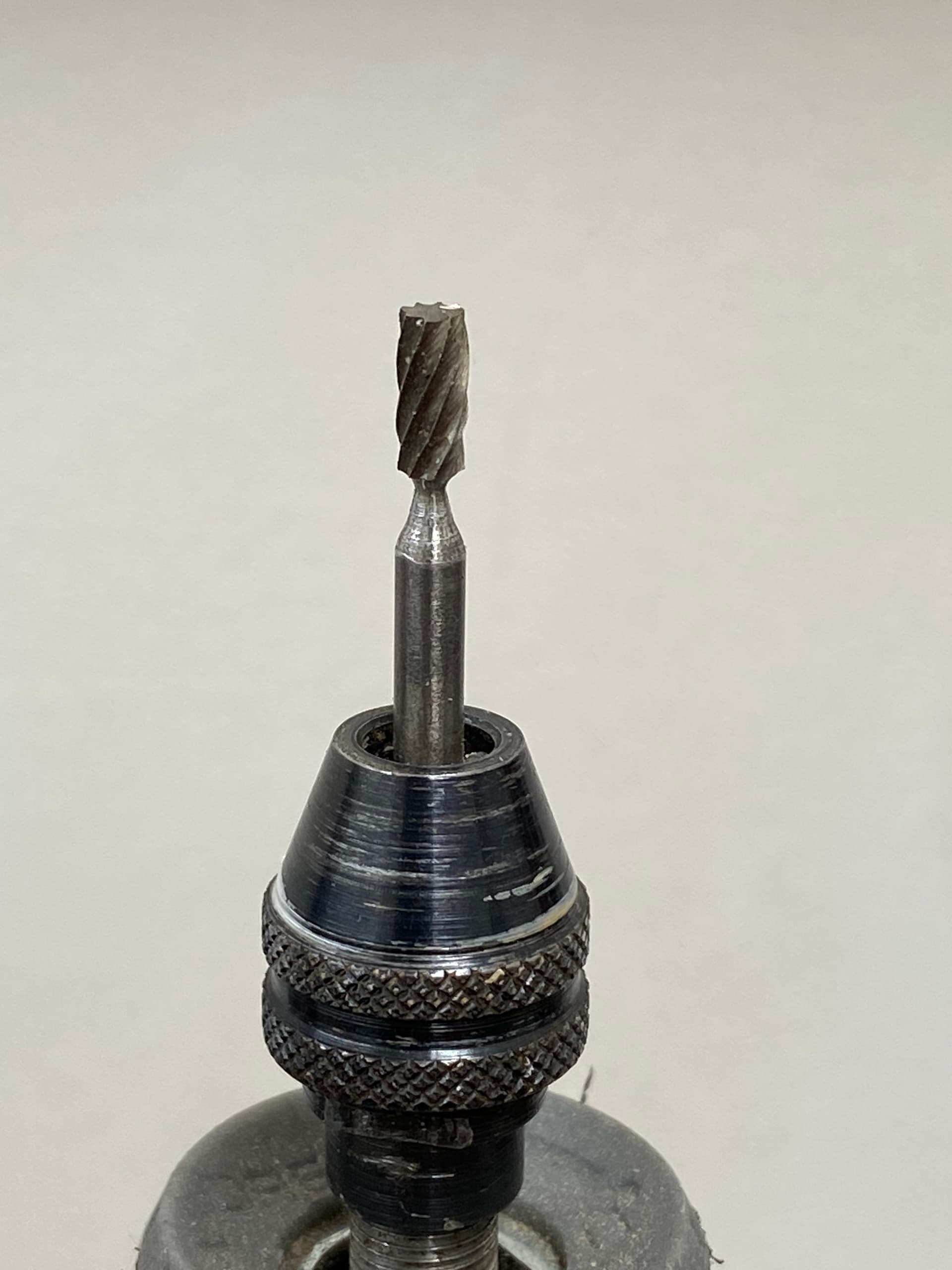

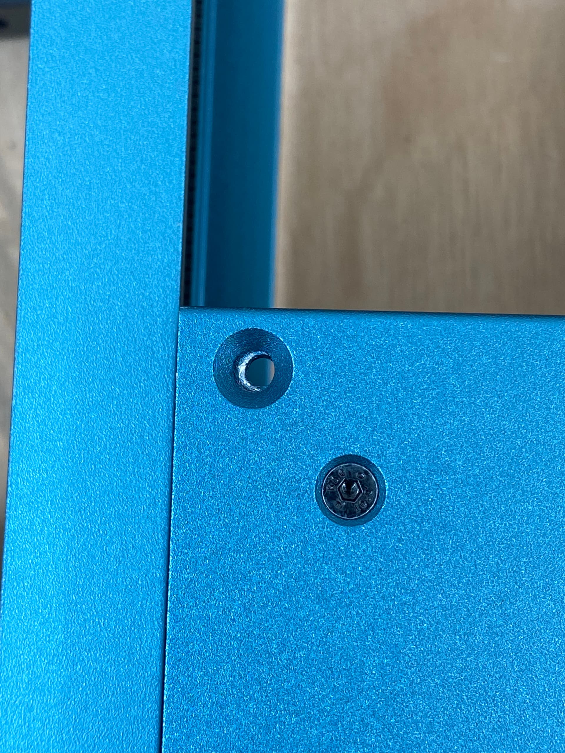

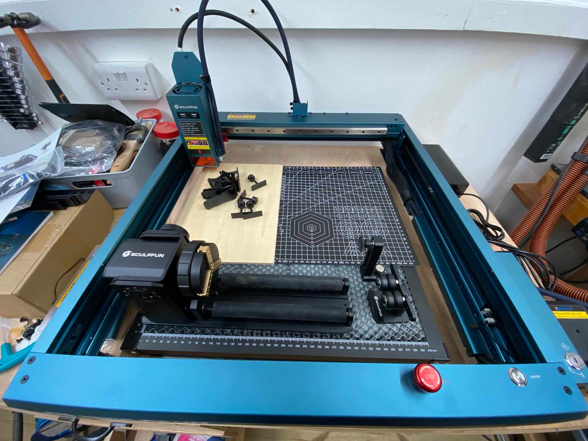

The new Sculpfun SF-A9 40W machine arrived today. I spent a short time (40 minutes) completing the assembly. My first impression was that Manufacturers in China have upped their game quite a bit since I first purchased my original series one Snapmaker. The fit and the finish have improved considerably and mostly… the assembly went without a hitch. On of the screw holes on the X axis would not let the screw enter the screw hole because it was displaced by about 1mm (see image). Four countersunk screws are required, arranged in pairs at each end of the X axis, to fix the X axis rigidly to the carriage of the Y rails. I used a Dremel tool with a small parallel-sided carbide burr to enlarge the countersunk hole by removing 0.7mm on one side.

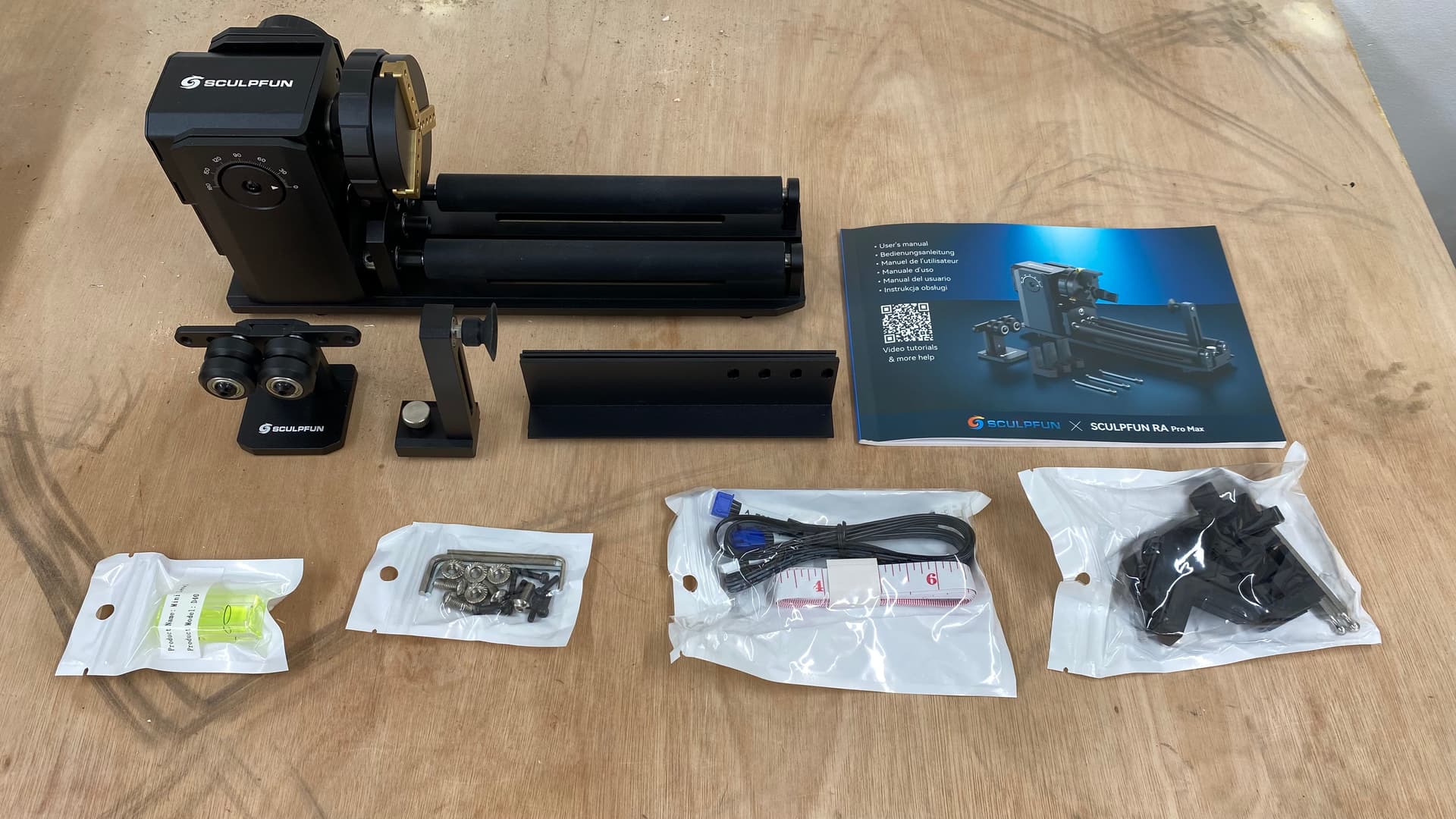

As well as the laser machine, I received a 2W 1064nm infrared head. I also received a RA4 Pro Max 4 in 1 rotary attachment and a Sculpfun 400 x 400mm honeycomb. The honeycomb came with some additional clips and briquets as well as another aluminium base and an A3 cutting mat. The only niggle I had with this was the double-sided sticky pads for the feet of the honeycomb were easy to take off the packaging but it proved difficult to separate the double-sided protector from the very sticky pads.
I will set it up for use tomorrow. All in all, the equipment looks to be well designed and well made.

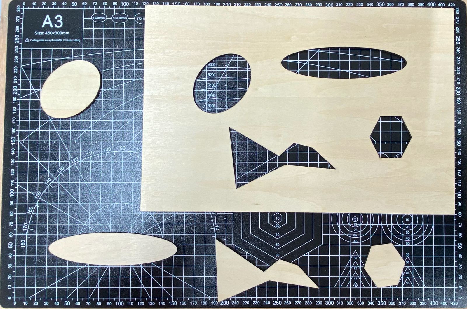

I managed to cut the plywood sample succesfully yesterday… today no dice.
