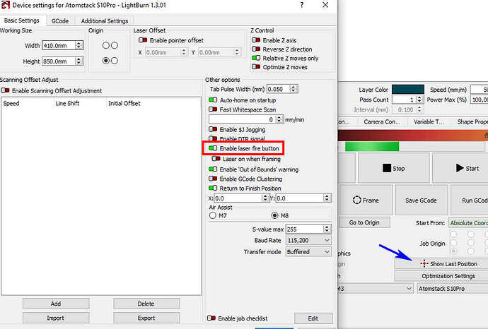

I have Atomstack S10 Pro and when I press the Show laser position button, the laser should light up, is that correct? Before that I enabled from settings “enable laser fire button”. This function does not work for me. Am I doing anything wrong?

No. This is not how the feature works.
When you have that option enabled, you will get a crosshair in LightBurn’s workspace of the last reported position from the laser.
If you want to turn on the laser light you would go into Move window, and push the Fire button. You can change power level there accordingly to get the intensity of light that you need.
