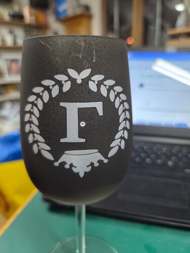

The Wine glass is up/side/down

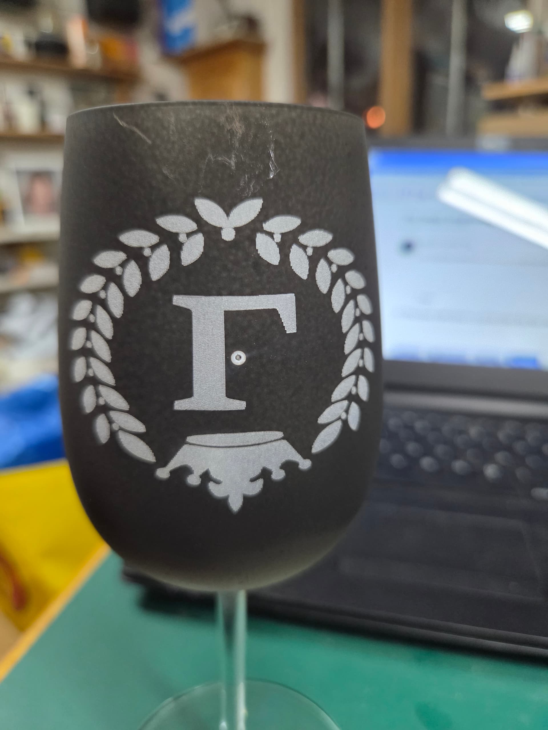

Can anybody explain why the picture engraves up side down on the wineglas
You have the wine glass upside down in the roller…
no i dont. I have done lots of engraving
the same way without any of this problem
That is not apparent from your post. Excuse me for not knowing your history. I am too simple most times. If upside down, flip it. Problem solved for me.

Either turn the rotary base 180deg or check your Origin button in the Device Settings window.

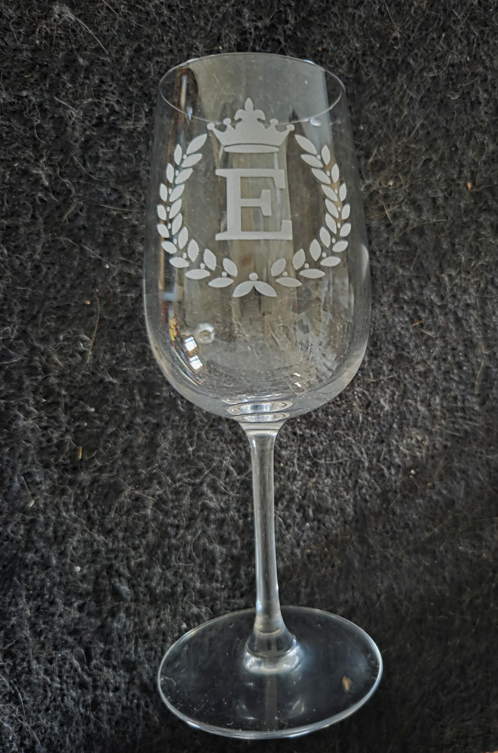

the picture showd how i use to get it.
But now it´s burn up side down
I don´t know how to fix it.
PLEASE PLEASE… help me

Flip image 180 degrees. Then burn.
