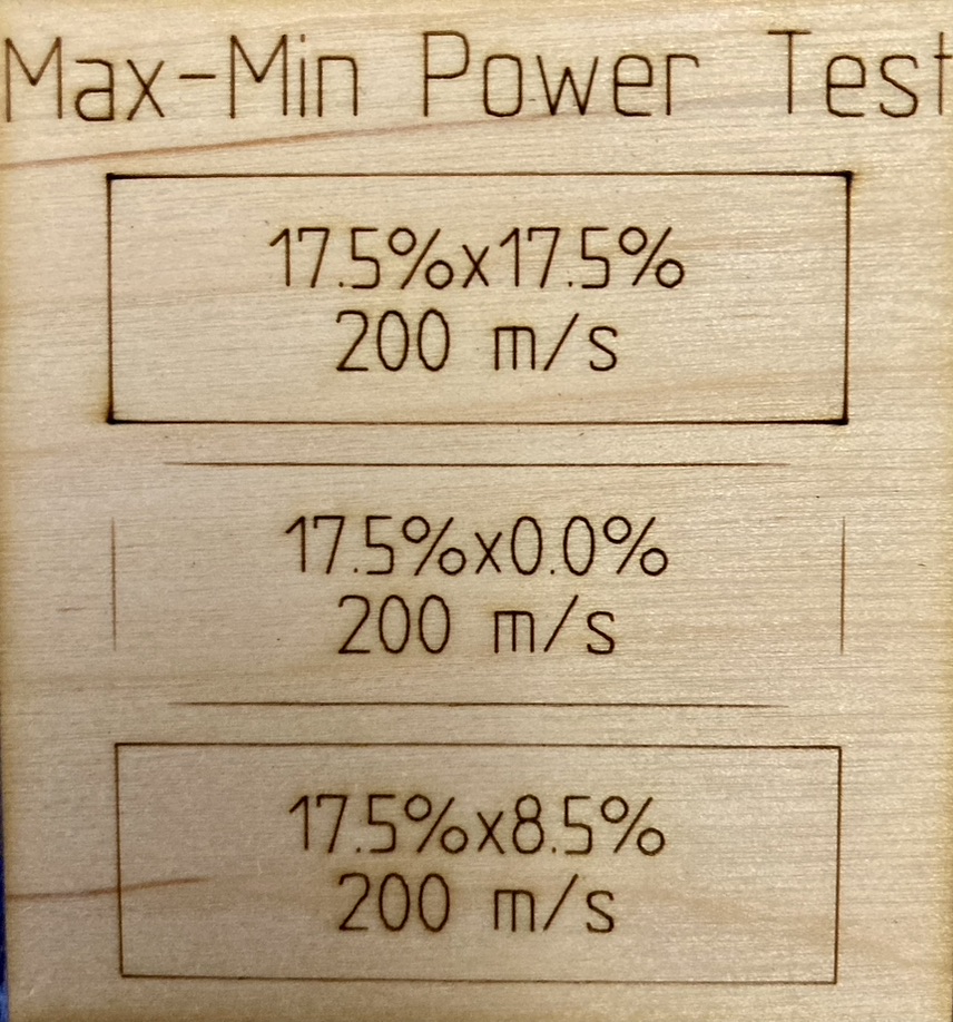

There's a small gap between the vertical and horizontal lines
The lines of the rectangle don’t meet. There’s a small gap between the vertical and horizontal lines. Neither the drawing nor the Preview shows this gap in LB. I have read about tabs/bridges but they are not enabled

Sorry just noticed you’re using a CO2.
Check the docs:
I’m gonna see your file now.
It’s a bit simplified but it captures well what I think could be wrong in your case.
(in the first line it is max and min power in LB %, which fits my controller)
