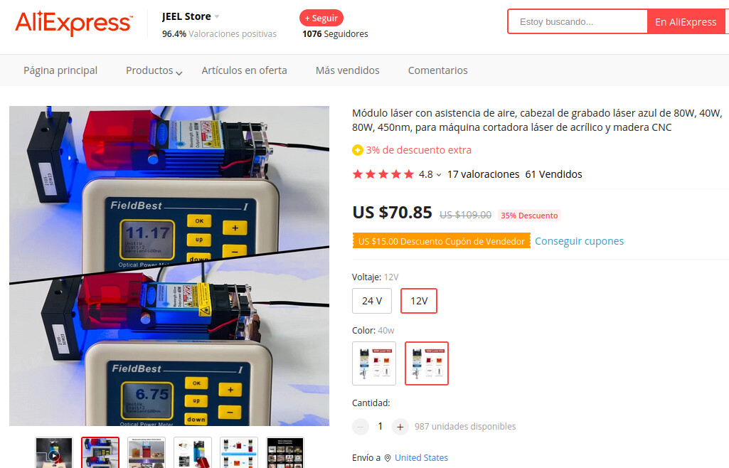

Thinking of getting a replacement laser module
Any one heard of the brand or have any input into the laser module from AliExpress.
80W Laser Module with Air Assist

It’s input is 80W with an 11W output… these are generally input wattage whereas the co2 are output wattage.

Also be sure to match your input voltage (12v or 24v). A mismatch can end badly.
I have no idea… there are so many of these things out there…
If it’s a 12V laser module the current draw will be twice that of a 24V model. 80W / 12V is about 6.66A at 24V it’s half that.
If you expect to power the laser from the machines control board you need to know what voltages/current you can safely draw off the board.
You can run 10A though AWG16 gauge wire if it’s less than about 5 feet.
Don’t need to worry about the ttl/pwm signal, they all seem to have compatible inputs…
Make sense?
You don’t need a very thick wire. Those numbers are advertisement numbers, usually. Take the Sculpfun S9. It’s (sometimes) advertised as a 90W laser (usually they say “CO2 equivalent”). The optical output power is 5W. In general, the power a diode module draws is about twice or maximum three times the optical power. So, the S9 5W module takes about 10-15W electrical power. Actually, the whole S9 laser running at full speed and full laser power is using 36W (I measured myself). The 20W S30 Pro Max Sculpfun laser uses 95W electrical power when running all motors, air assist pump and laser module at full power (also measured).

Using the link provided (I don’t speak the sites language) and this being only the laser module, is that the efficiency of these modules for 80W and the 40W, is 13% and 16% of input, respectively.
I’ve usually seen a conversion of < 20% maximum of the modules input power actually comes out…
Compared to the 20 to 30% that @misken specified… they are getting better…
