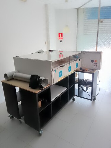

I would like to know if this controller in the picture attached is compatible with lightburn?
Anybody know what controller is that?
Cheers
That looks like a DSP controller. It’s a lot more complex than a GCode controller and requires a technical upgrade in LightBurn to connect and work.
The controller could be on the back of that screen, or in a box mounted in the service panel on the right-hand side of that control panel (or HMI).
A picture of the control box inside the service panel (including the model number) would help us confirm which controller it is (before you upgrade). ![]()
If you have your license key handy, and if you still have Free Trial days remaining on your Device, you should be able to deactivate your license, return to the Free Trial mode and test this hardware.
The Free Trial is a full version with access to all hardware modes, including DSP and Galvo.

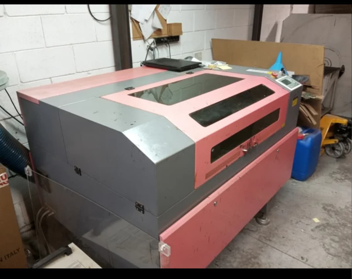

I want to buy this machine but the owner doesn’t know much about it, he invited me to go and see it in person but it’s 400km drive from where I live.
I have Grbl licence and I used all the free trial period.
Do you know more or less by looking at the type of screen if this controller is a very old model?
I’m not familiar with that controller personally - have the owner look for a serial number from the inside electrical panel or under the display. Or, have them load up LightBurn and try to connect to the machine.
Yes that’s a good idea if he can test it with lightburn, but the man is old and recovering from a surgery, this is the machine I don’t know if that help in knowing what model it is
Does the current owner remember the name of the software used to drive this machine by chance?
That very much looks like a panel for a Leetro MPC6565:
So not compatible with LightBurn at this time.
He doesn’t remember the name of the software but he told he will go to his shop next week to check it
That’s the one, thanks for your help
The software is lasercut
Is it possible engraving fotos with this software ? Do you guys have plans to make this controller compatible?
