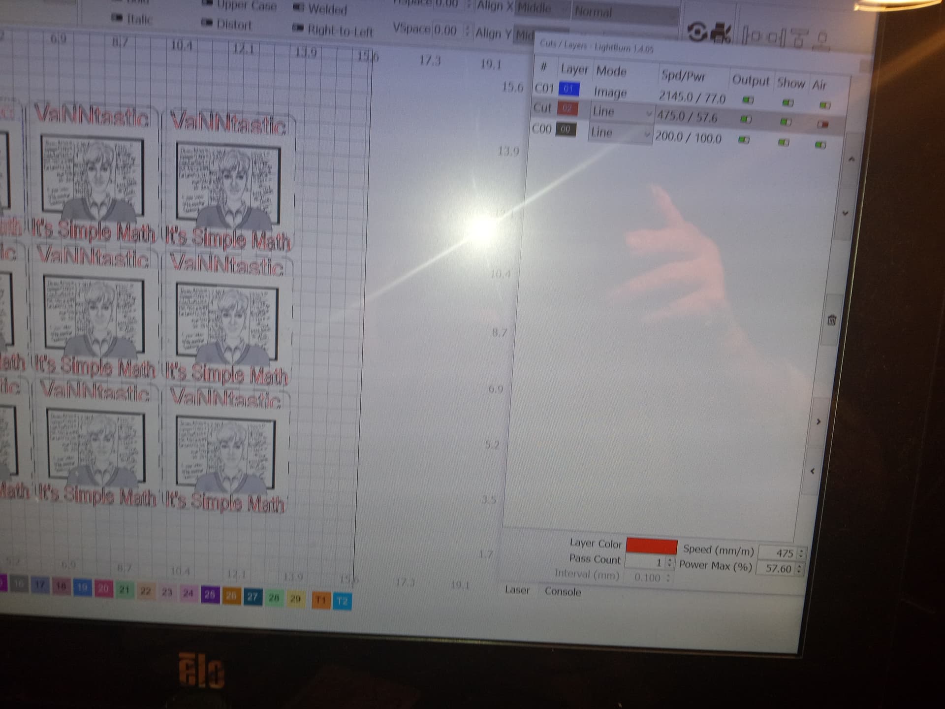

I have a three layer project. I set everything up and I have the cut last. It preforms the cut first. I thought it was supposed to go in order from top to bottom.
Second problem I have is one layer doesn’t burn, the power is too low. I turn off the engraver, wait a minute and turn it back on. I go into the cuts and layers and turn off the layers that actually worked and the layer that didn’t work is now working. I can’t do the whole process without doing the above. Can anyone help me with this issues? Thanks

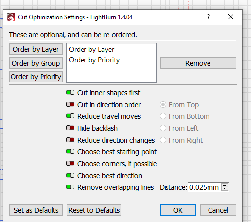

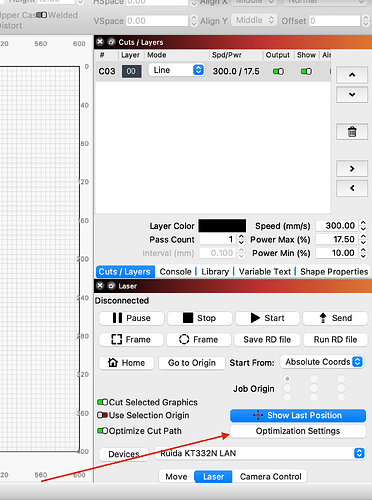

Go to laser window cut optimization. Order by layer should fix first problem.
Second maybe screen shot of cuts and layer window open.
I’m sorry but I can’t find laser cut optimization

What layer doesn’t burn?
Maybe upload file.
I don’t understand the problem.
If your last (cut) layer doesn’t manage it with a single pass, you can’t set this layer for 2-3 pass? - Do you have to wait/cool the laser?
I found the optimization button. It was Grayed out so I didn’t notice it. I messed around with it and I was able to open it and click on the appropriate option. It should work now. Thanks
My second issue,
Is there a laser cool down option I can select? But why would it drop to a lower power level and not indicate it?
Not as I know. But you can make a fake layer with null power and x number of passes.
Now that I have the order set to burn layers from top to bottom I probably won’t have that problem anymore.

The cut layer was always set last but I didn’t know I had to go to the cut setting and select the order of layers. Now it’s set for last. I thought Made that clear above.
