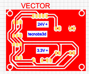

Separate layers from PCB.
Those are the 3 files as an example, these are TIFF and I want all 3 to be in Cuts/Layer either as images or vektors
I believe this is what you’re looking for. The problem I see is Acrobat doesn’t save the layer information when you convert it, or Lightburn can’t read it. Either way, I had to export each layer individually and imported to Lightburn. The next issue is, tiff is an image format, not a vector. Lightburn only supports dithered images and therefore cannot be used to cut.
Here is how the 3 files imported and I assigned each layer to it’s own color.
This is the preview image with the 3 layers stacked and on different layers.
This is the 3 layers after doing an image trace to vectorize them. The quality is severely lacking.
The best method in my opinion would be to save the PCB as either SVG or DXFand use one of those formats to import to Lightburn.
