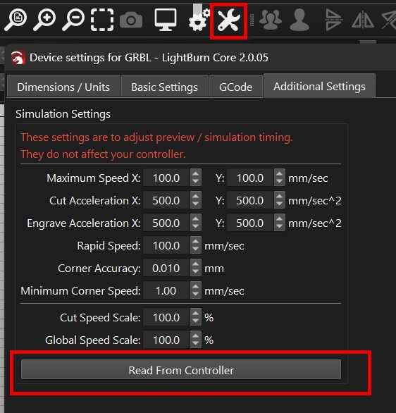

All I did was click on [Read From Controller]
When I read from the controller, it showed me that some of my settings on the laser had changed from the default. I spoke with the manufacturer and they confirmed the error. The error was the max speed. It’s corrected now and I’m going to have to re-run my material tests. My times are still questionable. I made some time tests with basic shapes and they look favorable. Further testing is needed because some settings are not making sense to me.

Read the red text in the image above
These setting are to adjust preview / simulation timing.
They do not affect your controller.
You are correct that it is only reading the controller. However you can go into your console and change the values if you know a value is incorrect. I saw my max speeds were wrong (6000mm/min instead of 36000mm/min). They were somehow set to 1/6 of the correct max speed for my machine. This number was verified by the manufacturer. Because of this error, when I told it to run at speeds higher than 6000mm/min it topped out at 6000. Fixing the max speed settings allows the laser to run at a higher speed. That’s why I need to re-run my material tests for engraving. They never ran at the higher speeds. I was burning things at low power because it was running too slow. It’s a 48W diode so it’s easy to start a fire. I did start a fire and this may be why.

The data read from the controller said 100mm/sec and the numerical value written in the controller was 6000, which is the speed in mm/min. I noticed that when I went to change the settings in the console. Once I corrected it in the console (set it to 36000) it read correctly as 600mm/sec when I re-read the controller data.

With GCode machines, the Cut Speed% basically affects all the G1 cutting and engraving (any burning moves) in vector and image engraving. The Global Speed% scales the speed on all moves burning or not so it includes non-burning moves within an image (and will be a multiplier of Cut Speed% moves you have already scaled), so it’s probably best to only use the Global Speed% (if needed) to keep it simple.
If the maximum speeds and accelerations are set correctly at the machine and read into the Simulation Settings, speed scaling should not be needed.
If you are dong a lot of image engraving, make sure the ‘Engrave Acceleration X’ value is correct to what your machine is using ($120 setting) to get an accurate estimation:
